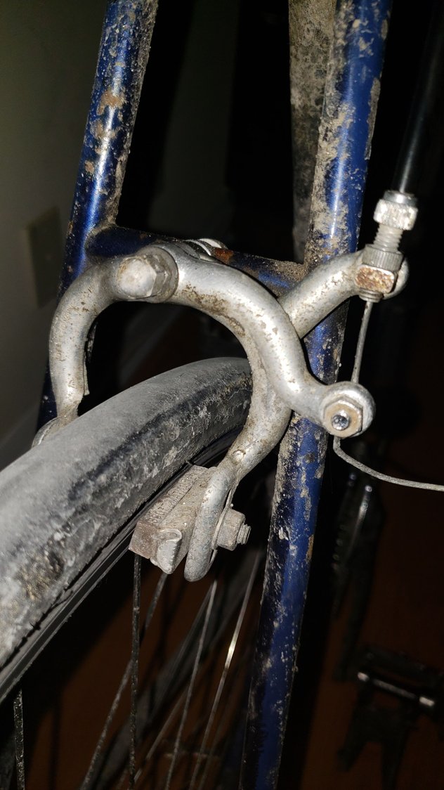

Need pics of the front at least. I mean,
Any ideas identifying what sort of model it is?

It would be helpful to see a pic of the brakes on the bike. These may have a longer reach than the dia compe 500g brakes which were once very common. They showed up on a ton of old Treks for example. You can make pretty much any old brake work reasonably well with a few tweaks. New cables and housing are a big help. So are quality brake pads. Kool stops are very good; dia compe grey matter are good as well.
Excuse the filth. What do u think?
Originally Posted by Gresp15C View Post
I believe the Dia Compe brakes that had no additional markings were just their basic model. Some of mine are "Schwinn Approved" which are unmarked and of unknown age. I have one on my single speed bike, it works just fine. I also have a "G" in my bin, doesn't seem to be materially different, but the aluminum seems to be more brightly polished. I did notice that there's a washer between the brake arms on both brakes, but mine are so old that I can't vouch for them having the original or correct parts any more. Some mixing and matching of parts may have occurred! On one brake the washer is thin metal, on another, nylon. I can see daylight between the brake arms on all of the sidepulls in my fleet.
Stamped 1080 on inside of caliper.
Washers are supposed to be there. I saw ones on the inside/outside of each arm, as well as two more between the outer nut.
Yep, any current Shimano or Tektro dual pivot will provide a better experience.
I guess some people love mediocrity. You might have had the wrong levers on your old GT. But flexy brakes when you need to stop are not good. That feeling you could be getting from those brakes is not ideal. There are much better brakes that will still give you a good feel.
I went out for another ride today, this time with just the rear brake installed.
They work pretty bad. Its especially apparent now that thre is quite a lot of flex.
Some newer sidepulls could be a good upgrade, But not necessary as long as I don't over speed.
Moisture is offline

I'd describe those as brake shaped objects and whomever you are paying to maintain your bike is beyond useless.

I'd describe those as brake shaped objects and whomever you are paying to maintain your bike as beyond useless.
What makes you say that?
Luckily, I haven't had to spend anything for maintenance and practically nothing for parts either. I use either my friends shop or the local bikehub. I've done majority of work myself.
My guess they are 810's. Flip them over and on the back will be the model and the year they were made.
I find the old Japanese Dia Compe brakes flex a lot less then the new ones made in Taiwan. You get 100x more breaking power when they are "Toe-In" properly I'm sure there are places you can google that show you how.

Yeah I think these are 810s. Post 14 pretty much nailed it in terms of what you can do to get a better braking experience. Also clean them up. There is a certain amount of hate here for old gear. Take it with a grain of salt. Some things have gotten better but that doesn't mean you can't have a well functioning bike with old parts including these brakes.
