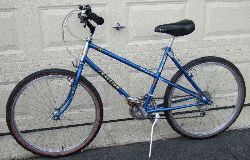

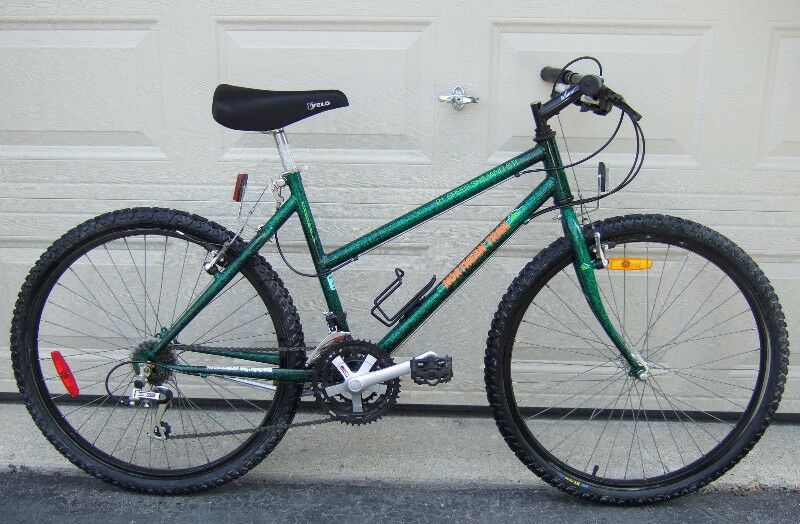

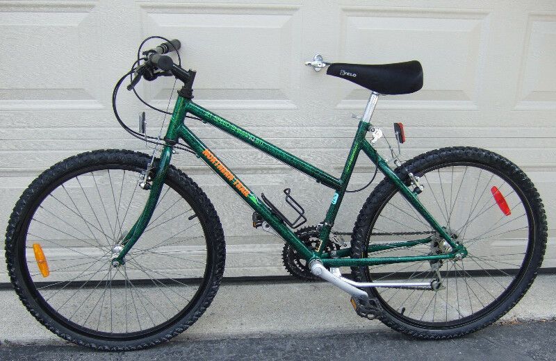

Just look around. There are some incredibly well-equipped older steel "all-terrain" bikes that you can pick up for next to nothing, if not free, simply by putting an add on the local Buy 'n'Sell.
Most of them were used very little, and seldom abused, especially if they had step-through frames (women's models).
I picked these ones up for free, and, as you can tell, either one of them would supply enough spare parts to rebuild your Bianchi Grizly frame into a rideable bike.
Indexed Shimano kits and cantilever brakes.

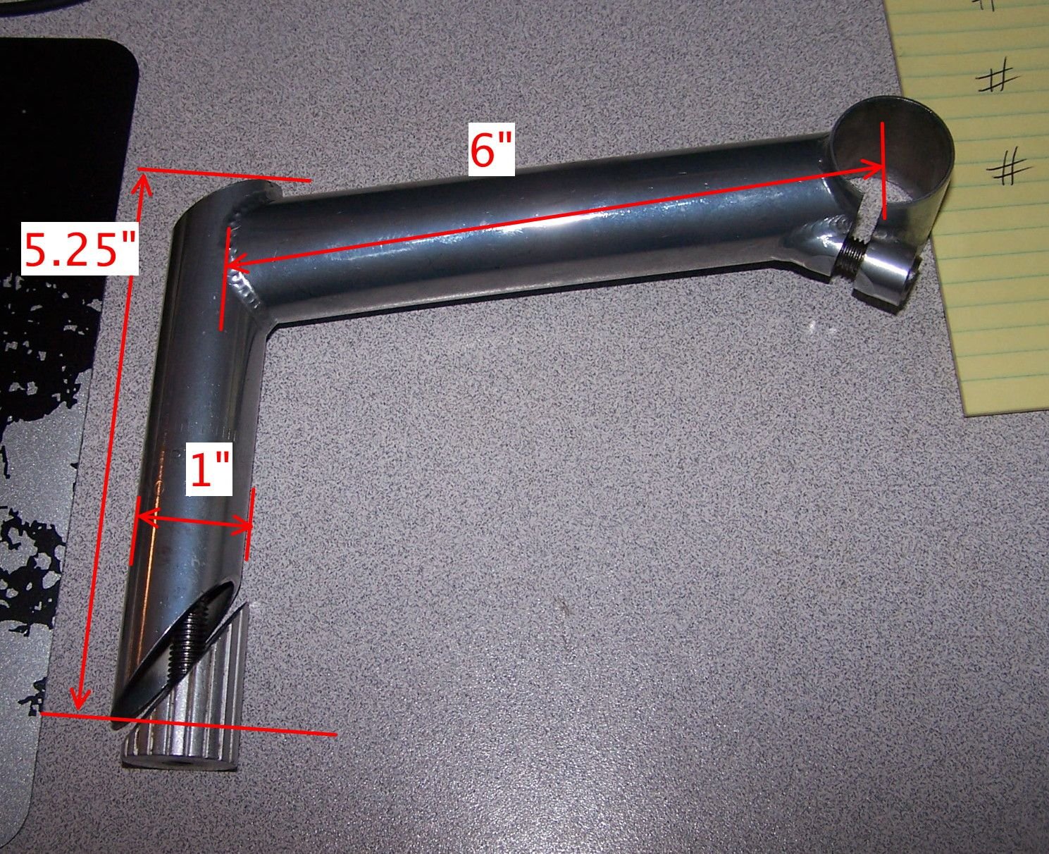

Chime in here guys.... tell him to measure the ID of the fork tube, or put in a 7/8" quill and see it it rattles around like a dick in a bowler hat.
Are we looking for a fatter than usual handlebar stem with a 1" (25.4mm) quill ??
If we are, I have a Cro-mo ALICO handlebar stem, but it as an outrageously long reach. See picture below.
If you have arms like a gorilla and cannot find anything closer to home, let me know and we'll figure some way to get this to you before riding season stars.

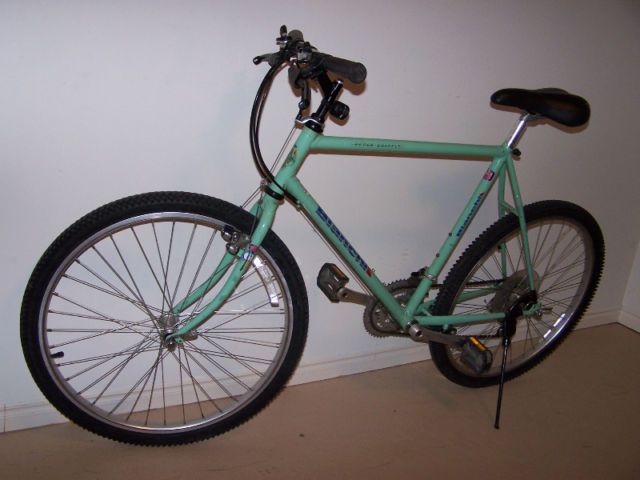

Technically you could swap rims or hubs if one is close and not another, but it can be a hassle, and perhaps expensive. Or choose a donor bike that supplies 75% of the parts, then you'll acquire the remaining 25% of the parts.
Wow !! I assumed that he had an old Grizzly from the late 1980s, one of those old rigid steel all-terrain bikes.
Please correct me if I am mistaken.
It would probably be a good idea if we actually saw a picture of the frame you have.....
Maybe it will look more or less like this when finished off:
You are correct!
I'll try to post a pic but it is the one in your pictures.

Great. That bike in the picture is my own Bianchi Super Grizzly, probably from 1988 or 1989.
You will have no trouble finding a parts bike. Either of those steel all-terrain bikes that I posted before, the blue Raleigh Rocky or the green Northern Trail would suit.
The bike frame you have will accept a front fork from just about ANY all-terrain bike with 26 inch wheel set and that has a 7/8" quill.
