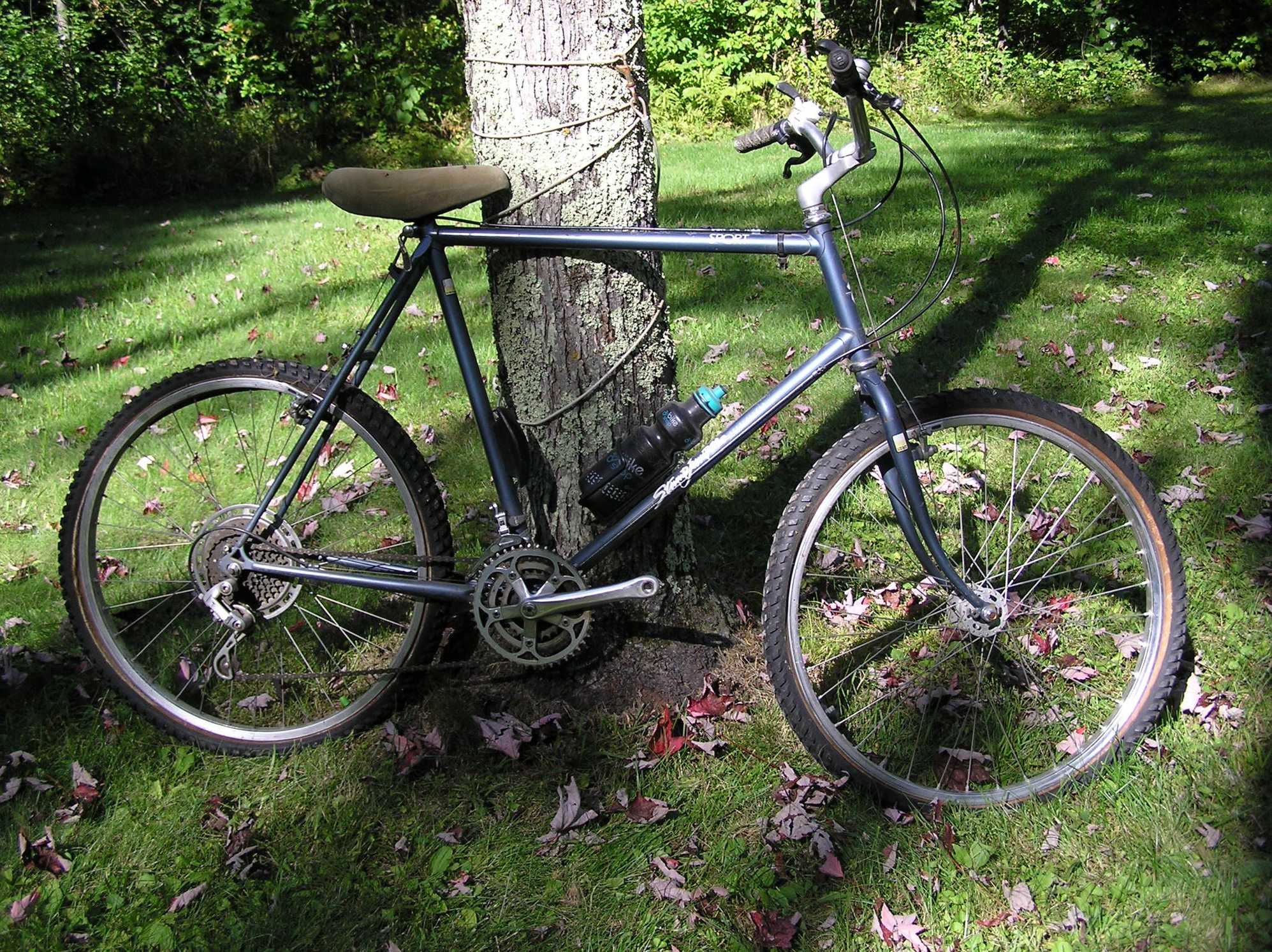

As has been noted, finding a bike that physically fits you will be priority one. Some adjustment can be made to the seat height and setback, as well as the stem height, but you need to find one with a frame that's in the ballpark.
You're the only one who can accurately asses this, but based on the 5'-11" and 35" inseam you gave, you're looking for a tall bike with a shorter top tube. Many here at C&V would refer to these proportions as "French fit".
This means a road bike with a 61cm frame or thereabouts, as measured along the seat tube from the center of the crank to middle of the top tube. The top tube should measure the about the same or slightly less, from the middle of the seat tube to the middle of the head tube.
This gets a little trickier with mountain bikes. Most of them have short seat tubes and long top tubes. You'll be looking for a frame that has a head tube long enough for at least a hand width of height, between the top and down tubes.
Note the head tube height shown in the examples below. These will generally be called "extra large".
The last example shown is technically an "all terrain bike" (ATB), otherwise known as a hybrid. The Trek Multitracks are well known for versatility, are fairly light for steel, and make excellent commuters. They can generally be found for reasonable prices, although the taller ones aren't very common.
