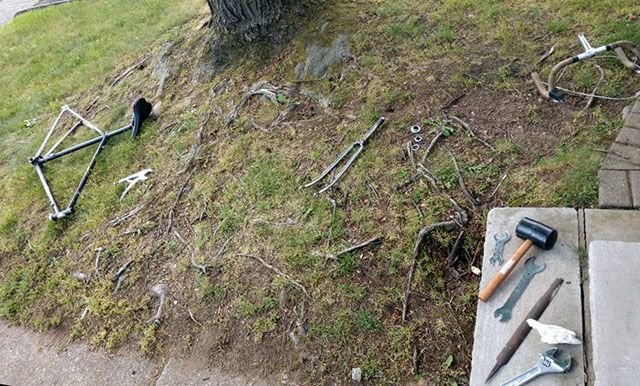

For the last six months or so, I've had a Pinarello Record with stuck Cinelli stem soaking in WD-40 to no avail. FInally on Friday I gave up and sawed the thing off. Turned out the headset was so well gummed onto the fork that I demolished the nut and top race trying to remove them, finally using a pair of vise grips once the hexes had been thoroughly rounded. Not one of my finest efforts. End result of the demolition derby shown:

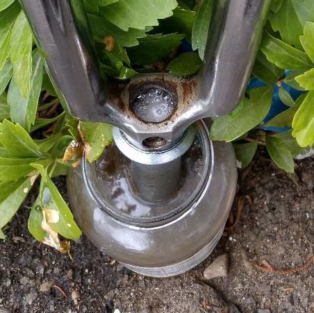

But, I still have a chunk of aluminum thoroughly stuck in the fork. I dont know why the picture looks so awful but the threads on the fork are fine
Location: Northern NJ
Posts: 419
Bikes: 1987 Pinarello Montello, 1996 Litespeed Classic, 1996 Colnago Master Light, 1997 Litespeed Ultimate, 2006 Opera Leonardo FP, 2006 Pinarello Paris FP, 1984 Pinarello Record, 89-ish Cornelo Profilo
Quoted: 148 Post(s)
Liked 119 Times
73 Posts
Now, the fork is sitting upside down in a tomato sauce jar of drain cleaner, out on my driveway, bubbling away quite happily. Liquid is now completely black, and the jar is noticeably warm.
One molecule at a time, though, I think this is going to take a while.

It's probably worth pointing out that the main chemical in drain cleaner (ie lye) can cause severe burns, blindness, etc. And, the hydrogen gas emitted by the reaction is extremely flammable (think Hindenburg). So, exercise extreme caution ye masses and don't try this in the house.

My jar of Lye powder just arrived. Has a warning on the label not to allow it to come into contact with Aluminum. Also that its safe on Chrome. Sounds like a win-win.
I filled a sauce jar about 4-5" up (to fully cover the stem) and added a generous amount of lye powder - about 1/2 cup to a cup I'd guess (not a fan of measuring). Stirred using the steerer tube. Stepped back. Within seconds the jar was too hot to touch and the reaction is tremendous - far more than with the drain cleaner. This may not take so long. If I see the top of the steerer resting on the bottom of the jar, I'll know its done.

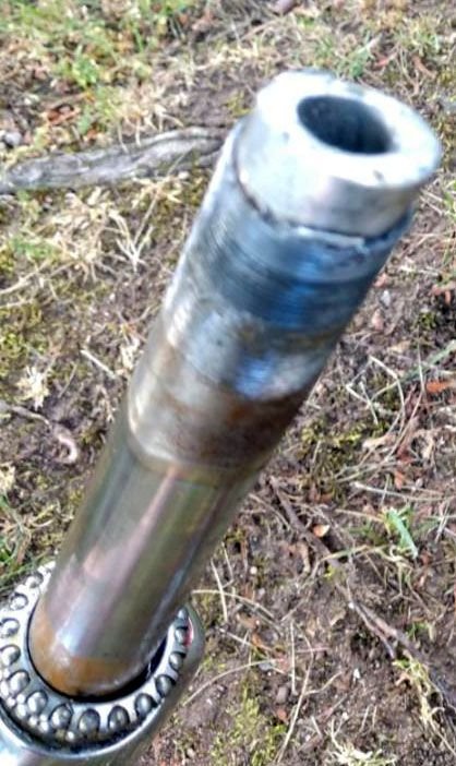

One last follow-up. The science experiment is complete. Aluminum stem is gone. Steel and chrome are unharmed. I washed the fork down thoroughly with water and then sprayed every inch of it with WD-40 both inside and out. "Sanded" the chrome with a wad of tin-foil and the foil/WD-40 combo took off whatever rust there was on the chrome. Beautiful, clean, ready to re-install once I find a new headset.
This sliver of stem is all that was left in the fork when I took it out of the bath. Had I left it a little longer, even this would have been gone.

20 hrs in an enameled pot with close to 1lb of lye freed up the fork to my curb find 88 Ironman Master. Started yesterday afternoon.
