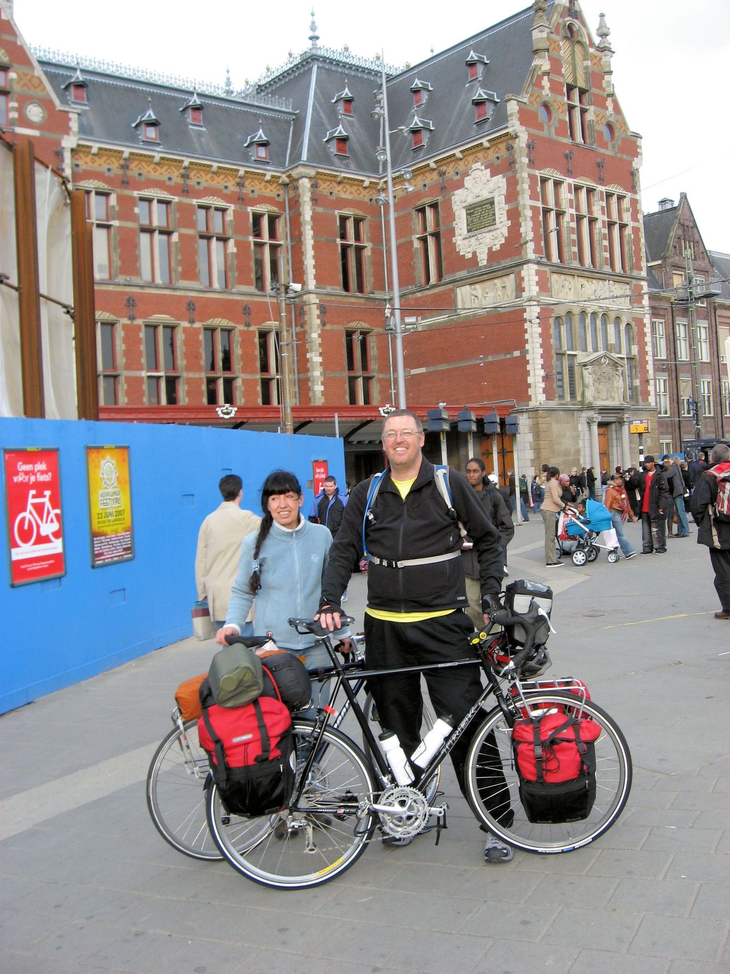

Not backroller, but I've used bikepacker plus as both front end rear panniers. Photo below in Amsterdam at start of trip (new looking panniers) on my way to Vladivostok.
As others have pointed out, it will depend some on your rack. As far as handling and corners go, my bike fully loaded with myself and gear handles like a truck - but nothing unique to having a pair of 21L panniers up front. The combination of weight and ~1500km of gravel road did eventually cause the brackets on my front rack to fail - but I was able to work around that some to make it work.
Same bike and same panniers on other end of EurAsia (and a few less pounds)
mev is offline

Ya I guess one does have to think about front rack max load recommendations if you go with much larger panniers up front. Another reason I really like wider tires because when properly inflated they do provide a bunch more cushion to everything over rough roads, including the rack attachment points and the pannier hooks and whatnot.
And as an aside mev, I have to say that I think a beard really does suit you better. Well I guess I shouldn't say better, but certainly a beard works and we aren't used to seeing you without one.
