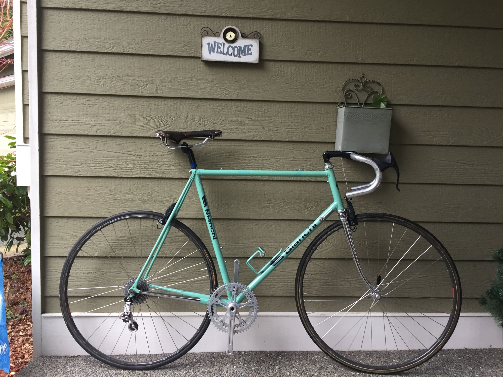

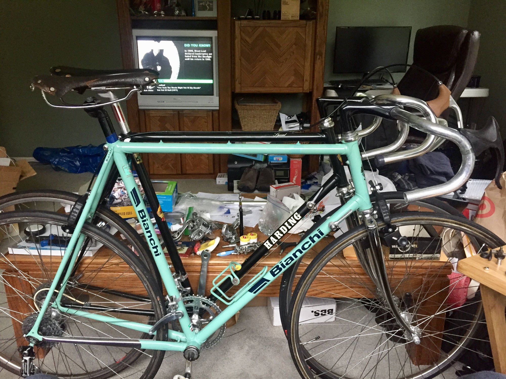

Getting one ready for chain & final rd tune. Check every nut/bolt/pad/etc.
The Bianchi (1st celeste for me) deserved a mock-up for other pictures But is 2nd in line to Rickert; or maybe build two-atta-time? No rush on either, all parts (seeming) on-hand for both.
Rainy day morning - the news is so bad, it is Allman Bros Band on the cable music channel.. edit = it switched to Meatloaf (yeackk) for the pic.
edit: Or better wIth tanwalls?
luckily these 27mm (measured) tires fit under these brakes with 2.5-3mm to spare.
Didn’t have the heart to move Pete for a pic.

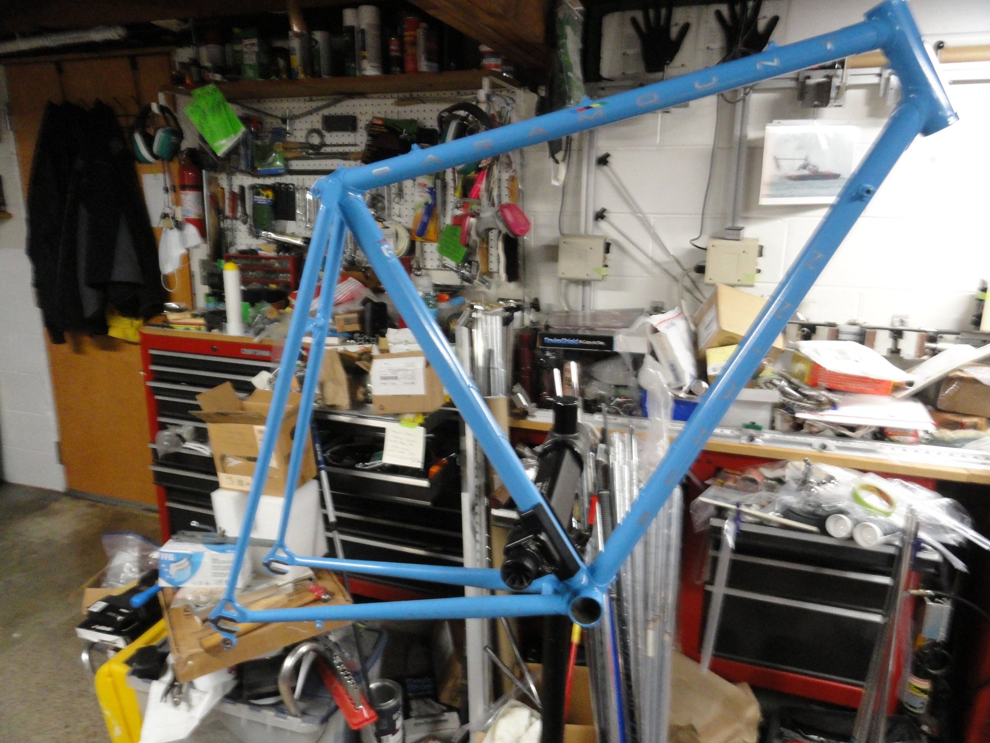

Removed the 'fixed' bearing race.As always a bear to remove, especially as the BB shell had been pounded by something. It had been on there since 1980.
The hole had been elongated by the axle rubbing on it after the bearings had broken their cage thru lack of grease. I can't imagine what it sounded like going down the road to wear the race in such a manner.

Wildwood,
Tan looks better to me, but I know it's a personal choice.
BTW nice to have a "watchdog"
Best, Ben

Does @Wildwood need a grub screw for his SR rd?

Perhaps the spring for the chain cage is set to the weakest position. Or you may be right missing grub screw . I have been using some stainless rod to make replacements here in the shop. Smiles, MH

@Wildwood, Those tan walls beat out the black walls for me.
Nice bike.
