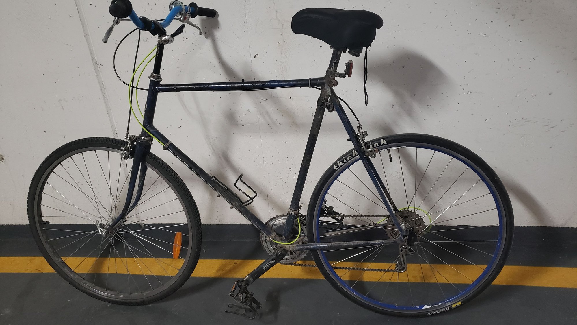

I'm looking to either use my current road bike or buy something else specifically for singletrack use this upcoming spring.
I get good comfort and performance on a road bike with a short reach/top tube (390mm reach, 580mm top tube) converted to flat bar using a tall 40mm stem. I want my handlebars slightly above or nearly level with my seat.
I feel like I can rip singletrack on this bike, but tire clearance is lacking in the rear dropouts and the bottom bracket is too low to do anything serious.
I'm thinking that some sort of flat bar gravel bike with extra tire clearance might work best.
Do you think that the short top tube and reach which I prefer isn't ideal for singletrack?

MTBs tend to have longer top tubes and frame reach numbers than road/gravel bikes.
This has been true for many years but in recent years the difference has become even greater.
Go to any bike company's website and look at the top tube and frame reach numbers of drop bar road/gravel bikes compared to MTBs for a given recommended rider height
Several reasons for this:
1- Drop bars add a lot more reach than flat bars, so the frame reach needs to be shorter.
2- A longer reach frame with a short stem puts the front wheel farther out in front of you, which make the bike less endo-prone.
Of course, if you WANT an extraordinarily short reach.... then a drop bar frame with a flat bar will get that for you. But there are reasons that MTB designers and riders have long moved away from that.
OTOH, the fact that you feel like you can really rip single-track on your road bike (along with other comments you have make about suspension and single-track) makes me think that what you are calling single-track is not what most people mean by it.

Well I just outlined one issue in my first reply (see point #2, and consider the opposite situation).
Also, are you going to run a longer stem to compensate for the reduction in reach moving from the drop bar to the flat bar? If so, you are again making the bike more endo-prone. If not, you are going to have a fairly cramped cockpit that does not allow you to practice what is now widely accepted as good bike handling technique. I am not going to try to fully explain this, as you can learn this yourself with some Googling, but what is mostly comes down to is a super short reach it makes it hard (if not impossible) to achieve a good, balanced "attack" position. When you try to get low, you also end up having to get far back, which is not great for maintaining a good fore-aft balance. Yes, you don't want the reach so long that you can't move fore/aft, but making too short prevents you from getting low in an effective manor, and leaves you very cramped while trying to do so.
One other issue not related to the reach is the fact that gravel and road bikes have steeper head tube angles, which not only decreases stability at high speeds in the rough (an issue that is real, though I think it often gets a bit overblown), but also pulls the front wheel closer in, thus increasing the tendency to endo.

Well, from the perspective of how poised and balanced I feel on the bike currently, I wouldn't want my setup to be any different unless we are talking about more technical singletrack with rocky and rooty stuff. If were talking about quick flowy more XC related stuff, I dont think I'd be able to do any better than what I have now. With the addition of my 40mm stem, down from 60mm, I was able to slide my seat back roughly 8mm, so that I am still in a slightly leaning forward position without sacrificing that rear weight biased feeling I have been longing for.
If we are talking about something more technical which requires you to be frequently out of the saddle to navigate, I think I would need a combination of just a slightly longer stem paired with a slightly longer top tube so that I can slide my seat a bit more rear wards to get that stretched out position necessary for such terrain.
So until I experiment with some legitimate trail bikes, I think I'd be better off sticking to with some more mild trails...
because if I do simply opt for a longer stem, like 60mm or longer, I feel a bit too endo prone.
Well it is certainly cheaper to play around with what you already have.
But if you can try out a dedicated MTB, you should consider doing so, so that you have something to compare your current setup against.

I still have my Zaskar laying around in the garage, which is in the process of finding a new home. The geomtery of this bike is more or less the same as other XL hardtails I've found online - that is to say, long and low, the exact opposite of what I find comfortable, or, at the very least effective. I'm not so interested in going down that route once more.

I did... but with my seat set all the way up to baseline, even if I use a 32mm stem the stack is much too low and the reach/top tube length much too high.
I was using a ridiculous stem riser with backwards 32mm stem setup along with a 100mm fork which was way too long for that frame and bent, despite all this, the bike actually performed relatively well over some fairly tough rocky/rooty stuff. Its definetely a fantastic bike and very capable, but not for me.

Yes, flat bar, with a very tall 220mm stem:
It works absolutely brilliant for me. As long as the handlebars are level or just above the seat, im happy.
When I am maneuvering obstacles with loose pebbles strewn about, or muddy turns, slippery snow etc, I feel so bang on centre, its usually the front end which hooks and the rear end comes sliding about extremely gracefully. I literally feel like I can control the slide and keep the rear tire in check by steering with my butt. I also really like the reach, because when navigating sketchy terrain, i can keep my weight centered into the pedals although my butt is still hovering just over the saddle. It is an incredibly stable feeling - one which I've been longing to achieve for a very long time.
I'm well aware that on serious singeltrack, this cockpit is simply too cramped. Other than going for a slightly longer top tube, I'm not sure what else I can do which still always me to achieve this sort of balance.
when im riding a bike with a certain length top tube, I feel like I am hanging over the front of the bike and it totally ruins the handling response for me. I have to enter corners gently and gingerly to avoid front tire skidding. With this current setup, I can downright thrash the bike through any turn I like, whether the surface is smooth or rough, and I am always rewarded with superb balance and a very commendable response/agility for a 200lb rider.
However, as you can see, I need a very tall stem. This limits my options to frames with a threaded fork and quill stem.
