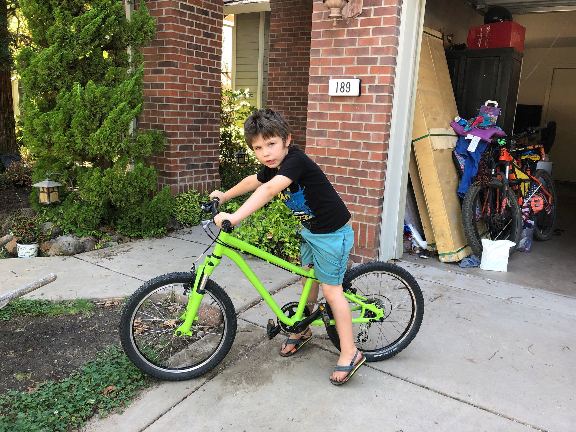

The last part arrived today and I finished the bike. I rode around myself for a few hundred feet adjusting the shifter, and then we were ready to go for a bike ride. He’s definitely pretty stretched out. I should try him on a shorter stem. He successfully downshifted going up a hill, but has not yet upshifted the other way. He did a sweet seven foot skid learning the back brake
