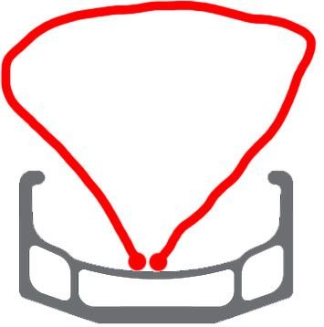

Tight tires, grind down tight rim to decrease diameter?
My ebike motor's rim is an absolute pain to mount tires on. I know that it's a problem with the rim itself since I've put my exact same tires on another rim with much less effort. Potential DIY defects aside, Is it feasible to grind down my rim to decrease its diameter? I'd rather not spend money on a new rim and service to re-lace my motor.
Edit: The rim in question is the Sun Ringle Rhyno Lite 26x2.00 with 36 holes.

no, you can't shave your rim.
Although the center channel of the Rhyno Lite is very shallow, try squeezing the beads together and press them as deep as possible into the center channel on one side of the tire, and then use a tire lever to pry out the tire the opposite side (180 degrees). Once you get a tire lever to pop a small section of a bead out, use a second tire lever to run around the rest of the rim. A rim with a deeper center channel would be easier for removing tires.

tomtomtom123 is correct. First, the rim mfr did some weight optimization vs strength. Removing metal arbitrarily is going to give you weak rims. On an ebike? Nein danke.
Second, there is no way to do the grinding with sufficient precision, without removing the rim and mounting it on a lathe face plate. Precision metal cutting requires tools and jigs and fixtures that are exceptionally rigid and a spoked bike wheel doesn't qualify.
So, I suspect that you'd end up with an aesthetically unsatisfactory wheel with really uneven grinding marks that would break prematurely.
read tomtomtom123's post: make sure that the wheel beads are in the center well of the rim when you mount the things. I had huge problems with my tires and rims until I remembered this.

The video is wrong. It matters where you start, and beginning at the valve is a handicap..
Rims have a shallow depression in the center.
To get the last bit of bead over, you need the rest of it in that depression.
At the valve hole the depression is occupied by the valve stem so that can't happen.
Start 180 degrees opposite the valve. Finish by continuously moving the bead towards the center, maintaining tension, and milking the slack to the end. Flip it with your thumbs or palms.
You don't need straps if you keep tension on the bead all the way around.
This ignores the gains from using a thinner rim tape. Substituting two wraps of 1 mil Kapton for tradiional rim tapes will get you .0.030" of diameter and 3/32" of additional slack.
Together that's the difference between cussing at tools and comfortably mounting tires by hand.

I'm using Schwalbe Marathon road tires. Those tires are already tighter than usual, so the combination was brutal. I used to use Maxxis Gypsies, which were still unreasonable.
People are saying to guide the bead into the central depression. Does it not do that automatically when you pull on it when flipping tire levers?
Not really. You have to manually press the bead into the center channel on the opposite of the tire lever and also massage the slack from the pressed area towards the lever. If you apply an incredible amount of force to the lever then it may pull the bead into the center, but there is a risk of damaging the rim or tire, and it depends on the shape of the channel and whether it not the rim tape gets in the way. That's why people are recommending thin rim tape for you.
Have you ever seen a YouTube video about how radial deep groove cartridge bearings are assembled? Have you ever wondered how they get the balls in between the 2 rings? It's the same principle as removing a tire from a wheel. By moving 2 concentric rings so that one side is closer together, it increases the gap on the other side.
as per the video, my experience shows that by pushing the tire into the deeper section, and making sure you keep the tire in the middle as you work your way around, you accumulate a tiny bit more slack as you work your way to the end.
By not doing it, when you use the levers, it doesnt automatically do it ALL around the tire.
my take on this technique is that the difference is small, but by gaining those crucial mm's of extra room, plus maybe some wet on the last bit of rim to help go against the sometimes natural "sticking" of the rim and bead, to help it slide over a smidge easier, plus some good strong levers--all these small details make the difference.
but of course, every tire and rim combo is different, and some people have much stronger hands and fingers than others.
the few times I've encountered a real bugger of tire/rim mixes, it has helped using straps because they physically squish the tire in and keep it in place, it doesnt spring back, but usually I can just use my hands and make sure the tire stays in the middle as I work my way around.
