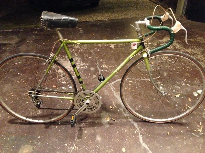

Oh, yeah, Super Tourer. I’ve owned a couple of those, too, but they’re essentially Competitions with upright bars, which means really lousy geometry for that weight distribution. They call for drop bars and more weight on the front end, but then you might as well find a Competition, which are far more readily available.
To this after all the work I did on it; swapped to Soma Late Riser bars.
I've thought about putting newer drops on it with modern levers, but, right now it's the only more upright not-serious-riding bike I've got.

The B17 is my first choice on any vintage Raleigh. Comfort wise, I always felt the Ideal 80 was a better fit for me for some reason on my drop bar bikes.
As I get older, I'm getting away from drop bars and strongly prefer a straight bar conversion and have a few projects sitting waiting for me to get around to them.
