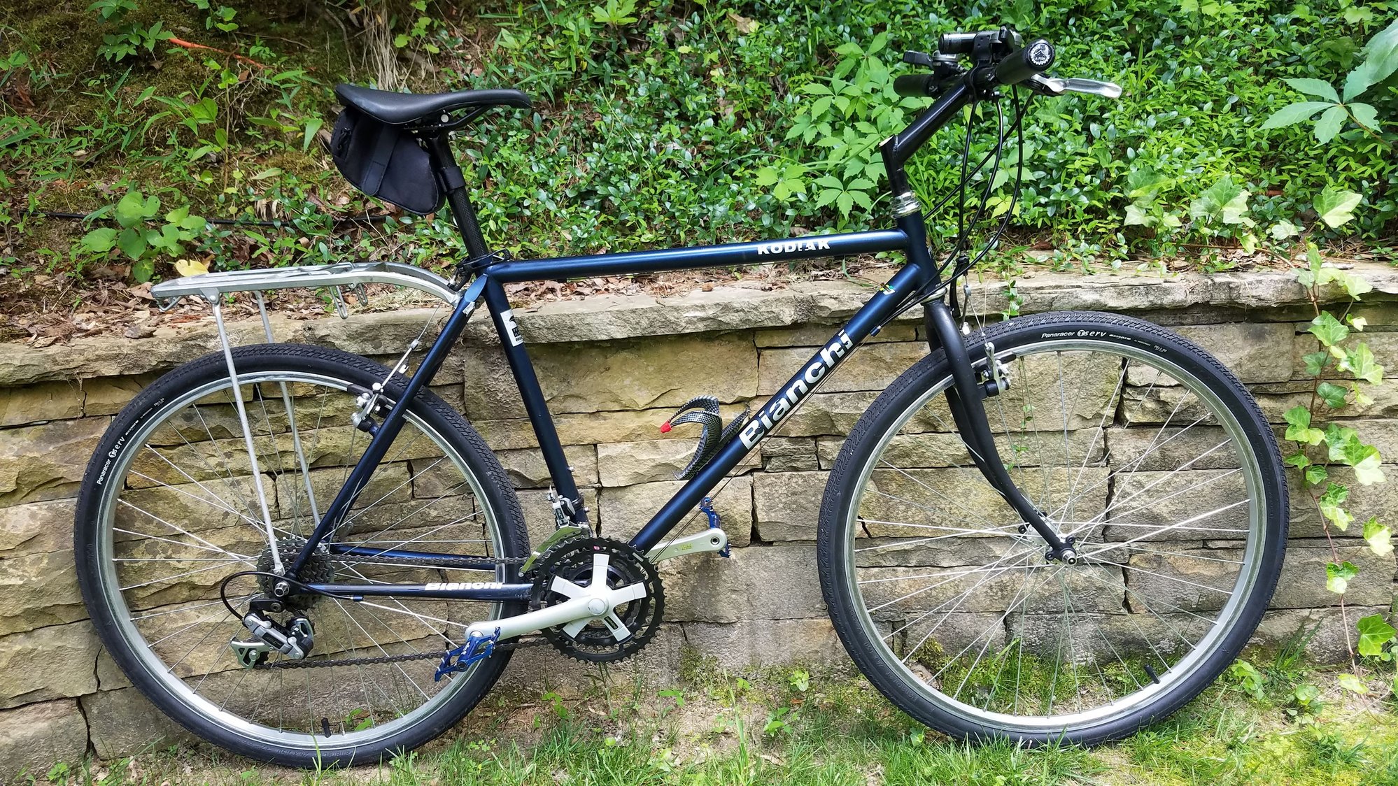

Why not just pick up a used rigid fork? I found one for my bike for $16 and the swap was easy and the weight reduction made a much more fun riding experience.
