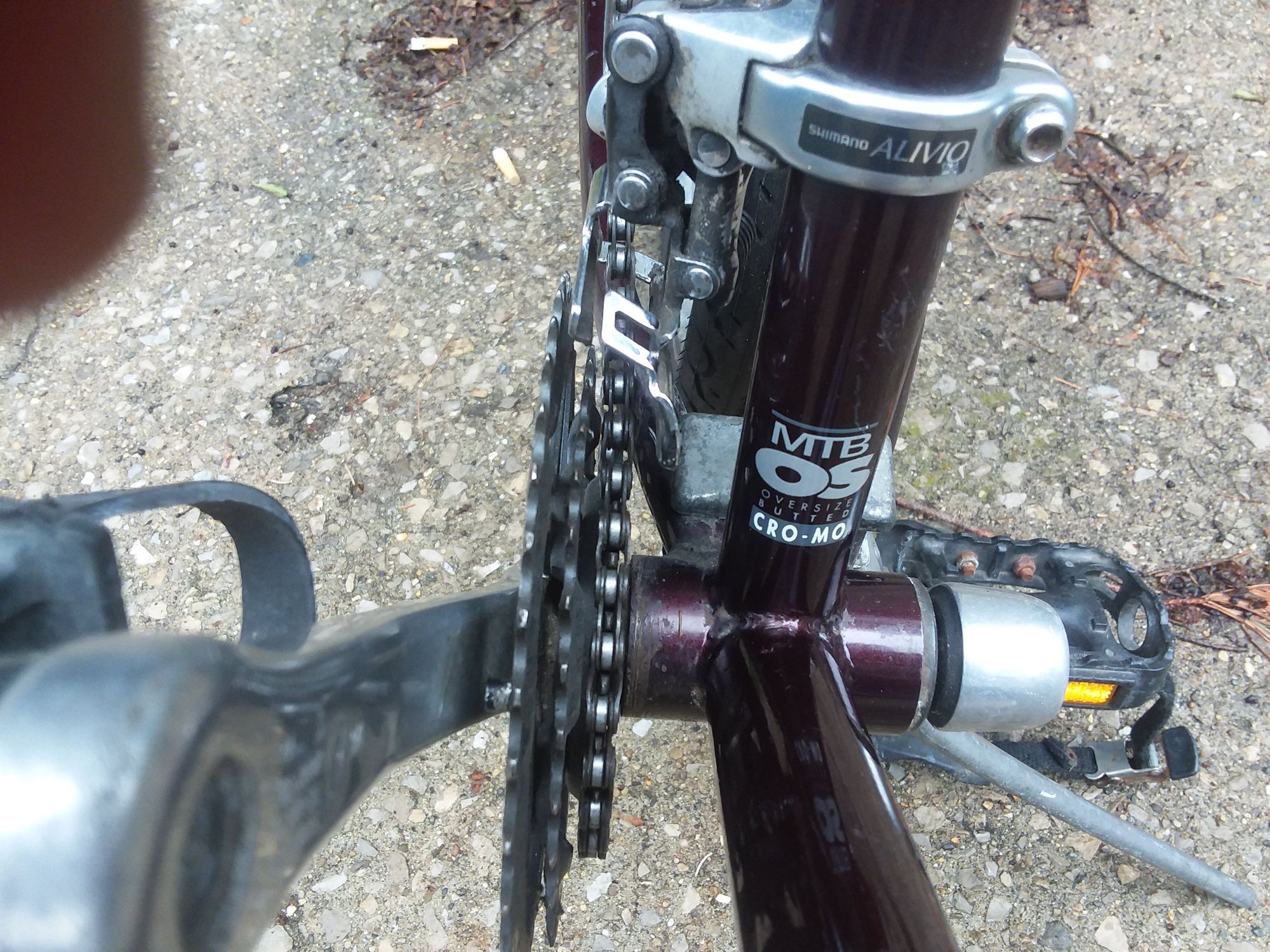

I rescued a Schwinn Moab from, a garage sale for a song. Not a very good one at that!!! The stamp on the BB reads 4AC24912. To me it didn't look that far gone. A side from battle scares it's pretty straight

My first thought too. Did a quick image search and it looks like yeah, that's on purpose. Reducing chain slap maybe? I dunno. Odd.

That chainstay design looks similar to Univega's "Max Mudroom" design. Intention is to bring the BB up some.

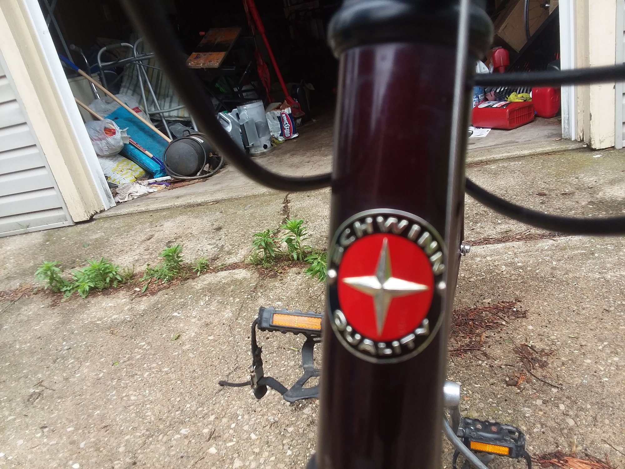

Can you get a focused pic of the headbadge. Number on that badge will indicate manufacture date. But it's '90s, canti brakes, threaded fork/headset, square taper, rapid-fires, so yes, squarely a C&V MTB. They'd put sub-Deore-grade components on a quite nice frame, to keep the cost down. Top tube cabling is a nice touch.

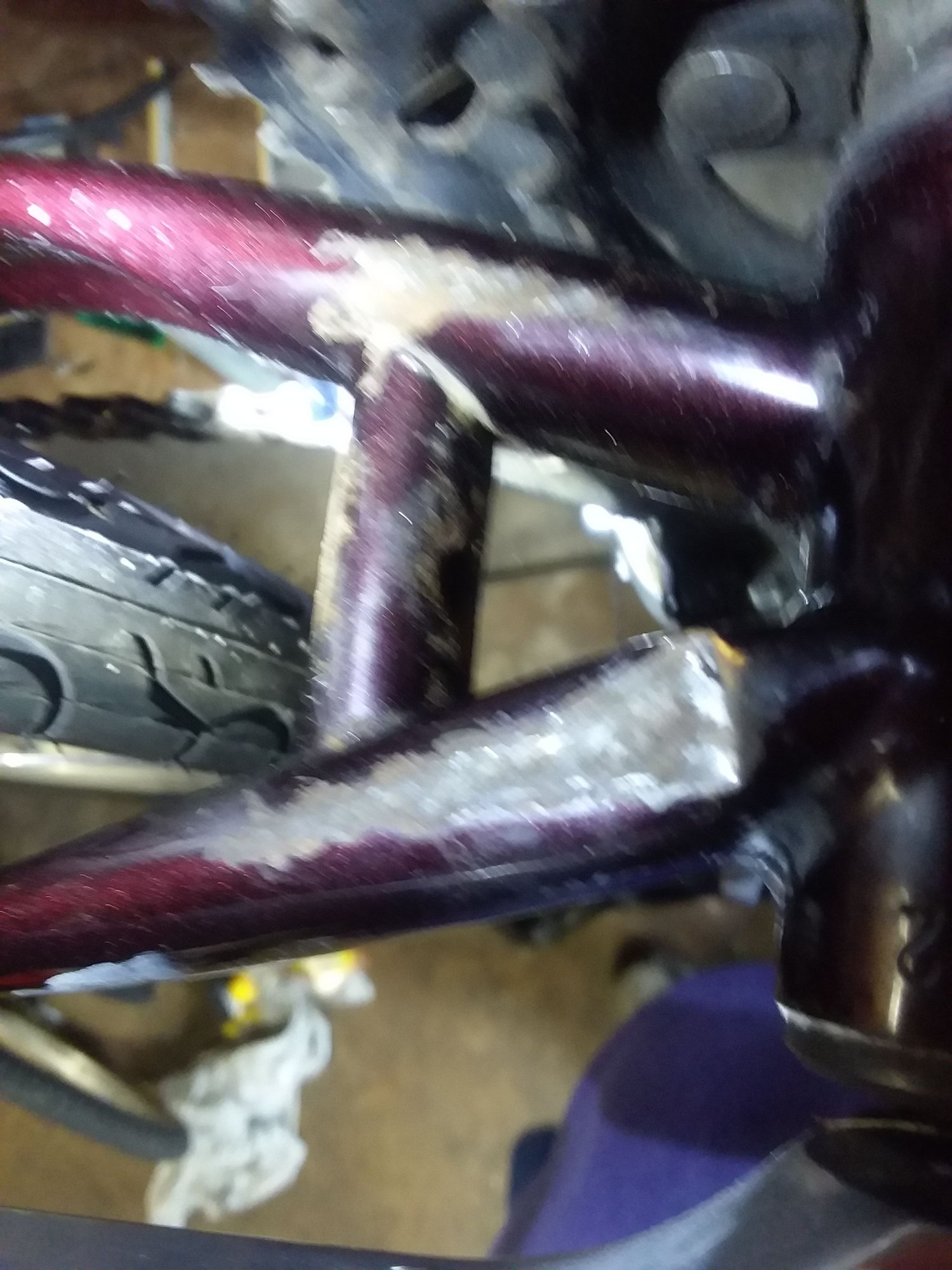

Get that kickstand off, and look for crimped stays. Frame paint will most likely be damaged there.

So it was built March 23 (54th day) 1994. C&V in my book.
Hard to tell from it being out of focus, but it does look like the one stay was crimped by the kickstand. Or maybe it was actually formed that way to accommodate a kickstand. I would at least slap some primer and paint on that bare metal.

The serial number corroborates that the frame was manufactured in March 1994 and the format is consistent with M-a-t-s-u-s-h-i-t-a of Japan, a known Schwinn contractor and best known for their Panasonic brand. The bent chainstay was marketing as reducing chain suck and chain slap. Originally, this feature was applied to both chainstays and marketed under the name "G-Force" but they later reverted to a traditional non-drive side chainstay, at which point they simply called them "asymmetrical" chainstays. FYI, original MSRP was $399.95 US. Enjoy!

Yes the design was to allow for more chain travel free of obstructions especially in the lower front ring positions. The first time it appeared was on the PDG oversize tubing mountain bikes. Smiles, MH
