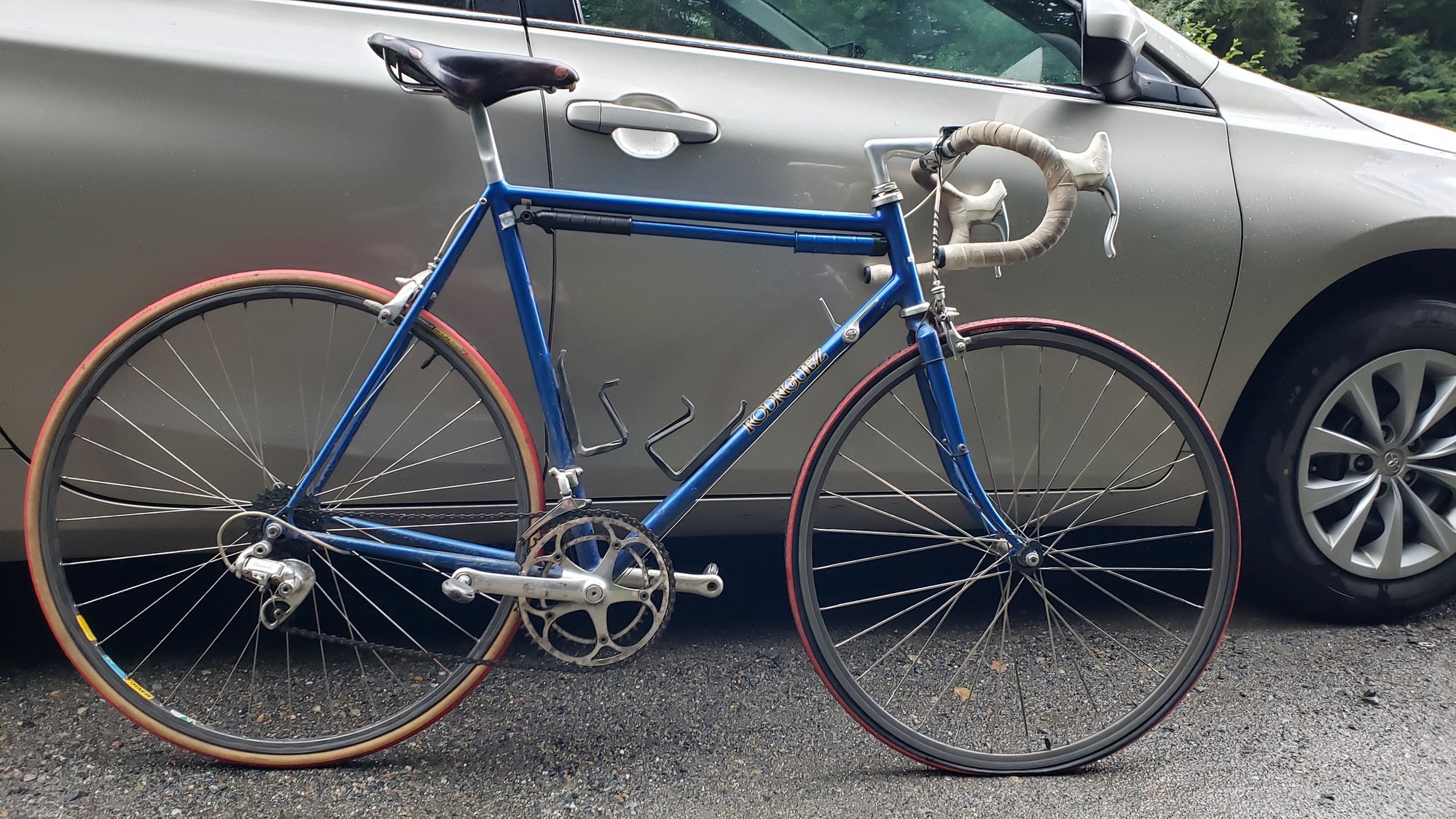

I posted about the yard/estate sale buy from this past weekend that was really like a swap meet. One of the bikes I posted that was for sale was a custom Rodriguez tandem. What I didn't mention is there was another Rodriguez - a road bike that looked to be about 30 yrs old. Fully Campagnolo group and blue - my favorite color. I didn't have the cash for it on Sunday and thought about it the entire way home. Part of the problem was springing for something like that is my wife who can squeeze a quarter out of a penny. Like most she doesn't understand N+1.
I had a custom bike for awhile - my dad's 1989 Spectrum titanium. It's a great bike but at 56 cm it was just a tad tall for me to want to ride all the time. So, it resides back at my dad's house in the basement as an enticement for one of my brother's to ride more. He hasn't so I'm hoping it actually ends back up with me in the future. But, having a custom built frame (granted used and not to my bodily dimensions) has always been a goal.
When I got back home Sunday I was surprised to find little resistance from my wife. Especially since I'm in the process of having a 36'X48' shop built and there's a lot of money being spent. So, with that, I headed back over the mountains to the Seattle suburbs to pick up my "new" bike this evening. It had better have been worth it. The drive over was an hour and 25 minutes. The drive back was 3.5 hrs thanks to road construction.

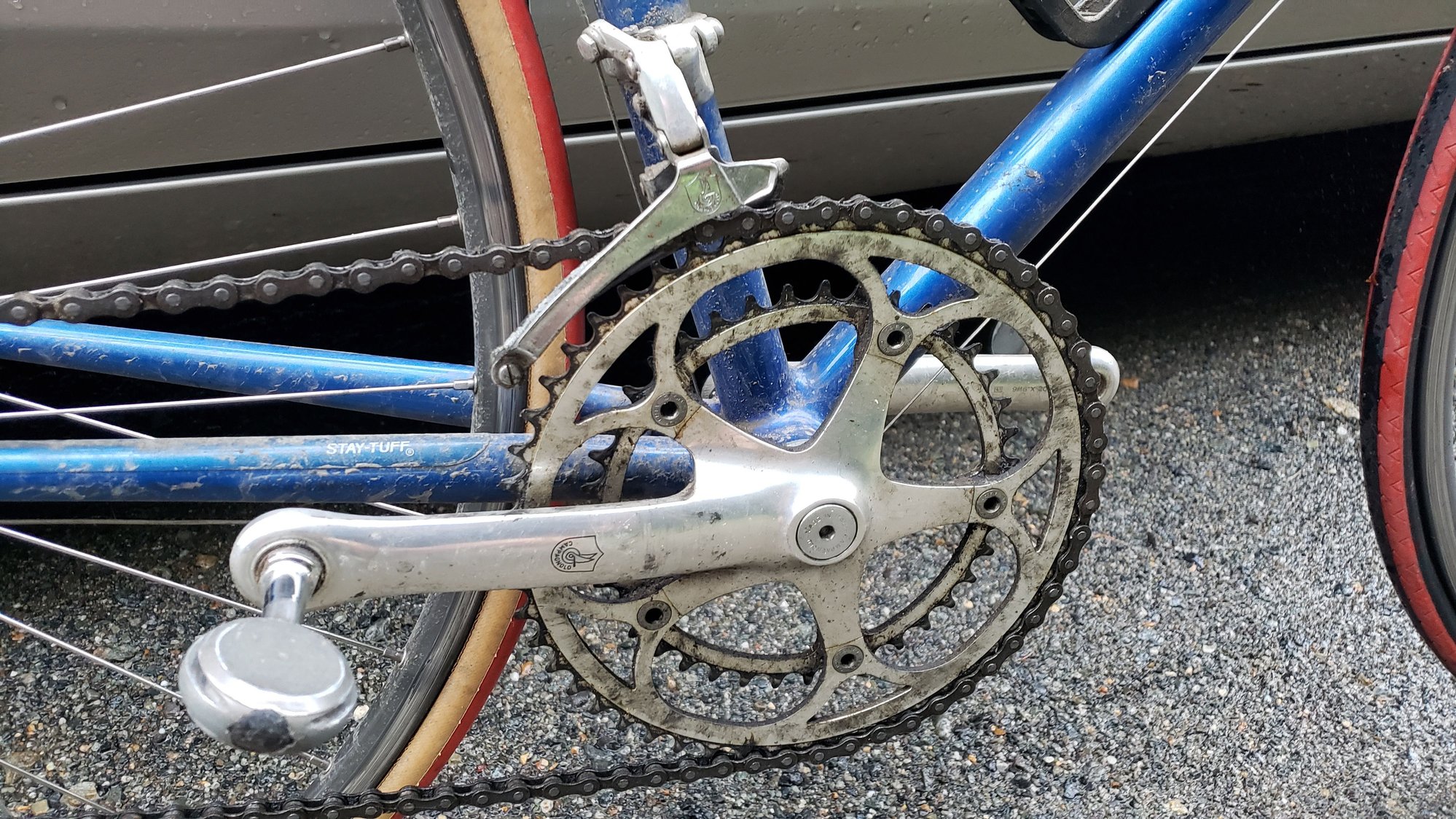

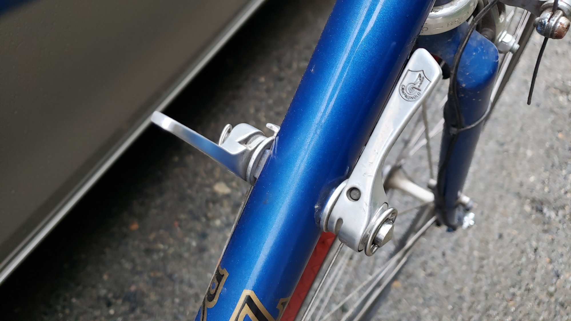

Photos are below - there are a couple of interesting things about it. The group (according to Drillium Dude) looks to be early Chorus. The chainstays are what I would call medium length at around 16.5 inches. The front fork will accept a low rider rack. Maybe it was built as an agile commuter? The frame is TIG welded (update: filet brazed) and has no lugs. The finish work is superb. Rear freewheel is a 7 speed, crankset looks to be 53-39. The rear wheel is a Mavic Open 4CD and the front is an aero Matrix ISOc with bladed spokes. Both are 32 hole.

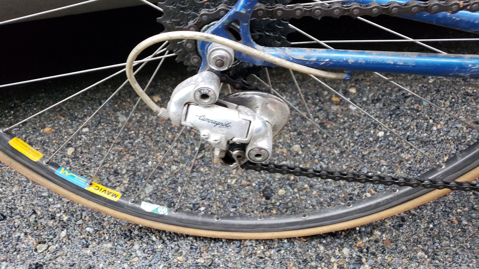

The bike itself is extremely dirty but should clean up nicely. The grease and gunk on the rear derailleur is pretty nasty. So, I have my weekend chore assignment.
I'll change out the bar tape and throw on a Turbo saddle, tires, re-grease things that need to be and take it out for a spin to get the fit right.
Sorry for any cruddy photos - learning the new phone.

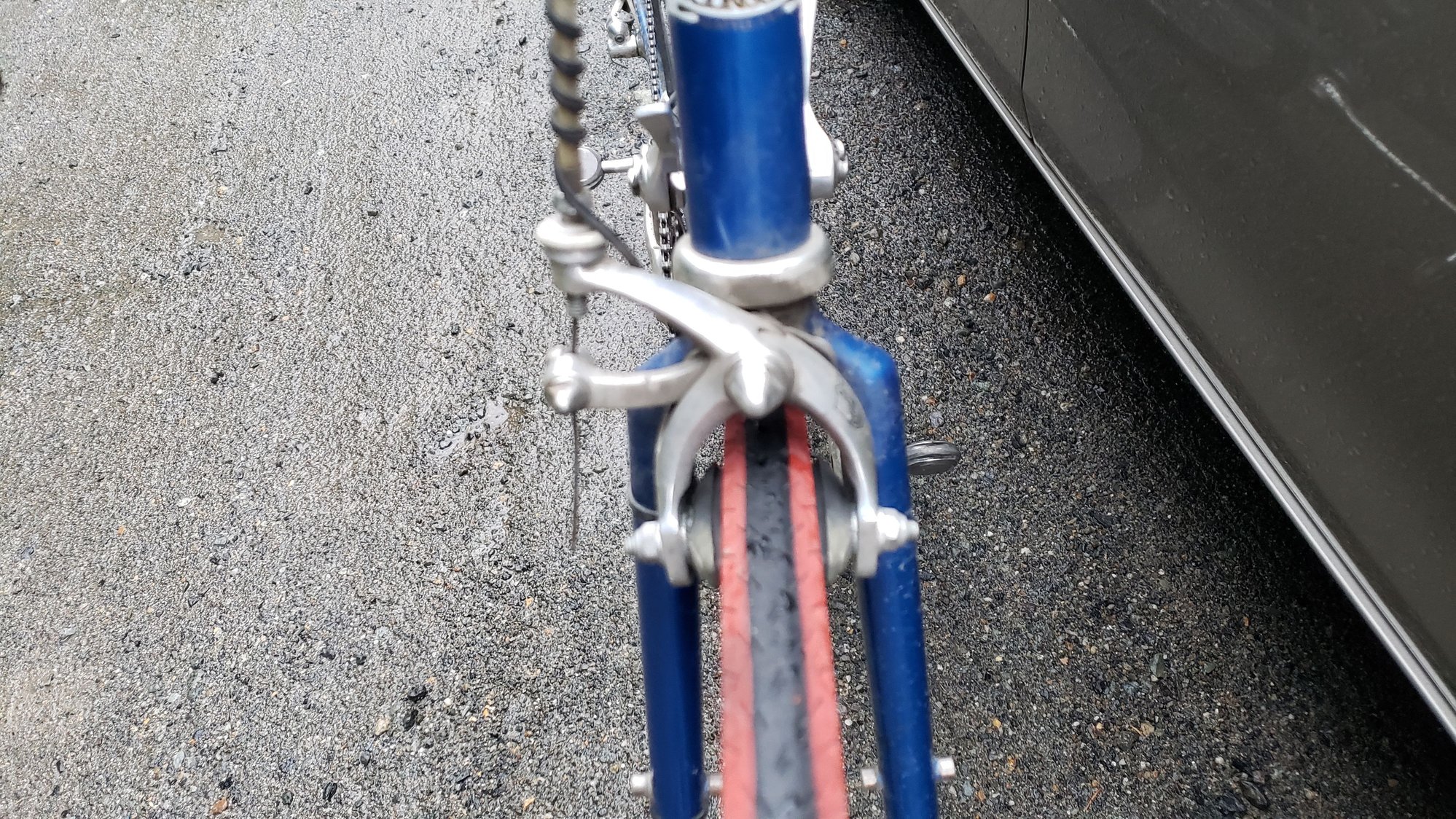

TIG welded or fillet brazed? I'm not an expert, but but when most folks show their TIG welded frames, you don't see such perfectly smoothed-over joins.
Really looks nice. Very cool to see mid-fork rack mount bosses on a such a bike; someone knew exactly what they wanted.

Really great score, what a beauty. That frame is filet brazed, not tig welded.

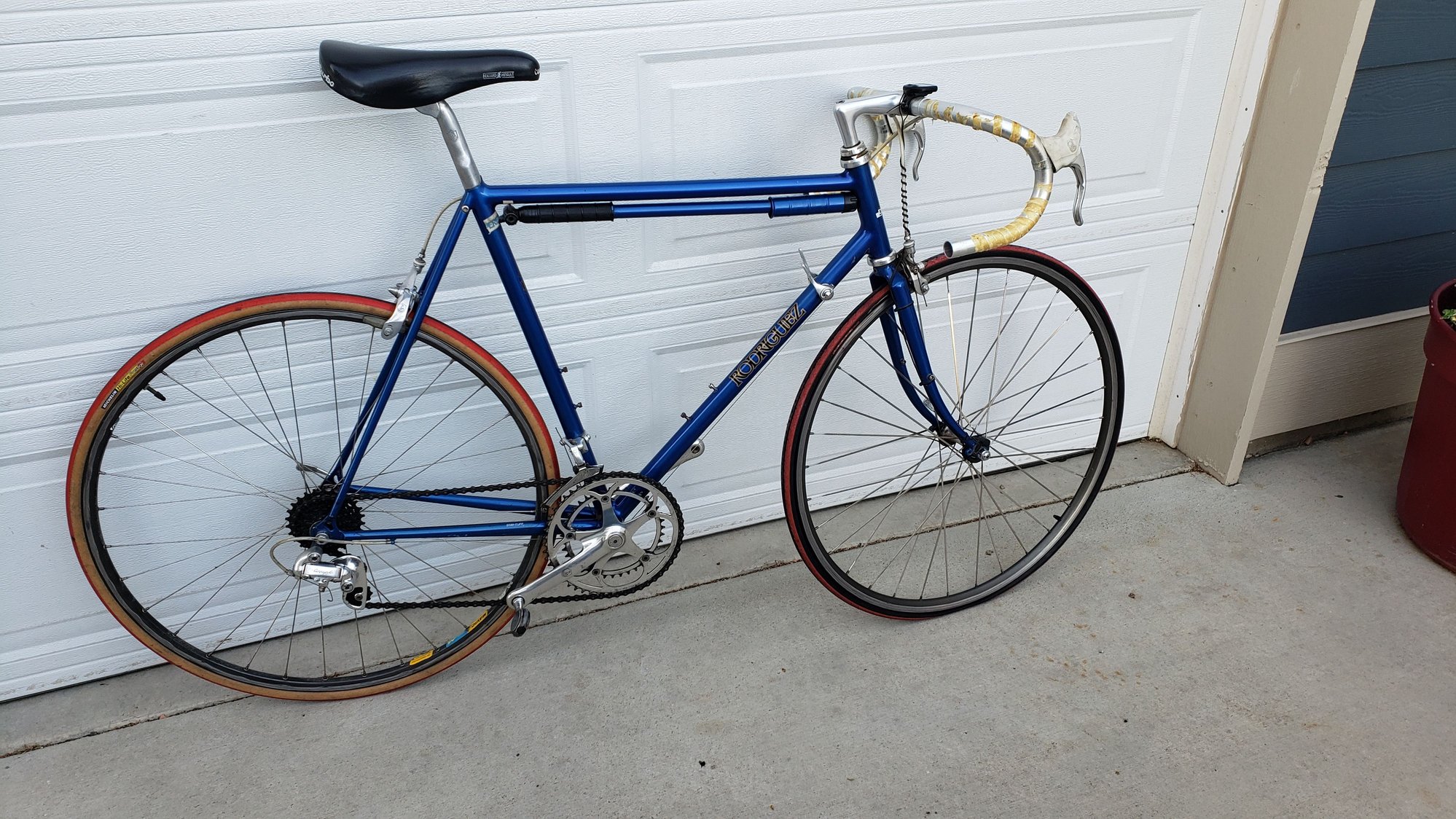

Just did a wipe down this morning and put on a Bernard Hinault Turbo saddle. Definitely right at the top end of what I can ride (55.5 c to c on the seat tube). Will need to swap out the aero seat tube for a straight one that's a little longer so I can lower the saddle. The aero seat post is at its limit right now.
