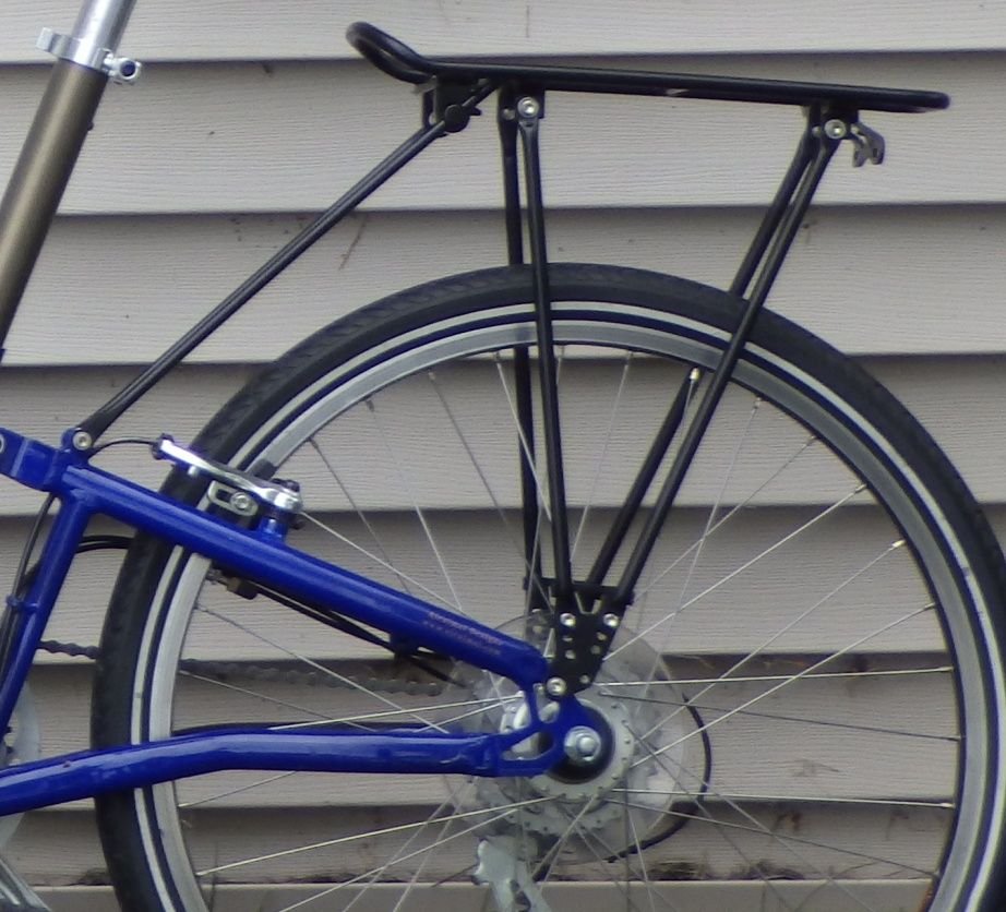

You can of course use traditional saddlebags and/or bikepacking bags with these bikes without any racks. Since you already own the Ortlieb panniers, though, you'll want the Dahon Ultimate Carrier:
or the Dahon Traveler rear rack:

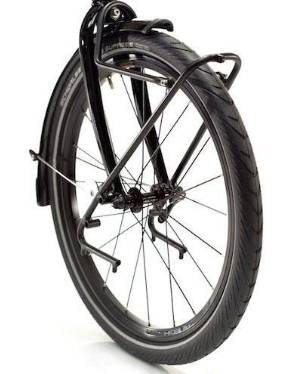

Dahon also offers a purpose-built front rack that attaches directly to the headtube. This would hold a dry bag, tent, pad, a Carradice-style saddlebag, etc.
For small front panniers there's the Biologic Spartan front rack:

If you want a rack that you can also fold up smaller when you fold the bike for transport, RackTime makes a FoldIt Adjustable rack. Two versions, one version (the Adjustable) has a base plate that bolts to the frame at the bottom and the side pieces of the rack bolt to that base plate. Thus, it is highly portable when the rack is disassembled.
https://www.racktime.com/en/racktime...it-adjustable/
You think with a small wheel that you want a short rack but a rack that is too short can also mean your pannier sits too low, possibly interfering with your rear derailleur. Thus, your rack might have to be much higher than you would otherwise expect. That RackTime rack is adjustable for height within reason based on which holes you used in that bottom base plate.
https://www.racktime.com/fileadmin/u...MA_2.0_web.pdf
You would likely need the extra long pieces (order them separately) that attach to chainstays. In the photo I have the rack set at the highest setting, I could lower it maybe an inch or so.
I used those long seat stay pieces (I do not recall length or cost) on my FoldIt in the photo. This is on an Airnimal bike with 24 inch wheel. I probably should have cut the seat stay pieces by a bit to make the rack level but at the time I was too lazy to do that.
