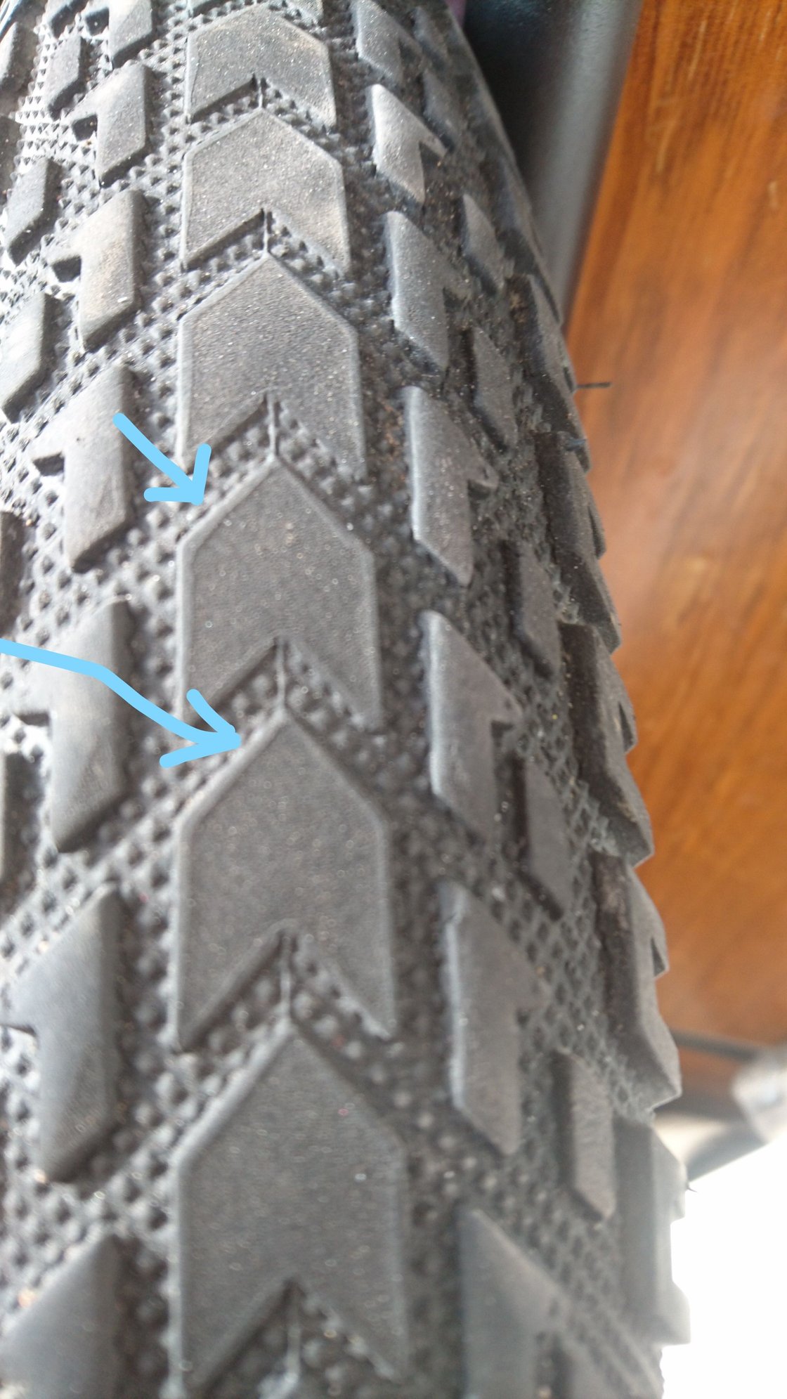

Yeah, I vote for ETs too. But I was one of the people that had one wear out on me quickly and that was mostly on gravel!. It's a QC issue. Some tires don't have enough tread compound rubber, so the tread blocks are like a soft centered chocolate. As soon as the hard rubber wears away from the top of the tread, you're left with a very soft center that visibly wears each day, surrounded by a thin rim of hard rubber. I had a look under a microscope.. Surly refunded me and sent me a new tire(and some swag).
They are still probably the most versatile tire I've used, so I'd say get 'em, but if one starts wearing out real quick, immediately notify Surly for a replacement. It'll be pretty obvious if it's faulty, hold the tread up obliquely to a light source, you'll be able to see a slightly prominent thin rim of rubber around a tread block with a coarser texture.
You really can see the rim of harder rubber. Under the microscope the center is a porous rubber with large silica crystals.
