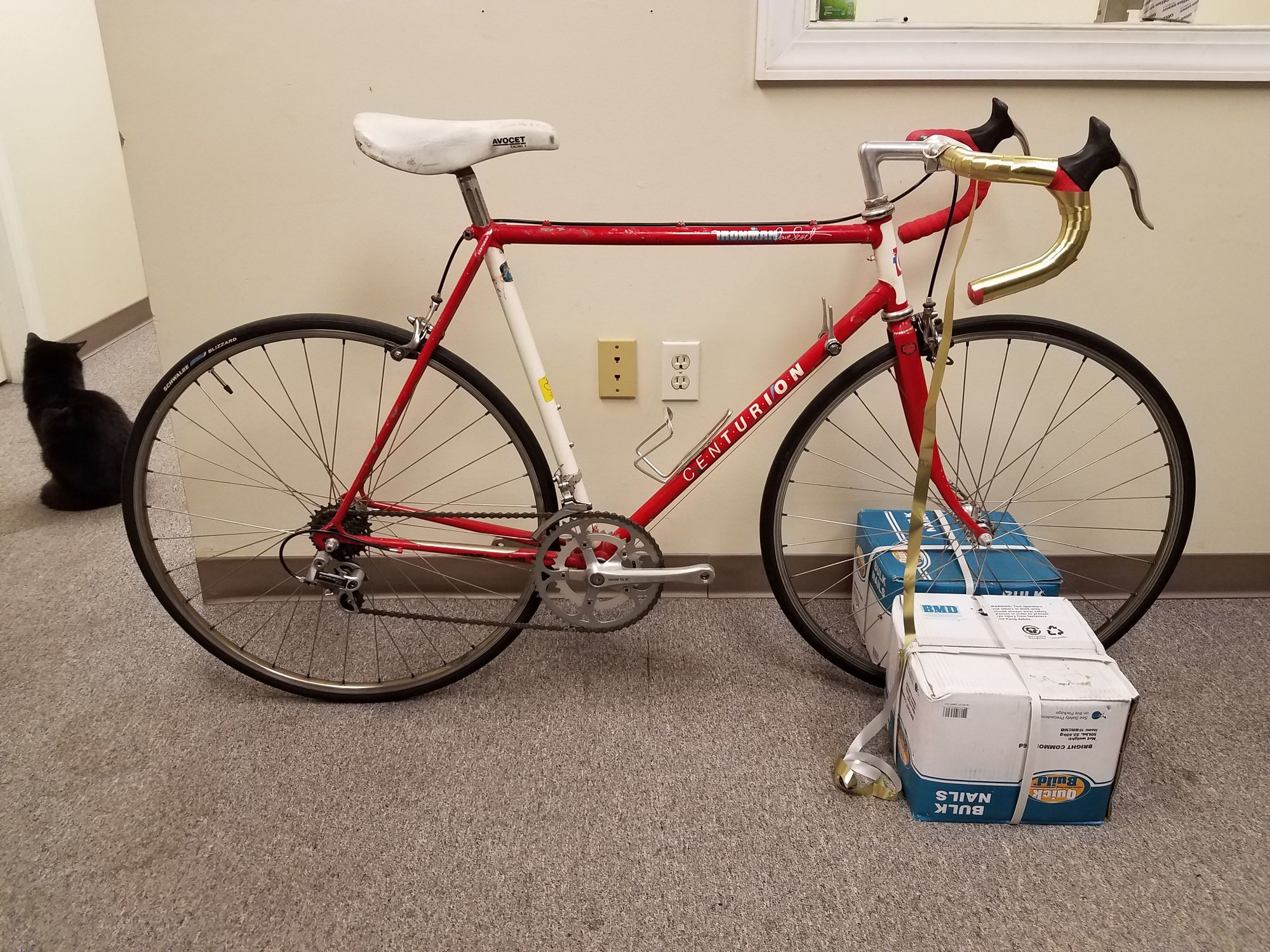

It's been a hectic week, but finally time for another episode of Ironman Nation How to mechanic. This episode we'll get back to the basics for the noobs. We'll overhaul/service the Bottom Bracket and the headset. Here is a pic of our project. Notice the freshly repositioned handlebars.
Speaking of handlebars, it appears I have a chunk out of the tape below the brakes. It might be time for some new tape.
If you are looking for new tape and find an exotic color or pattern you think might work, let me show you a quick money saving tip.

Before you take a chance and order the new stuff, make a mockup first. Find some party/wrapping ribbon similar to the tape you are thinking about.
Temporarily put it on with some tape and see what it looks like. Better to waste a buck or two before you order the tape.

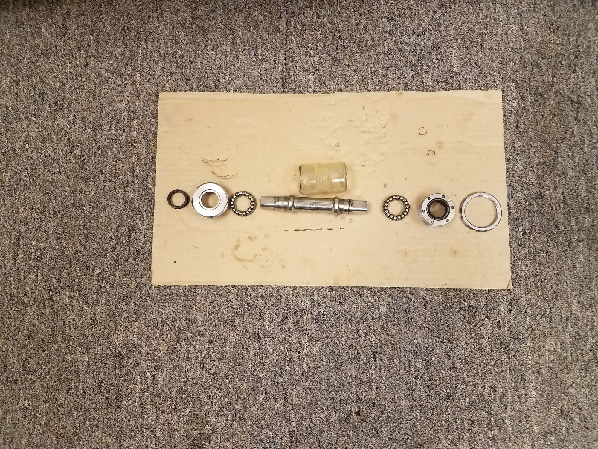

Old 03-27-20, 07:12 PM
  #8305
seypat
Posts: 8,516
Mentioned: 69 Post(s)
Quoted: 3241 Post(s)
Liked 2,512 Times in 1,510 Posts
How to mechanic BB service continued.
The tools to remove the cups are:
A lock ring tool and a cup spanner wrench.
You don't need to remove the fixed cup. They can be stubborn. If you decide to remove it, you will need a big a$$ adjustable wrench also. The best way to remove it however, is with a shop vise.
seypat is online now
Put on some gloves because your hands will get greasy. Use the lock ring tool to loosen the ring, then take it off. Lefty loosey. Next, use the spanner wrench to remove the adjustable cup. Lefty loosey also. Before you take it out, get something to catch any loose parts. Remove it and the spindle as well.
Old 03-27-20, 07:34 PM
  #8308
seypat
Posts: 8,516
Let's see what was in there. Loose balls. That is good setup for a bike, but not a positive situation for an aging male. If you have this situation, I suggest switching from boxers to briefs or boxer briefs. That will provide some support/stability and tighten things up a bit.
Manufacturers started using caged bearings as a cost cutting and assembly reduction process. You can find the correct size bearing for your model at Velobase.
Next you need to clean the cup/cups, spindle and bearings. Then inspect the bearing races for pitting. You can look up images for pitting. Normally I would take out the fixed cup because it is harder getting loose bearings back in when it is still in. This one didn't budge, so I left it in. Use whatever means you have to get it clean. Pipe cleaner, tooth brush, whatever.
Old 03-27-20, 07:59 PM
  #8310
seypat
Posts: 8,516
If everything is in good shape, time to reinstall. You can use the old bearing or put in some new ones. Bearings are cheap. Might as well put some new ones in. Again, check Velobase for correct bearing size and the number on each side. The rule of thumb is fill the race with bearings until there is not any room for another, then take one out. They must have some room when they connect with the spindle. Put some grease in the races before you put the bearings in.
Old 03-27-20, 08:11 PM
  #8311
seypat
Posts: 8,516
Now to the fixed cup. If the fixed cup is on the bicycle, getting the loose bearings back in is no easy task. Here is how to do it. Lay the bike on it's drive side with the open/adjustable side up. Use a plastic knife or something and grease up the bearing race going in through the top opening. Take the bearings one at a time and push them up through the opening in the fixed cup into the greasy bearing race. Use a screwdriver in the other hand from the top to help guide them into the race. For caged bearings, put them in from the top. Note the correct alignment.
Once the fixed cup bearings are in, put the spindle in. Install it with the longer side(drive side) going down into the fixed cup. Hold the spindle in place and stand the bike up again. Hold the spindle from the drive side. Take the adjustable cup with bearings and slide over the spindle. Screw in the adjustable cup. Righty tighty. MAKE SURE YOU DO NOT CROSS THREAD THE CUP. There should be no resistance. DO NOT FORCE THE CUP. If there is resistance, back out and check the threads. Screw it in by hand as far as you can. Then put the spanner on. Keep turning until you feel some resistance. Put the lock ring on and hand tighten. Once you feel some resistance, check the spindle. There should be no play. Now slip the crankarm on. Spin it to see that it spins freely. You're looking for the point that is not loose, but not dragging either. When you find it, take crank arm off. Hold the spanner with one hand and fully tighten the lock ring with the other. Put the crank arm back on and check for the magic place again. Adjust if necessary.

How to BB service continued.
Reinstall your crank/arms and you are done! That was time consuming. I believe I will do the headset in the morning. Questions or comments? Please list them so we can go over them.
