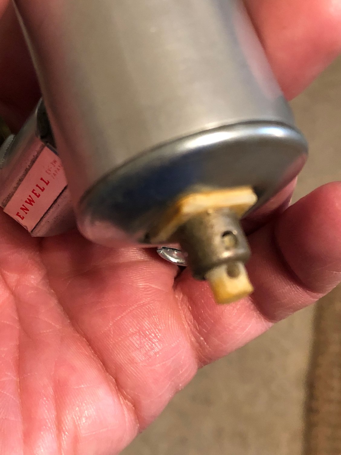

I've got an old Schwinn dynamo light set in my parts box, and maybe it can be a helpful reference.
It uses the dynamo body, brackets, and the bike frame for the "ground" connection, which is a potential source of troubles.
The other connection is through a weird terminal in the bottom of the dynamo that is shaped like a cup, and relies on shoving in wire and hoping it contacts it. I think perhaps you are supposed to wrap the bare copper wire around the little post in the plastic plug that gets shoved into the cup? As someone who has worked with electrical connectors for decades, it is hard to think of a worse way to make a connection.
a couple of pics....
the light set:
the bottom of the dynamo, where the connection is made:
If you've got a connection like this, check it and see what can be done to minimize the effects of oxidation or corrosion, and perhaps see if the wires can be made to fit tightly against the metal terminal?
Steve in Peoria
This has a slightly different but possibly better connection arrangement. I agree that overall though, it is not an optimal contact arrangement. I have about 36 years of electrical experience as well which is why I'm bothered that something as simple as this is kicking my keister. If I find time this weekend, I'm going to do some more experimentation which may involve spinning it with a cordless drill to RPMs greater than this old Breeze will ever give it and see what happens.

Some dynamos have been low power, such as the Sturmey-Archer dyno-hub. It was only rated at 1.5 watts, IIRC. I think it was still intended to be 6VAC when connected to the intended bulbs.
Sturmey-Archer hub magnetos are of course the 'Dynohub (tm)'. The classic GH6 was produced from 1946 through 1984. They were rated at 6V and until the early 1970s 2W, afterward 1.8W. Modern Dynohubs like the HDS12 are 6V, 2.4 or 3W.
Fun fact: Some modern Shimano hub dynamos, like the S701, are rated at 6V, 1.5W.
