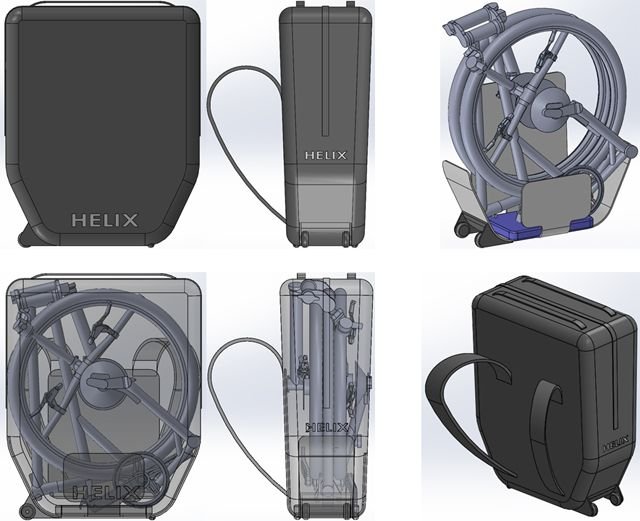

Air Travel: Has anyone tried traveling by commercial airliner with their Helix? Experience packing the bike into a hard suitcase?
Now that I've placed my order I've moved onto contemplating usage while waiting for delivery. (and adding options... gives me something else to do during the pandemic)
The order I've placed is for the standard model (rather than the lightweight one). I chose the 11 speed Derailleur, thinking of how much I struggled riding uphill when last I rode.
I haven't seen anyone post anything on the Helix forum about traveling by air with one. Some have tried to find something suitable but nothing seems to come in under the 62" linear inch limit for standard suitcases without additional fees. Helix in the past had posted a CAD design of a Helix suitcase which basically cut the corners around the wheels which I think is how you will get to 62".

I'm a kickstarter backer and after 5 years of waiting, I think I will be selling my pledge and moving on as I no longer need this bike and travel with my Brompton instead.
As you can see, by angling the corners around the wheels, and that's how you get to 62" is my guess.
When do you expect to receive your bike?
Bike is scheduled for June.
Nice mock-up: I'd hate to carry that thing on my back for any distance!

This is just a mock up and who knows what the final product will look like, but the point is I think angling the corners of this custom case is how you get to 62 linear inches, so I don't think it will fit in an off the shelf suitcase and still be within the required measurement.
I'm sure the Helix with it's bigger wheels rides better than the Brompton, but I have taken several trips to the Netherlands, France, UK and Spain with my Brompton and it has served me well. I was hoping to do the same with the Helix, but I have no idea when I will have it, so I might as well sell my pledge.

For daily use of he bike and even for traveling, a front carrier block+front bag like on the Brompton (and now on the Birdy) is really a must have.
For the suitcase and remaining below the 62" linear inch limit, a solution could be to swap the wheels for ETRTO406 what would also solve the tire problem (besides the Riteway only available in Japan, I do not see any road tire in the list, only cyclocross and BMX tires).
