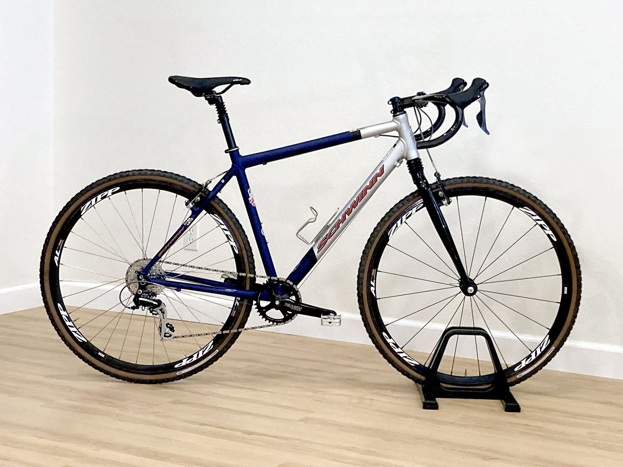

HOT TOTALLY NUDE carbon drop handlebars (no handlebar tape)
Who else is going tape-free in 2020?
(my ultimate gravel build, based on a 2006 Schwinn SuperSport hybrid)

Too late to do anything in 2020.
Looks good though.

I found the single wrap on my drops wasn't enough. Everytime I dropped into them they felt too small. I wrapped them with an inner tube and then put the wrap back on to make them thicker. I need the thicker bars. No way could I go the naked route. But to each his own and glad you like it.

LOL clearly this build took me longer than I realized

I got some rubber slide-on sleeve things on order that I will try out, but for now the bars are tape-free, and I like the look!

Riding tape-free is great, until you start to sweat.

That is an odd build. Carbon bars and fancy wheels on a Schwinn hybrid but it looks like you did a good job on the build. Though I would not want to ride without bar tape. Especially for cyclocross but I wouldn't wrap yet because you might want to add some travel agents for the brakes. Linear pull brakes and short pull levers don't really go well together but hopefully it all works well for you.

] Especially for cyclocross but I wouldn't wrap yet because you might want to add some travel agents for the brakes. Linear pull brakes and short pull levers don't really go well together but hopefully it all works well for you.
This bike already came with mini-v-brakes on it (85mm brake arms), so no travel-agent needed. And I'm on the hoods almost 100% of the time, so I'm thinking of just leaving the handlebar tape off this time.

Ahh yes...looking back on them they do look a bit shorter. I am not used to seeing mini-linis often so it didn't register.
If you are just in the hoods, cut down the bars and save all the weight ; )
Me I couldn't run tapeless bars and wouldn't want to I would at least do some cloth tape or something thin and light just as a little extra protection for the bars and in case I decide to move my hands.

Just wrap the drops then 2 1/2 inches past the hoods.
Aero bar tops are so flattish no need for tape.

Needs one of those super aero bars with the integrated stem.

I was wondering the same thing. The clean look in the OP’s pics is awesome. But that slick CF finish must be slippery when it gets wet...especially if you ride without gloves.
Side question...has anyone ever achieved the same internal routing using traditional aluminum bars...either produced that way, or after-market modification without a significant loss of integrity?

Riding without tape is a personal choice, but you should plug your bar ends as a safety measure. An unplugged bar can be very dangerous in a fall.
