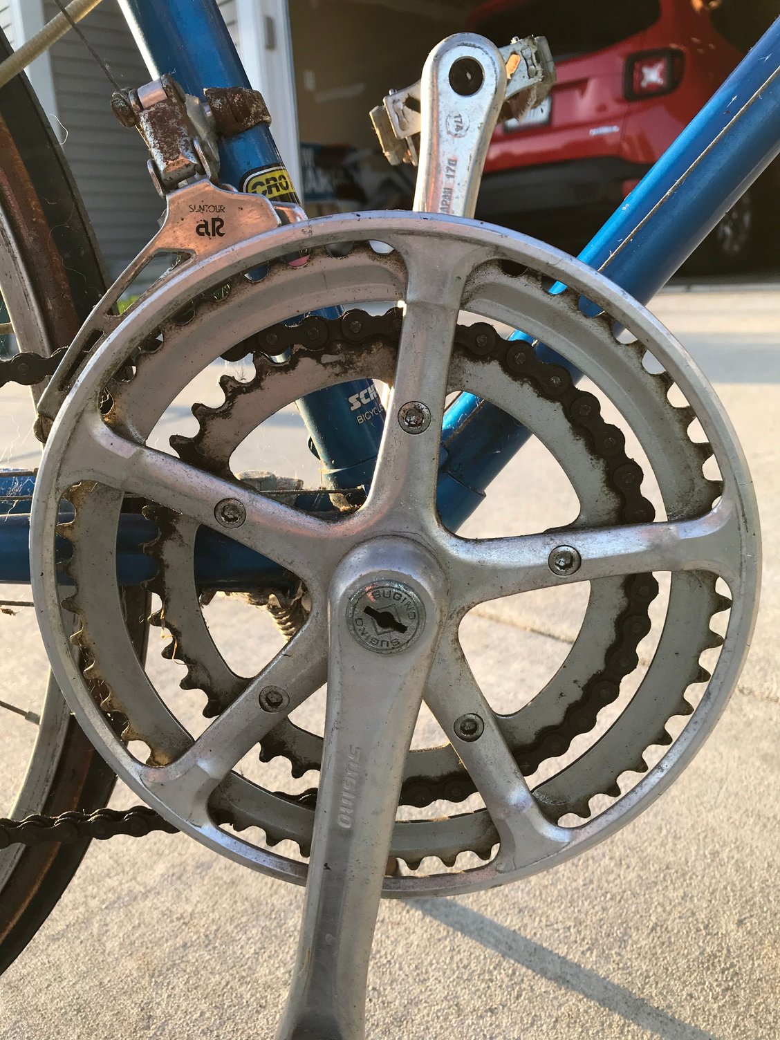

A quick look at the picture of the Sugino crank shows a possible date code (174) embossed on the inside of the crank just below where the axle for the pedal. That may mean it was produced sometime in 1974 since most bike companies didn't stock parts for long. It's a bit confusing because Sugino had so many different ways of dating parts according to this Date of Manufacture of Bicycle Components can be used to date a bike: component dating. If you can find dates on any other part, refer back to this site to figure out roughly when the bike was made. It is in pretty tough shape. I would stick to replacing tires, tubes, cable, and the pedals first before you stick $$$ in a bike with so much rust. Then clean, grease and adjust any bearings you can get to. I would try eBay since you can get some parts easily there that an LBS is unlikely to have in stock.

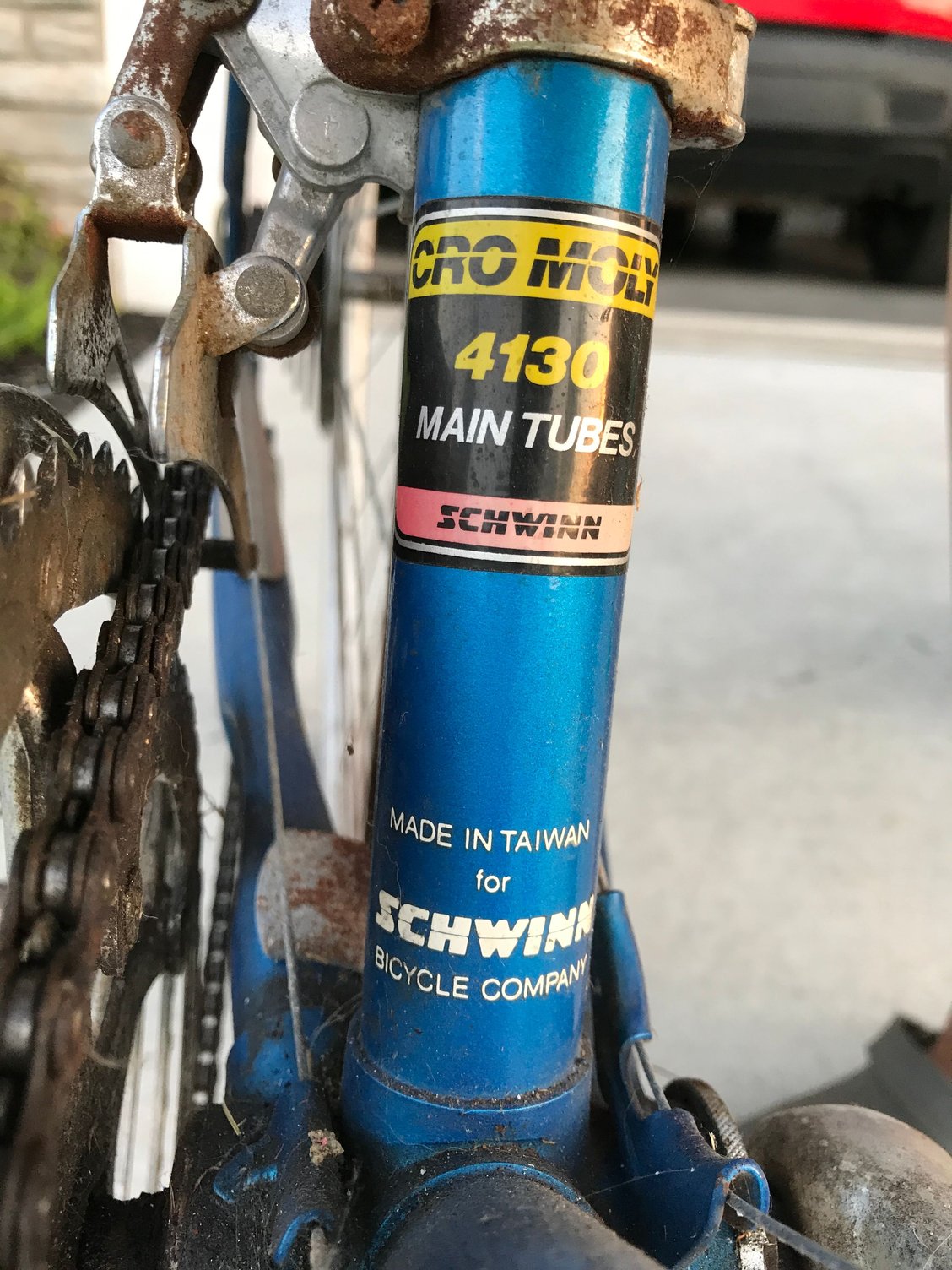

A quick look at the picture of the Sugino crank shows a possible date code (174) embossed on the inside of the crank just below where the axle for the pedal. That may mean it was produced sometime in 1974 since most bike companies didn't stock parts for long. It's a bit confusing because Sugino had so many different ways of dating parts according to this Date of Manufacture of Bicycle Components can be used to date a bike: component dating. .
https://bikehistory.org/bikes/world/#1984-world

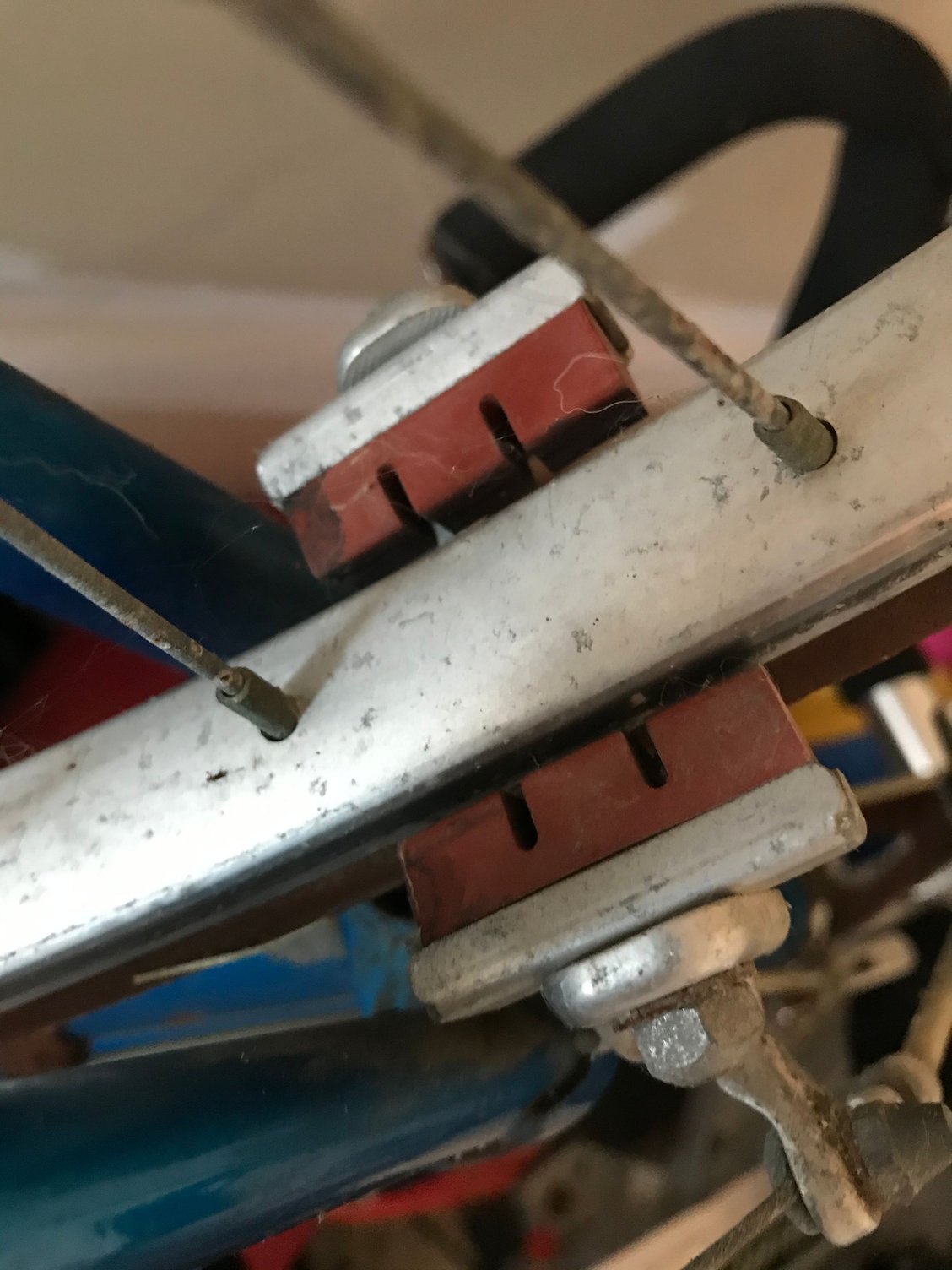

It should be ride-able if you re-lubricate the bearings, derailleurs, and cables. Aluminum rims are a plus. If the wheels are true, that's a big plus. Given the relative lack of wear on the rims and brake pads, it might not have gotten much use before being stored in a dusty garage or shed. Whatever grease Schwinn used lasts a long time, but maybe not that long. My preference when approaching a bike like this is to get it working as-is before deciding what needs to be replaced, if anything. The rubber will have hardened just due to the passage of years. The biggest expense will be new tires, but you might as well ride it gently on the existing tires if possible, to see if the bike is worth keeping. Put a drop of penetrating oil in each spoke nipple, in case truing the wheel is ever in the future.
Any part that is totally unworkable to the point where it has to be replaced, aside from the tires and pads, would surprise me.
I've had great luck with the Jagwire Basics brake pads.

That bike's from the mid '80's. Suntour AR came out in 1982 ish and Taiwan Cro-mo frame is 80's, decal font, as well as 6 speed freewheel scream mid 80's. My guess is 1984.
I think I know nothing.

It is a GIANT bicycle re-badged for Schwinn. It is a decent basic bicycle with SUNTOUR derailleurs front and rear. Beyond the closure of Chicago factory, Schwinn increasingly turned to importing much more. Schwinn's contracts with GIANT propelled GIANT into a major player in the bicycle industry such that they soon overtook Schwinn in both status and importance.
Your GIANT built Schwinn is not quite as simple as say a VARSITY-CONTINENTAL-SUBURBAN-COLLEGIATE-SUPER SPORT that has the one-piece forged steel ASHTABULA crank which any 11 year old kid can service with a large Crescent wrench and a large Flathead screwdriver.
Your "GIANT" is a fine bicycle and it will be about the same as servicing most any Japanese or Taiwanese bicycle from the late seventies through the mid eighties.
It is a good basic bicycle. It might have less perceived prestige than say a RALEIGH or a PEUGEOT but at least as good as their compareable offerings of that time, if not better. You will find that it will be a nice rider that will serve you well. Don't listen to those that say that it isn't high-line enough to bother with. Yes, perhaps if your only aim is to build a really super-light racing bicycle, but otherwise don't worry because that WORLD SPORT (GIANT) will easily keep up with the B - group Riding Group even if you have never ridden and are the weakest rider among that B-group. Once serviced, and fitted with new cables, tires, tubes, brake pads and grease, that World Sport will be durable enough that you will not need for any service work other than brake pads, tire tubes & tires for probably three to four years, this assumes that you ride 1000 miles per year. Basic bicycles might not have the lightest weight components but the rugged durability is an acceptable trade-off for the typical bicycle rider. Now if you're wanting to be like Lance, such a basic bicycle is like comparing a stock 2020 Honda Accord to the 2020 HONDA powered Indy 500 Race Winner. You can make basic upgrades easily if you wish, given that there is a lot of stuff that has been refined in the past forty years than can easily interchange & swap with your existing equipment. Just don't attempt to make a competitive racer out of it. Just because there are people that race old PINTOS and old Corollas on dirt tracks, and even sometimes in drag racing too, does not mean that those are the best choice for a racing platform, given the multitude of better choices that were developed later..

It is a GIANT bicycle re-badged for Schwinn. It is a decent basic bicycle with SUNTOUR derailleurs front and rear. Beyond the closure of Chicago factory, Schwinn increasingly turned to importing much more. Schwinn's contracts with GIANT propelled GIANT into a major player in the bicycle industry such that they soon overtook Schwinn in both status and importance.....................................
One thing that you might want to consider as an upgrade and I would put this off for consideration until after you get it running right would be quick release for the wheels. This will involve new axles and skewers,
