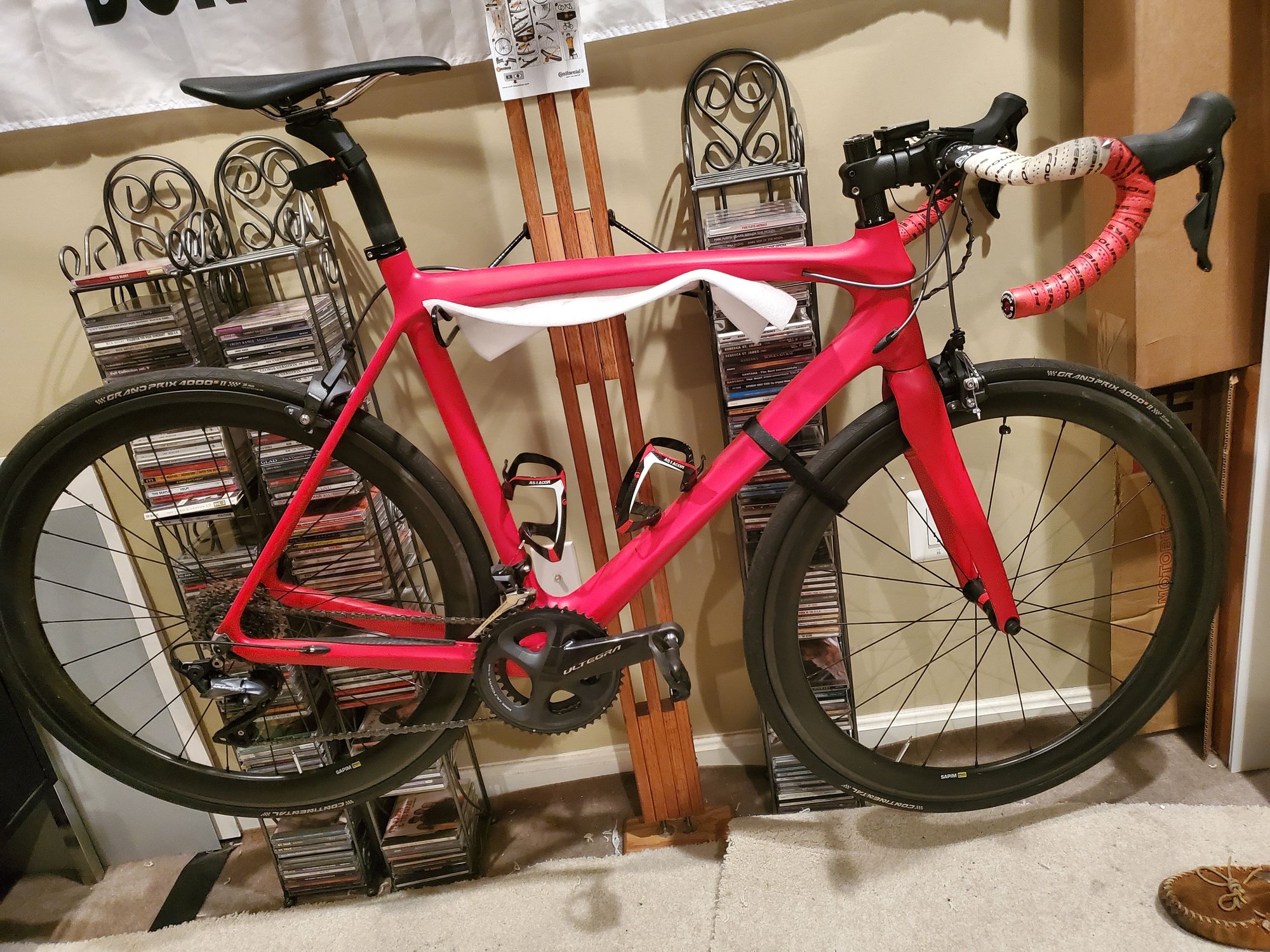

I purchased the Chinese frame from a friend for $180 (I think). Ultegra R8000 throughout. Wheelset is DT Swiss 240s laced to carbon 50s. I think that my total was $1800. It weighs 17 pounds and rides really nicely. Climbs well. Descends well. I didn't need to build it. I simply felt like it. Glad that I did.
