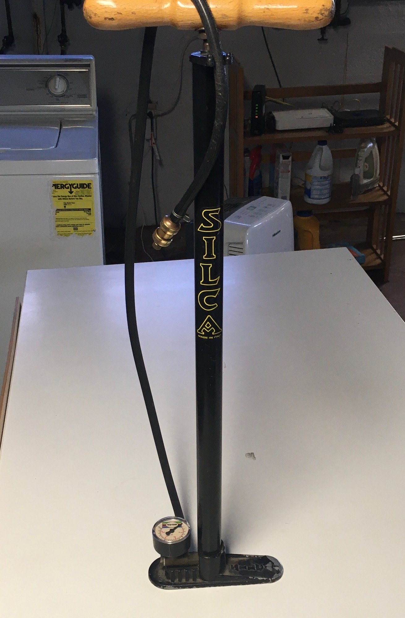

I bought mine in the late 80's if I remember right. Its my one and only and I use it about once a week. I'm probably going to jinx myself here but I've never serviced it. The only thing I'm not sure if it works properly is the gauge.
I've serviced a lot of these actually. The base there will have a o-ring between the casting and the cylinder that can age poorly, and then there is a leather plunge washer that can age out. That's about it. It will need an oiling or waxing inside the cylinder or a replacement tube at times but otherwise it's a fairly simple repair. I'm sure your gauge is fine but if not the Silva website has all the repair parts including gauges available. It's a brilliant design and does let you dial in on psi wanted.
I just don't like the brass chuck any more. My hands from arthritis can struggle with the attachment to the presta valve.
I hear you about the arthritis! I've been able to use it still even with my arthritis. I'm not sure if the gauge is bad or not. A friend suggested that I should be careful when filling tires because he said he thought it wasn't accurate. I have a high pressure gauge and should try to "calibrate" it but it seems to be working.

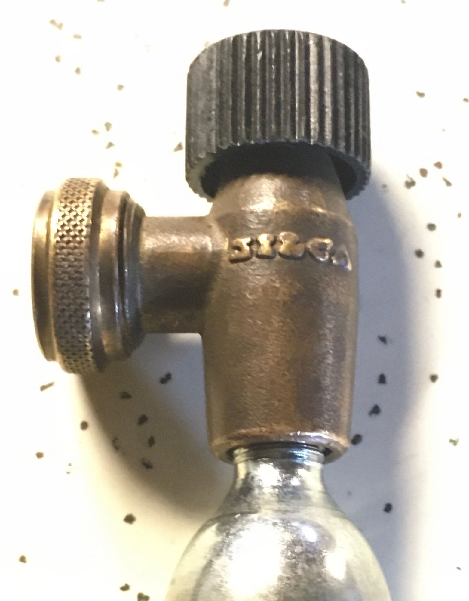

I also have a Silca CO2 head. I've also had this for years but I haven't used it a lot.
