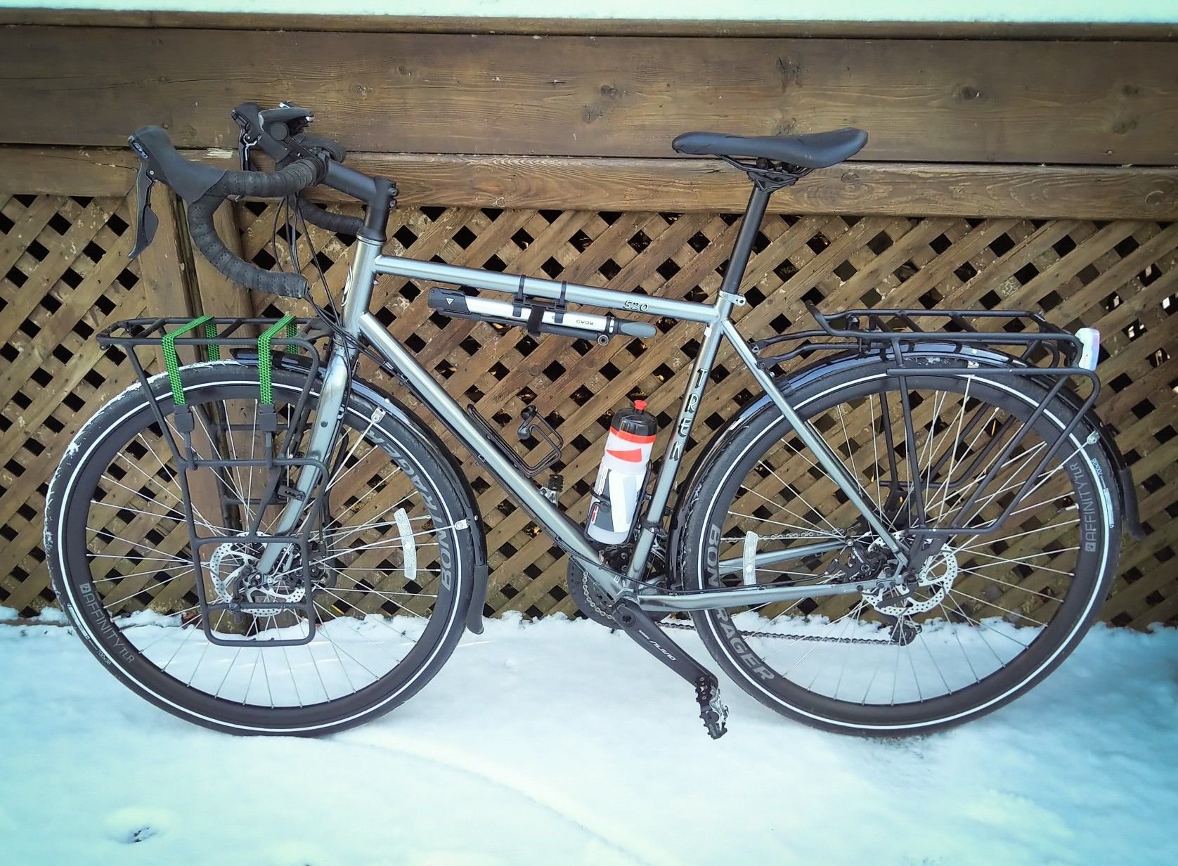

Wiggle, you must have toe strike no? Certainly looks like you would, crank not positioned properly in photo to tell.
and some people have no problem with toe strike, others fall over all over the place. A little isn't a problem, but lots can damage a front fender. Done it myself.

^ Yes, hella toe overlap.
seeker333 is offline

Yes I do have toe-strike. I've never had a problem with it but it's there. Don't think I've ever owned a bike that doesn't have it.
For reference that's a size 57 frame.
