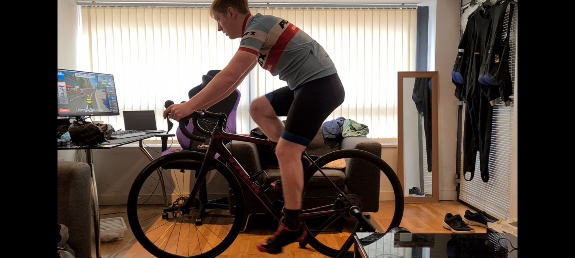

Video with saddle 1cm power, sorry can only do one side as GF wants me to go to town.
Saddle wise I don't feel I'm sat too far back I think I've just got a fat arse.
However 1cm lower saddle would mean reach needs lengthen as seat will need to go back will it not? Then bars down 1cm so possibly shorter stem?
How does 1cm lower look? It doesn't feel much different on the trainer but my left leg seemed to not be pointing to the top tube it seems

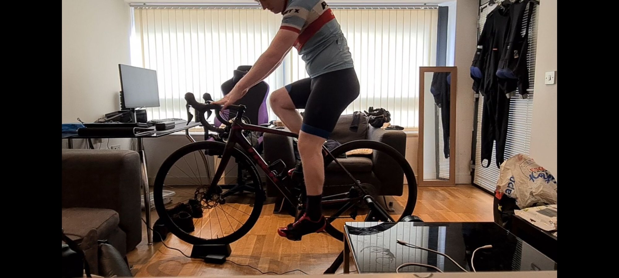

Saddle 1cm lower (pc screen on is the pic 1cm higher and off is today 1cm lower)
Here is saddle 1.5cm lower (really started to feel not keen at this height)
Height 1.5cm lower front view ( knee position very much same as 1cm lower)

From the right side view it seems my right leg is too low?

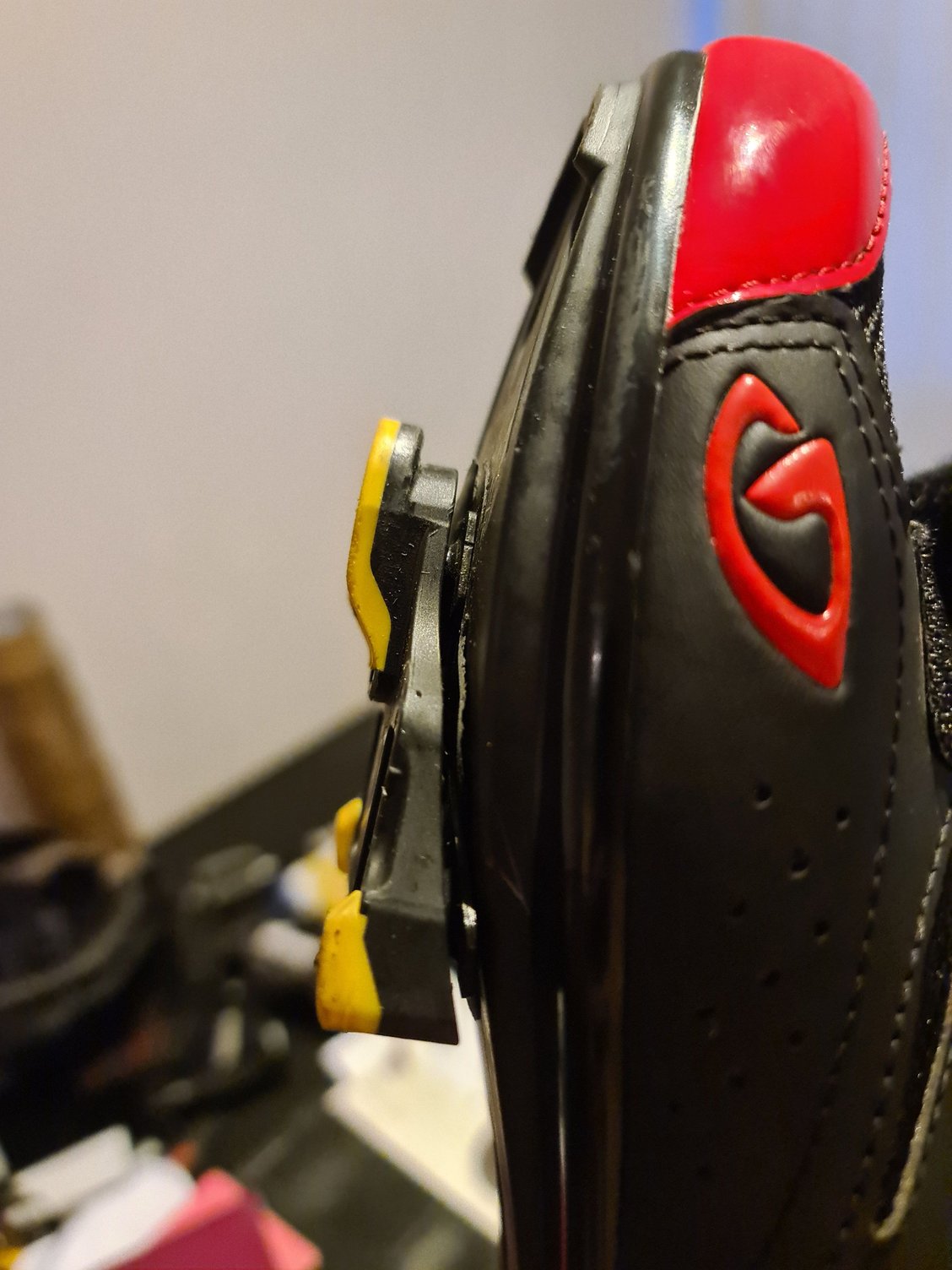

After riding, the left leg is still actually just as bad pointing in, going to try slanted wedge again.
2 pics below at 1cm lower, saddle slightly tilted back up and a botched attempt at a shim on the left leg, equates to between 3 to 5mm stack on the shims as there is a slight tilt.
The picture with the monitor on is before any adjustments were made and was at 1cm higher.

The shimming that I ghetto botched defenitly makes my leg feel a bit better in respect to power delivery especially on an incline. It does however make me feel like I partially slip on my right side also from time to time.
This slipping is still occuring and even re adjusting the saddle to the cm higher position doesn't change the effect.
The ghetto botched shim is 5mm one side and around 3.5mm the other as it's slightly tilted.

The front feels wobbly, it's an 11cm stem, maybe that's why?
I measured my inseam the best I could and it came out as 81.8 but looking at the documentation from a bike fit in 2015 they had me at 83cm inseam and I'd say their attempt would be more accurate than mine.
moved the saddle down to 72.5 and test as since moving cleats from 5 to 3 ( approc 4mm) the saddle feels higher.

You need to stop chasing power at this point and make a significant commitment to smoothing out your power delivery and balancing yourself.
This won't be easy or happen straight away. It will take commitment to not go flat out everywhere. I've definitely been there.
I'd move the saddle back on the rails for the time being and just work at being smooth and it will take work to get there.

Best I can do is 66.5cm reach though with 10cm stem and saddle as far back as it'll go.
Unless I just move it back 1cm.
I'm not chasing power as such I just observed a good effort testing it as when I take it for a quick test ride here I'm going up a hill.
I'm struggling to work out how this balance is going to be fixed as just riding isn't fixing it, I'm getting upper body paids from constantly having to stablise myself it's like I myself am swerving to stablise the bike.

I'm tempted to move it as far back but to try a 10cm stem as opposed to the 11 I have on. My arms do feels at a better angle currently (66cm reach)

I'm referring to the fact I feel I may be too stretched so felt 1cm less reach just felt more "correct" to me.

You said above that you moved the saddle forwards from 7cm setback to 5cm setback, and now your thinking about shortening the stem. Your scrunching up your position. Moving the saddle forwards is usually counterproductive in my experience as it puts more weight on your hands/shoulders. I'd move your saddle back to 7cm again.

Right so thinking no point bothering with anything else until Physio has looked at me and bike fit.
Went for a ride, unstable as hell, totally miffed.
I then just thought, it feels like my left foot is in a different place over the pedal than my right, however they're exactly the same.
My saddle is at 72.5mm now, the cleats moved as far back as they'll go, surprisingly that didn't feel weird.
Hoiwever I thought, perhaps if there is some something giving the effect of shorter left leg, moving the cleats forward will effectively lower the saddle for the left side.
So I've moved the left side cleat to where I oringnally had it, left the right shoe as is, the left cleat is 6mm further forward than my right.
What I noticed when I did a 37 mile bike ride today is better stability slowing down, better acceleration, no swerving of the bike and smoother pedaling and ability to keep a more consistent power reading rather than it jumping up and down.
It's still far from perfect but it seems better than at any point this year.
I'm not sure if I should move the cleat even further to see if it adds any stability or to add a shim, or just persevere until July 29th as it is.
