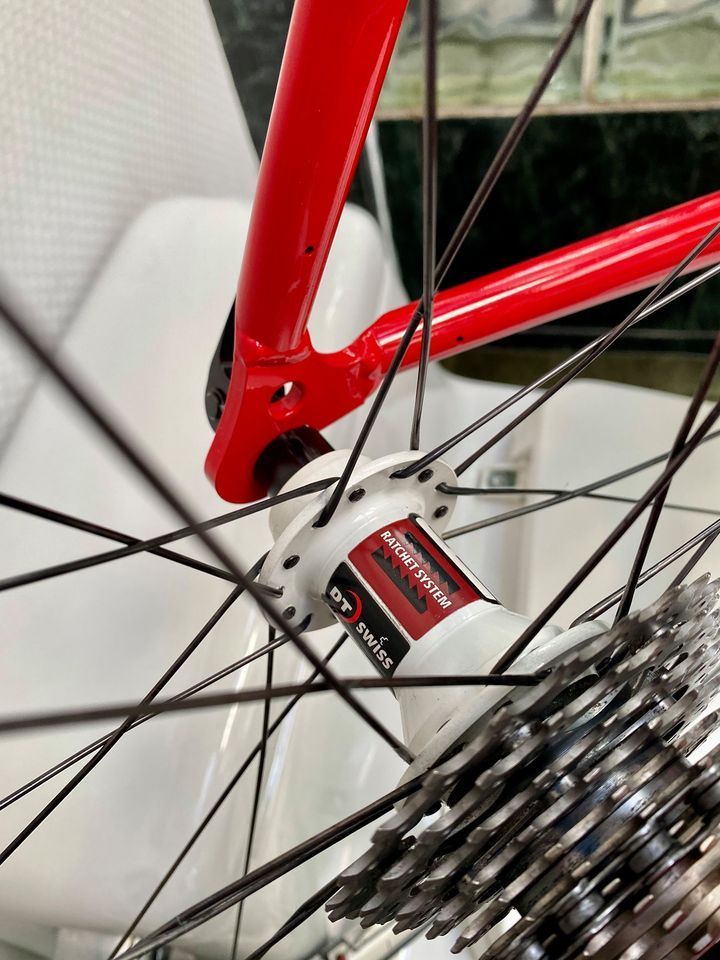

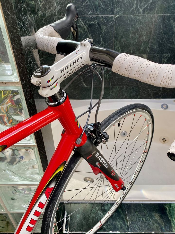

I agree that in most cases titanium is obvious.
but take the example of this Aquila bike. Aquila is the private label brand of a local bike shop here and they imported and labelled everything over the years.
they have a Lot of aluminum bikes out in the world too.
would you think this one (attached) was Aluminum or Titanium?
but turn the situation around. imagine someone not very familiar with bikes were selling a bike with what they assumed was an aluminum frame (maybe having tested with a magnet). and you were buying and supected it was titanium. that is a situation where it would be handy to be able to tell the difference between the two.

I think the most difficult frames to tell would be if they had cosmetic welds like a Cannondale and some Ti builders that were ground, post-weld.

Definitely looks like aluminum welds to me, although as guy153 says, they are smaller than normal for aluminum. I think the shape of the welds says aluminum too. Even production Ti bikes I have seen have a concave shape to the welds.
The thing that really gives it away is the shaped headtube. Very few production builders are going to the expense of such a headtube on a Ti bike

1. I'm assuming this is mainly academic because there are accessible non-painted surfaces on most frames even without paint chips. The inside of the seat tube is an easy one to get to, but the insides of any threaded surfaces such as the BB or derailer hanger are others.
2. I'm leaning aluminum on the pictured bike above for the reasons already stated.
