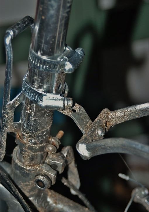

Consider using rubber-covered p clamps to attach a rack to the forks. There is little weight on those connections, so the p clamps work well. You can find them at any decent hardware store.

I use one of these (I think it is called a brake bridge adapter):

really? even tho you have the seat stay braze-ons for the rack?

don't think it's the rack you need to shop for so much as a way to attach it. something like this is being talked about in another thread
https://www.amazon.com/M-Wave-34-9-S...ateway&sr=8-39
https://www.amazon.com/Axiom-Trekk-M...ateway&sr=8-35
https://www.amazon.com/Sunlite-Alloy...gateway&sr=8-6

https://www.giant-bicycles.com/us/bikes-contend
you can buy a different seat post band clamp with additional threaded holes for the rack struts
and use The QR Skewer itself for the bottom mount..
Yeah, unfortunately Salsa kind of screwed up the placement of those braze-ons, and the brake caliper blocks one of the rack stays.
Thats probably the way I will go.
