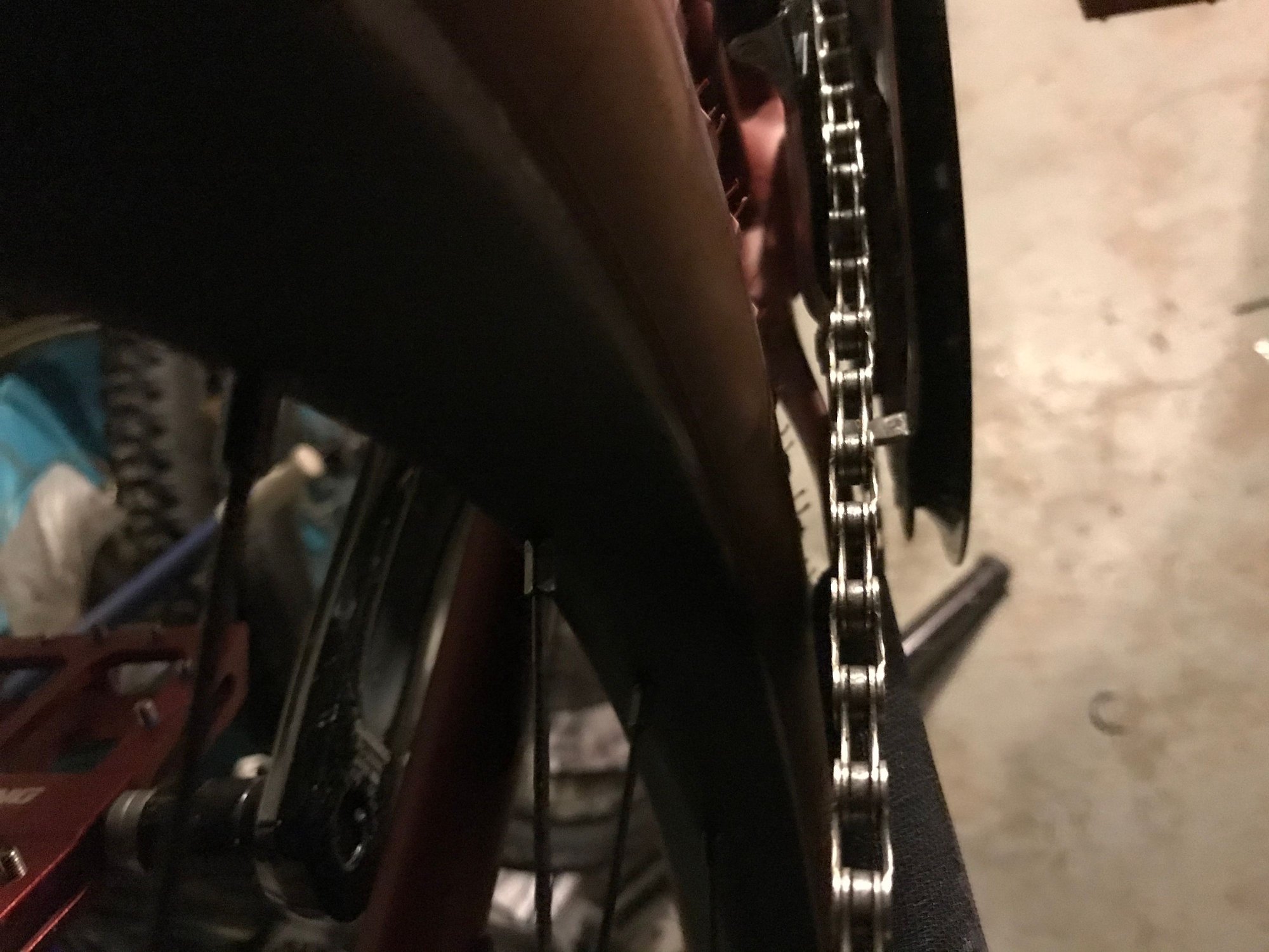

Update: got my 650b wheels in. They’re 30mm wide internally and the 1.9 Gravelking SKs measures around 52mm at 40-45PSI. Should probably stretch a bit but even so the clearance is phenomenal.

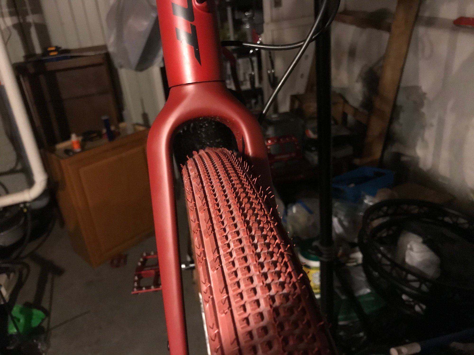

So I did some more tire testing however this time I finally decided to test my 29 x 1.9” Specialized Ground control tires on the stock rims. Here are the results:
So they fit. They measure up to 47mm on these rims which is basically Road Plus on a 700c rim. The clearance is very similar to when I’m running 650b x 50mm tires so I’m comfortable with it. The only issue is that it’s close to the derailleur when it’s shifted to the large chainring, however for me this won’t be an issue since I’m going 1x anyway 😬
