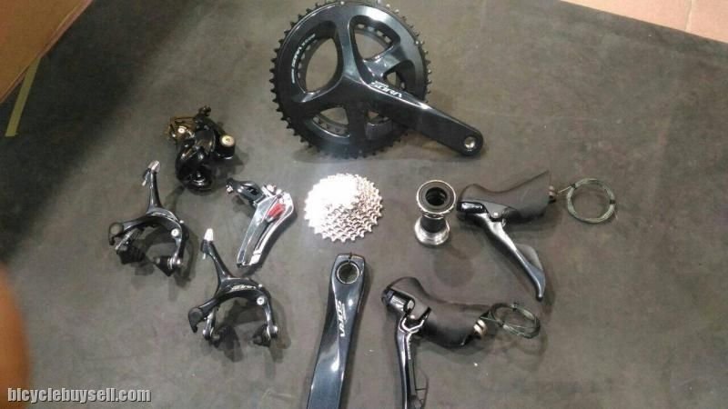

It makes less sense now more than ever. The newer Tiagra and even Sora stuff look very 105-ish compared to a few years ago.
This is Sora R3000 9 speed
