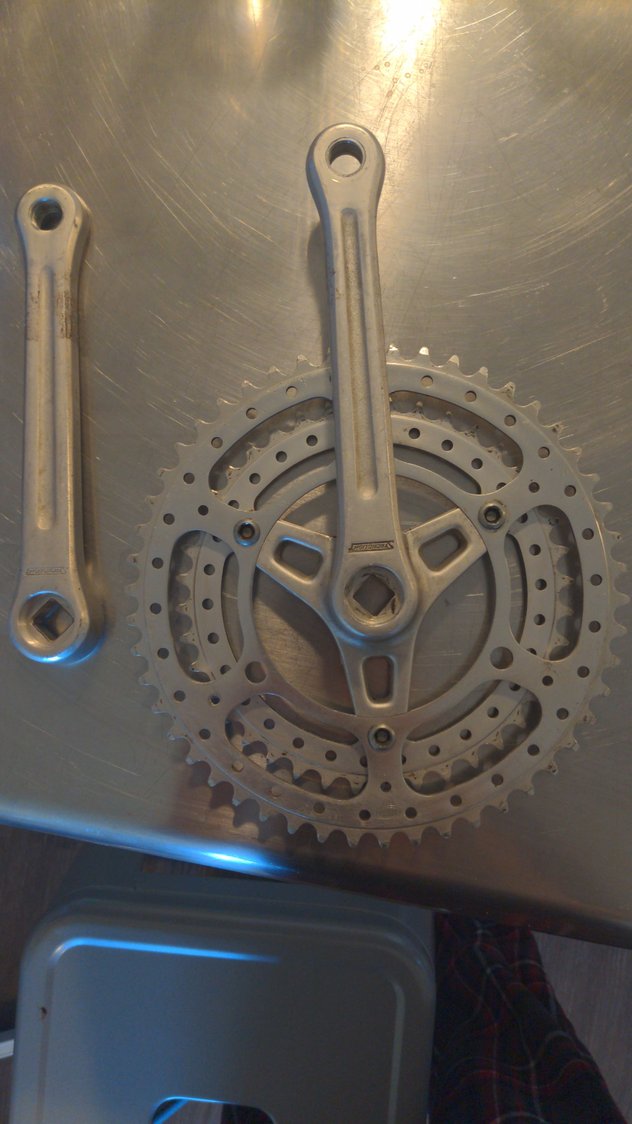

Going to start this project pretty soon. I am conflicted on the direction I want to take it. I was initially going to keep it mostly period correct and French but I am second guessing that. For one, parts can be pricey and I already have enough stuff around to build it; it will just be mismatched. I ordered some wheels off eBay last night. They aren't necessarily what I wanted but I have a budget I am trying to stick to and they came with tires, a 6 spd freewheel, and Shimano 600 hubs. I was given a Swiss bb which works pretty well with the Stronglight cranks I have, though they sit a little inboard there is more than enough clearance at the rings so they won't rub the frame. I will give it a shot and see if I need to find another.
One hang up is French thread pedals are rather pricey. I was looking at taps to modify them to 9/16" but the price is similar between the tools and the pedals so I haven't made a decision yet.

Get them tapped at a shop, unless you plan on doing more.

Yeah, that's what I was thinking. Honestly, I will probably just end up buying the pedals.

Are the pedals or cranks marked 14mm x 1.25 ??? My 1983 PSV-10 has British threaded pedals.
Note the only the 3 main tubes on your frame are Reynolds 531. The forks and rear stays are standard Peugeot tubing which was reasonably light so on a frame that size shouldn't affect the ride very much.
It should take a 26.4mm seat post and probably a 22.0mm metric stem.
Also, the BB is likely to have Swiss metric threads - the fixed cup maybe LH threaded. Note the ring around the outside of the fixed cup.

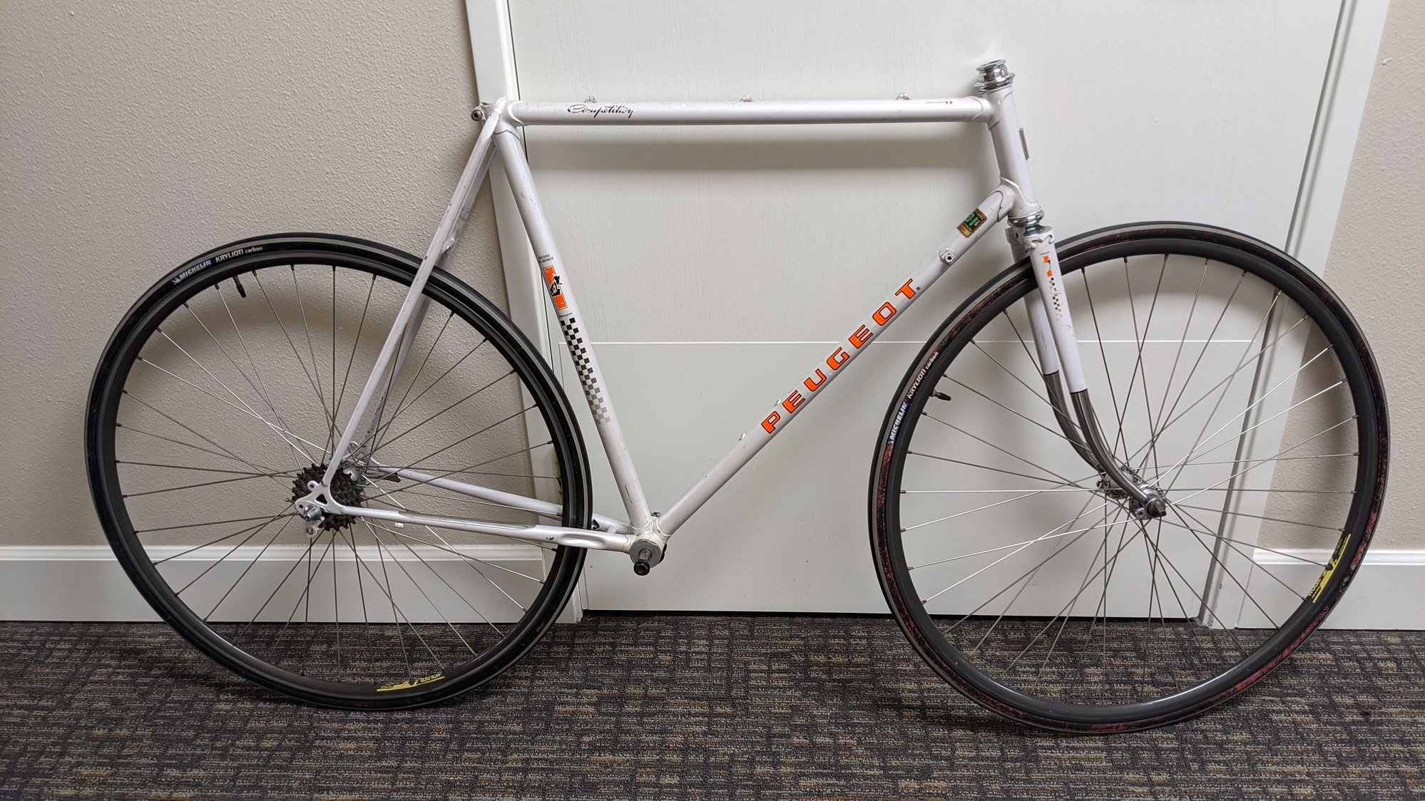

Nice looking bike! I am really excited for the build. Its funny, I had planned on using orange bar tape as well.
To answer, yes the cranks are labeled 24x1.25. I have a the bottom bracket and it is in fact Swiss. The only reason I may need to get another is the spindle is slightly narrow for the cranks. They are slightly inboard but not enough to rub or strike the frame. I figured I would give it a shot before searching for a new one.

I really like this generation of Peugeots with this color scheme. This is a PKN 10 and I had a blue one that I used to ride.
Swiss BBs are tough to find but IRD sells adapter cups for their bottom brackets. These are the least expensive that I know of if buying new. $25 for the cups plus the BB: https://www.interlocracing.com/shop/...cups-pair-2839
That will give you choices in BB length. Alternatively, just find a longer stronglight spindle. eBay France is a good place to hunt for them but I got lucky and picked up on here on the C&V for sale forum.
One neat thing about the simplex drop out is that it is tapped and has a stop so you don't need to run a simplex RD. I have a 1982 Peugeot PXN 10. The RD was shot and I found on eBay the right simplex replacement derailleur but if I had to do it all over again, I'd just run any decent RD that I had on hand as opposed to paying eBay prices for Simplex RDs.

By the way, the easiest (and cheapest) way to solve your problem is to get a 1 mm BB spacer and run it inside the fixed cup. That should fix your problem.

I am not well versed in Peugeots, especially the french ones. Could you find the same crank with English threads?
I'd check with some local shops, even try auto machine shops about simply having your cranks retapped. It is my understnad you need fancy long lead taps to do the job. IIRC they have a long taper reamer on them to clear the old threads and then the section to cut new threads.

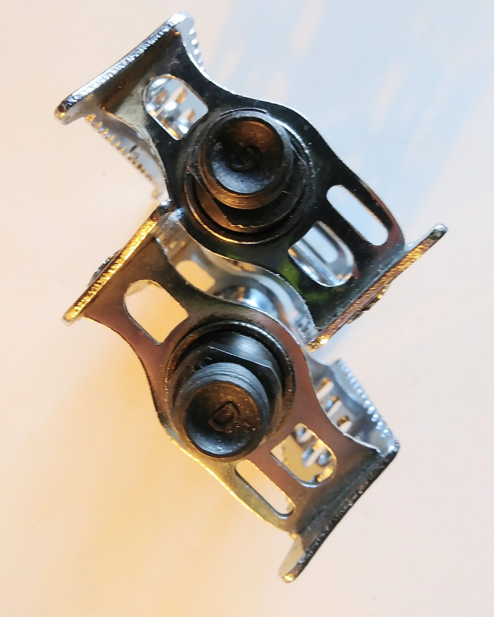

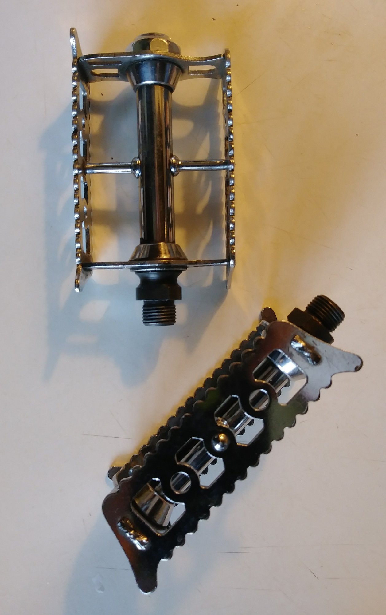

If it helps, I can forward you pair of Lyotard dual platform rat trap French threaded pedals. Not the lightest or racey but will get one pedaling. I picked them up at a swap meet, just for these special moments with a French bike. Lol

The price for a re-tap and the pedals will be similar so its pretty much a matter of deciding if I want more options or a I am cool with just sticking to whatever pair I end up with.
Hey! If I understand correctly you are offering to mail some pedals? That would be awesome! I have never purchased/traded anything with members so if there is some etiquette I am missing I apologize. Feel free to message me so we can work out the details.

Here's the pedals. Very nice and could easily be near new with taking up a bit of cleaning. (D - G French threaded) type 49, I believe. PM me your shipping address.

Quick question: Did you buy the crank used? If so, it would be worthwhile to try and gently thread in a standard set of 9/16 pedals you have lying around, just in case a previous owner modified the threads already. Not everything gets documented or communicated.

Yes, they are used. I attempted to thread a 9/16" pedal when I first started looking at the parts I had and the cranks have not been altered.

They look great! I sent you a message. I made a mistake on the address though. Its 57th st. I doubt the absence of the St would matter but I have had a few problems with mail here. Anyway, thanks again!

Wheels came today. They aren't exactly what I wanted but they aren't so bad. Wolber TX Profil.
The tire sidewalls are a little crunchy.

The inboard crank positioning sounds ideal, so long as the inner chainring isn't actually contacting the chainstay, and as long as the front derailer can still pull the chain down to the small ring with authority.
Such a short chainline is what I always strive for, cuts down noticeably on the friction and noise when when I am using the larger cogs, especially while trying to hold onto speed by staying on the big chainring.
This is where it's at before being tightened at the crank bolt. I feel like I could use another mm or 2. The spindle is 121.5mm and from what I have read I think this specific crank should take a 122, which seems like it would be close enough, but it looks a little tight to me. I will measure the rear chain line today before I make any purchases, though . Spacers may be enough to correct a potential problem.

Seatposts are really hard to measure without a seat tube gauge of some sort. Pretty much all the French Reynolds 531 bikes that I've seen are 26.4
Yeah that's a stronglight touring sport 3 arm crank:
VeloBase.com - Component: Stronglight Touring Sport Bis
Chain rings won't be easy to find for it but it doesn't matter because you have two for it.

How inboard do you run it though? Between rings to center of seat tube is 40mm.
Does your front derailer adequately shift down to the small chainring? If not, then an incremental 1 or 2mm fixed-cup spacer might be all that you need.
For verification, I would get my head in front of the crankset and view rearward. The sides of the big chainring are good sighting planes, from where you can look back to where the big ring sits along the freewheel cogs. I would sight along the inner side of the big ring back to the 3rd-smallest cog of a 6-speed freewheel, what I would call perfect as long as the front derailer can handle it.
