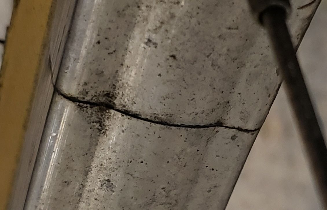

Shimano caliper from rear
shimano caliper from front
Dia Compe from front
Dia Compe from rear
ERTRO wheel
ERTRO seam
ERTRO seam from side
Side seam closer
Dia Compe from rear
ERTRO wheel
ERTRO seam
Side seam closer

Brakes: They sound like cantilevers. XCM was a Suntour model; Suntour was a grouping of several companies, Dia-Compe made the brakes. Many Suntour cantis use a cone wrench for spring tension, others had one screw in one arm to adjust. They're both about the same, either works. Koolstop pads for either (RIP Richard Everett) and run the Diacompe cable hanger instead of the Shimano fixed rod for either.
Cassette: Suntour AP (Accushift Plus) and Shimano FH-HGXX (HyperGlide) are cassettes, not freewheels. Suntour cassettes are hard to get, so I would use a Shimano hub. What shifters are you using?
Edit: the bottom rim is a nicer rim, hopefully it has the shimano freehub laced to it. They use pinned connections, which is a very basic connection. Mavic's welded and machined SUP would come later and on higher end rims.

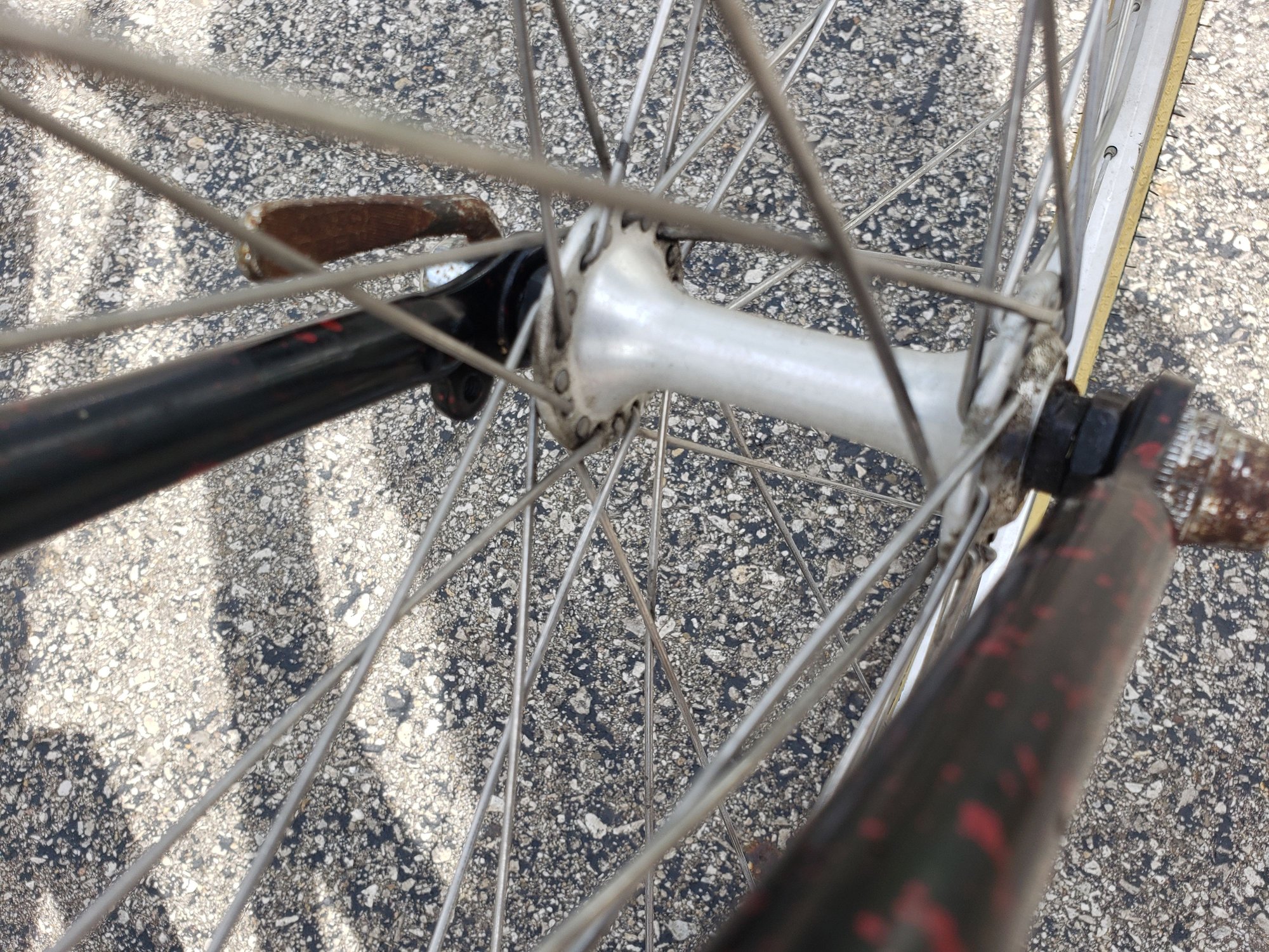

Here are some more pics
This is the hub that came on the Via Carisma. Shimano maybe?
This is the Carisma after strip down. It has the freewheel set that came off an Activa Trail that I'm selling once equipment is sorted
More pics
Activa Trail I'm selling and its wearing rje wheels that came on the Carisma
joytech front originally on Carisma
ETRTO rear wheel from the Carisma with the freehub and hyperglide cassette

The FH-HG20 hub is definitely a Shimano hub, yes. I like their part number syntax...the first two letters before the dash signify the parts family. FH = Free Hub. RD = Rear Derailleur. Etc. The alphanumeric after the dash usually indicates the "line" or "group" of the parts (although the syntax on the right side of the dash is definitely looser). They used to be more consistent (like RD-MC31 or FH-HG20), but this has grown over time (to numbers like FD-M310 and RD-M4000, etc.).
