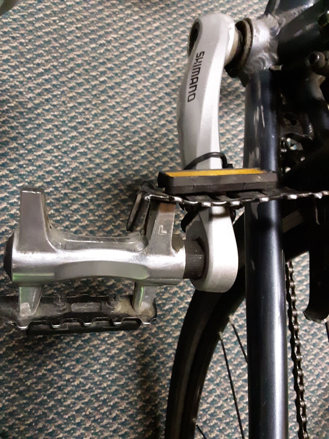

Considering going with a little more sturdy pedals, as my last set , one came apart a bit around the outer frame on the front partially due to not using a step ladder for mounting/dismounting from a bike on a trainer. I honestly am not sure if the extra money is worth it for pedals in the $30-$60 range (compared to a more basic platform pedal that runs about $20 at MSRP, as my knowledge is not high on bicycles/components.

2 pics of the same L pedal that gave out for visual reference:
Left pedal that gave out after about estimated 4k-7k miles
