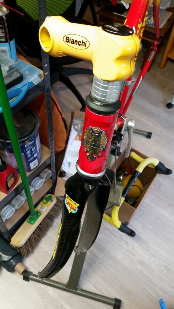

Fixed now. Easier done than said, really.
- heat it up a bit w/a hairdryer, use some dental floss and swipe down the inside of the badge, clean it up.
- use some tape top & bottom to mark the vertical
- spray adhesive on, wait a couple mins to get tacky, then stick it.
- tape it down, bc it wanted to twist... the badge was warped from being wrong so long.
Bc the badge is a bit warped, I think this is as good as it gets. It's shifted 2-3mm from where it was - very noticeably off-center before, now it's maybe 0.5mm off only if you look very closely.

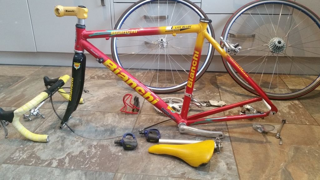

It's hard to tell because in both pictures because the Bianchi head tube is not a straight on shot . I always tell myself don't point it out and they will not notice , but they do .

Why do you post pictures with the forks turned sideways and the steering column turned.?? I can't tell if it's passable or not the way everything is misaligned.?? Whatevah..... Take a picture straight on so that we can see the result.

I'll get the DSLR out shortly.

It's still off enough to annoy me. Not as bad as it was (not by a long shot), but I'm gonna end up re-sticking it again.

Oh, I just saw your picture.... I think it's good. I see that it's not perfect but man, close enough by my eye. If anyone were to "glance" at it they wouldn't notice.
