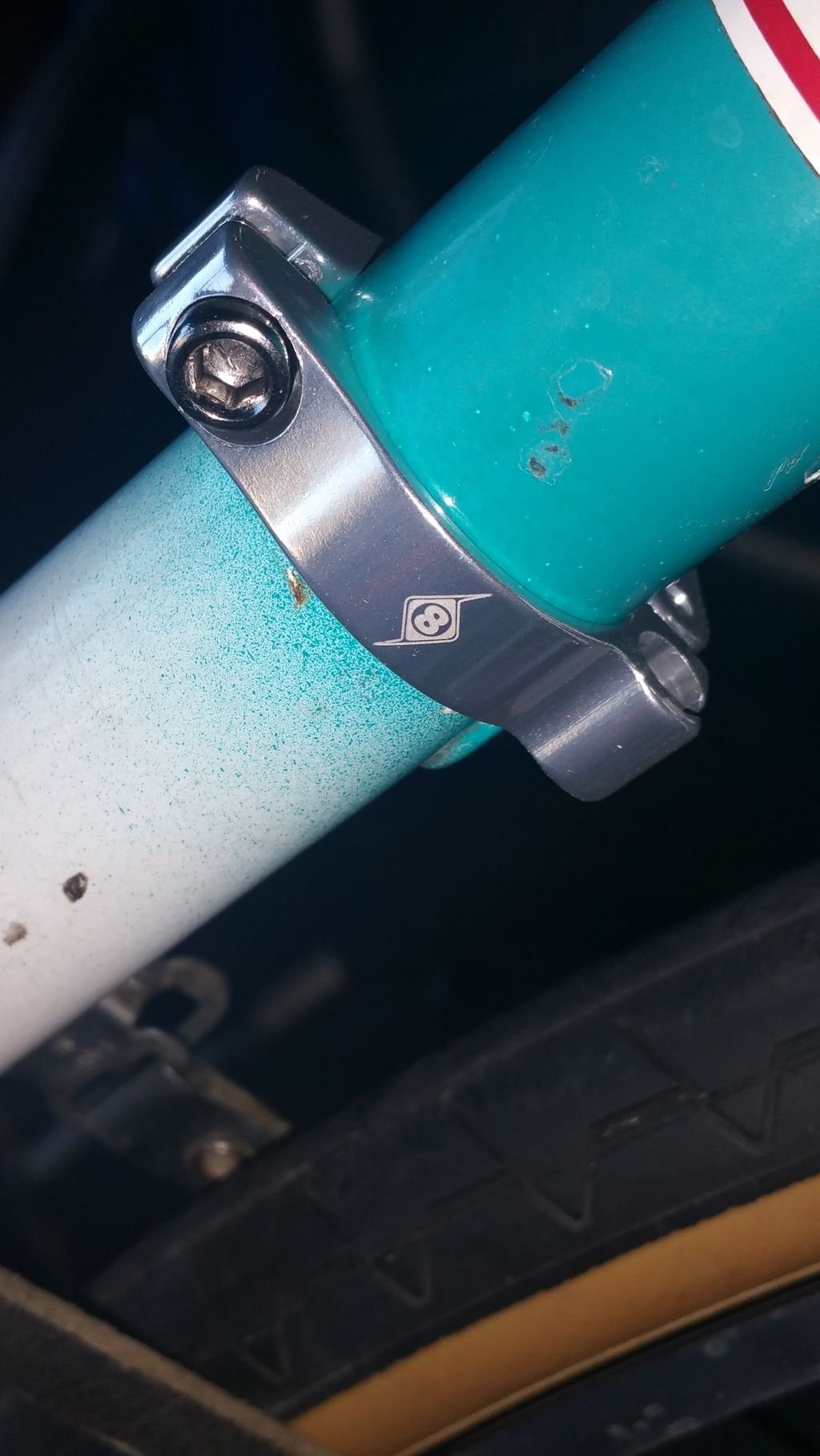

No. He removed the original shifters, put a screw in the boss and used a clamp on above the boss. Problem Solvers?
I donated a Suntour clamp on stop to the cause. A bike that sweet needs it more than my spare bin.

A Suntour clamp would be better then that gadget!

Looks just like the Origin8 cable stop I've got on my Trek 300 Elance. Should work great as shown on this bike since the cables will run along the top side of the downtube just like they would from the original SunTour downtube shifters.
https://www.niagaracycle.com/categor...-28-6mm-silver

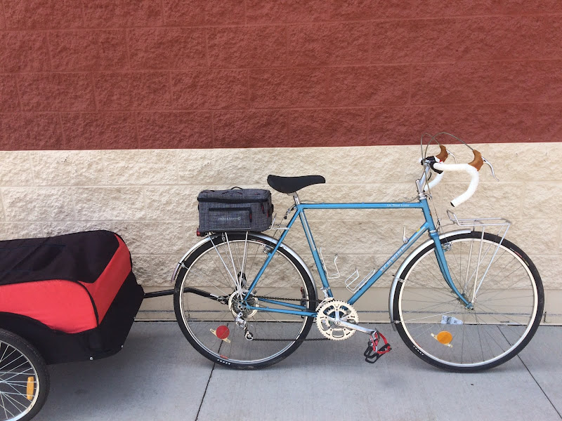

Thanks for the link to that cable stop. Here's a pic of my Le Tour Luxe hauling groceries today. This thing needs a white seat or different tape.

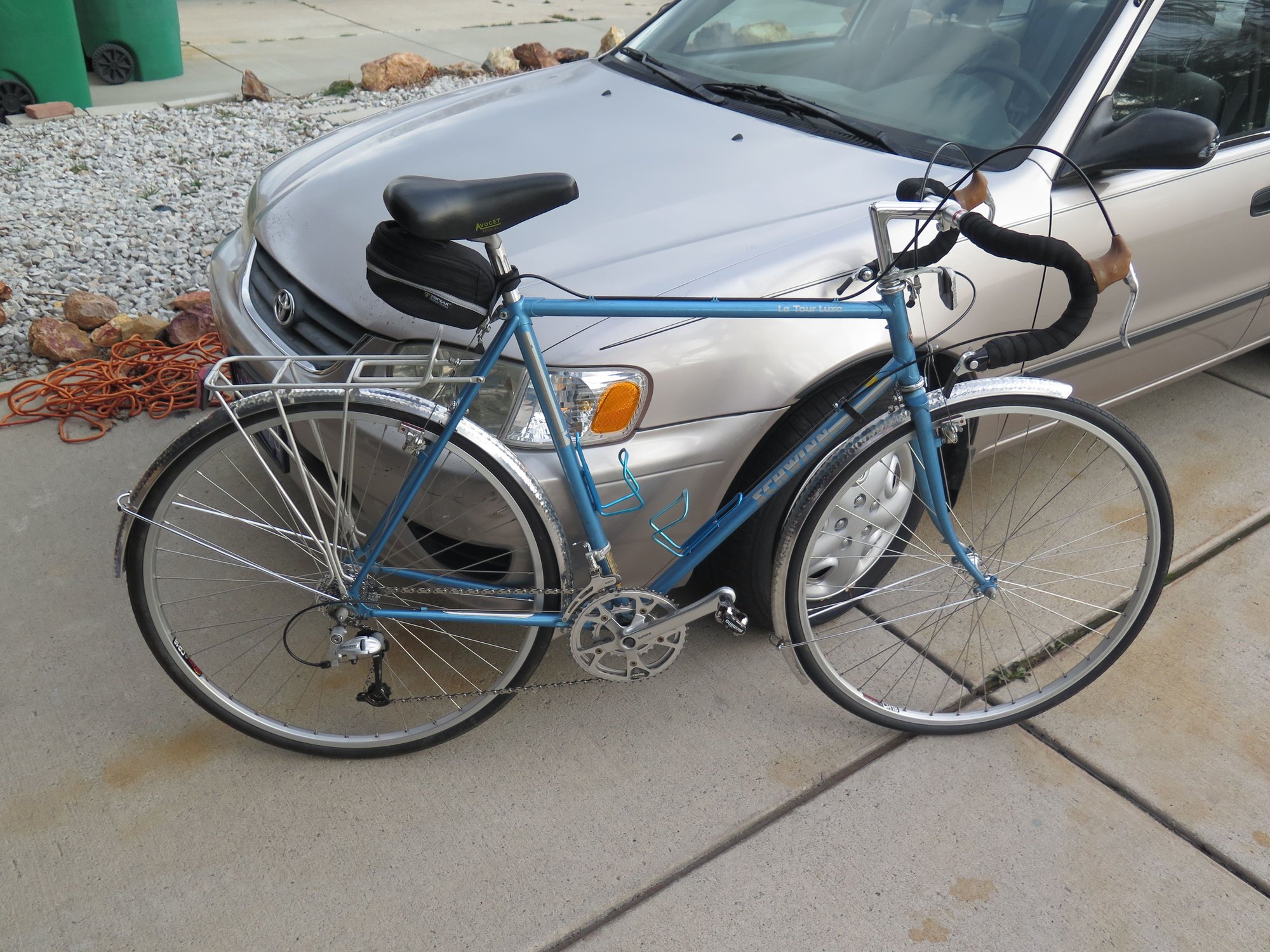

Found one of the blue versions of the '85 on Ebay in Gilroy, CA. Believe I was the only bidder and took delivery out of the owners storage bin. Probably paid more than it was really worth, but it was in very good original condition. Made a few minor changes added Nitto Noodle 44cm bars, XT 730 175mm cranks, and have had the rear triangle spread to 130mm for conversion to 700c wheels with Ultegra/Sun CR18 combination. Nice riding bike!!

Wow, an '85 Luxe! The one year they had that model with canti brakes before changing its name to Passage the next year. What seems like forever ago in my bike world, but is more like only five years, there was a 25" Le Tour Luxe for sale, and it was either an '83 or '84 (no canti, dark grey paint), likely an '84. Back then I wasn't into the long chain stay look. Times have changed on that front certainly.

Changed my Luxe over to Bar Ends and used the exact solution as this works really well.

Sharp looking blue.

I used the same clamp to retrofit indexed thumbies on my '84 Luxe.

I used this Origin 8 when I updated my 86 KHS to 5600 105..
