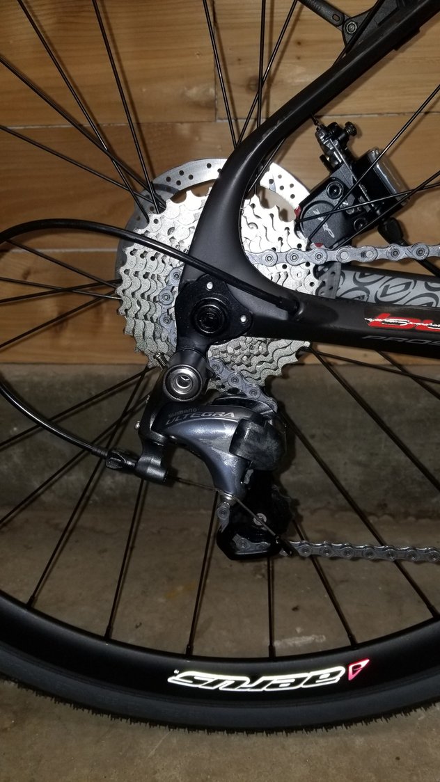

Finally recieved the replacement HYRD for the rear brake. These can be a PIA to get adjusted. It was a little frustrating but after a while I got it to a happy place, no rub, not too long a throw to get it to full brake.
i also got the crankset swapped out and am in the process pf getting the front deraileur dialed in. This is always kind of a pain as well. I try pretty hard to get 9 of the 11 gears on each of the Big and Little rings to go without rubbing. Got the whole of the little ring working without rub but the big ring rubs on the lowest 4. To tired to deal with it. Ill hit it freah in the AM.

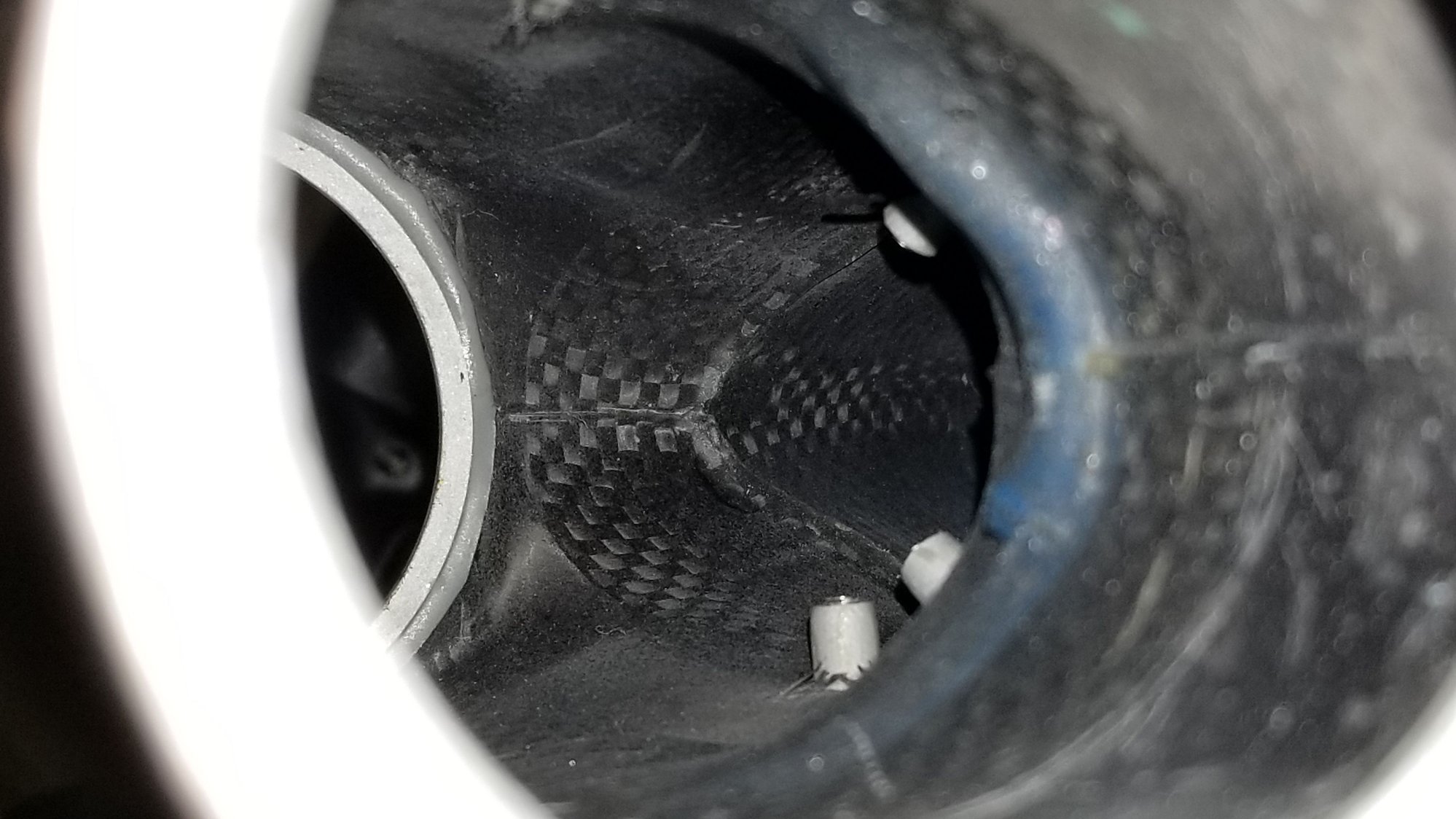

Back at it today. Finished dialing in the front and rear derailleur's. Tore apart the headset. If you havent already, I suggest taking your headset apart. The bearings are all sealed which is good but everything was completely dry. Not one drop of grease anywhere.
Sealed bearings with no grease
Clean, Dry headset
Carbon layup inside the headtube

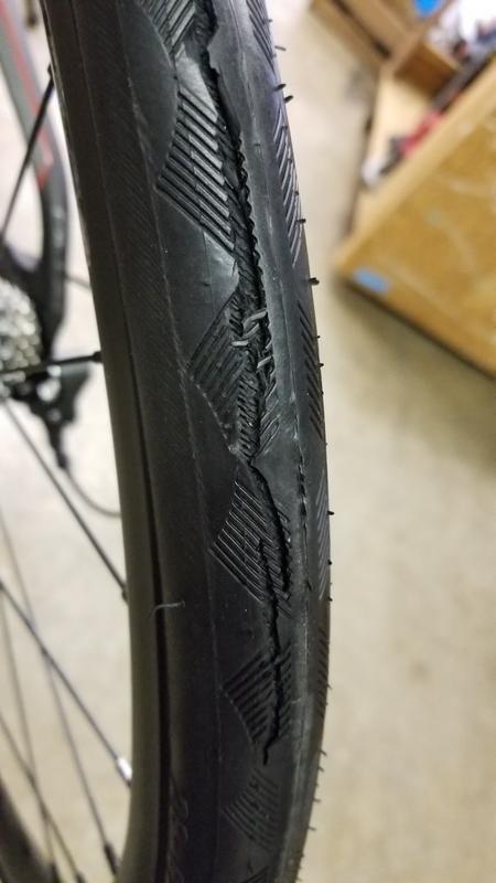

After getting the drivetrain and headset dialed in, I moved on to the tires. This brought me to a standstill. One of the tires that came on the bike (hutchinson nitro 2) was split.
No worries as I had bought vittoria terrenos to replace them. But I couldnt get the vittorias on the rim to save my life. It took me and my wife both pulling on the tire with levers to get it on the rim. Then after getting the tire on I found that the tube was flat. So off again, on again. Then I somehow managed to flatten the second tube while putting the tire on. Pinched it at some point. I checked the tubes for the other wheel before putting the ture on and of course that had a hole as well (both tubes on this bike were shipped with holes in them) Then on the fourth try a tire lever snapped.
After 2 hours of battling tires, I gave up. I ordered 4 more tubes, 4 more levers and some more patches. Will have levers on tuesday from Amazon.

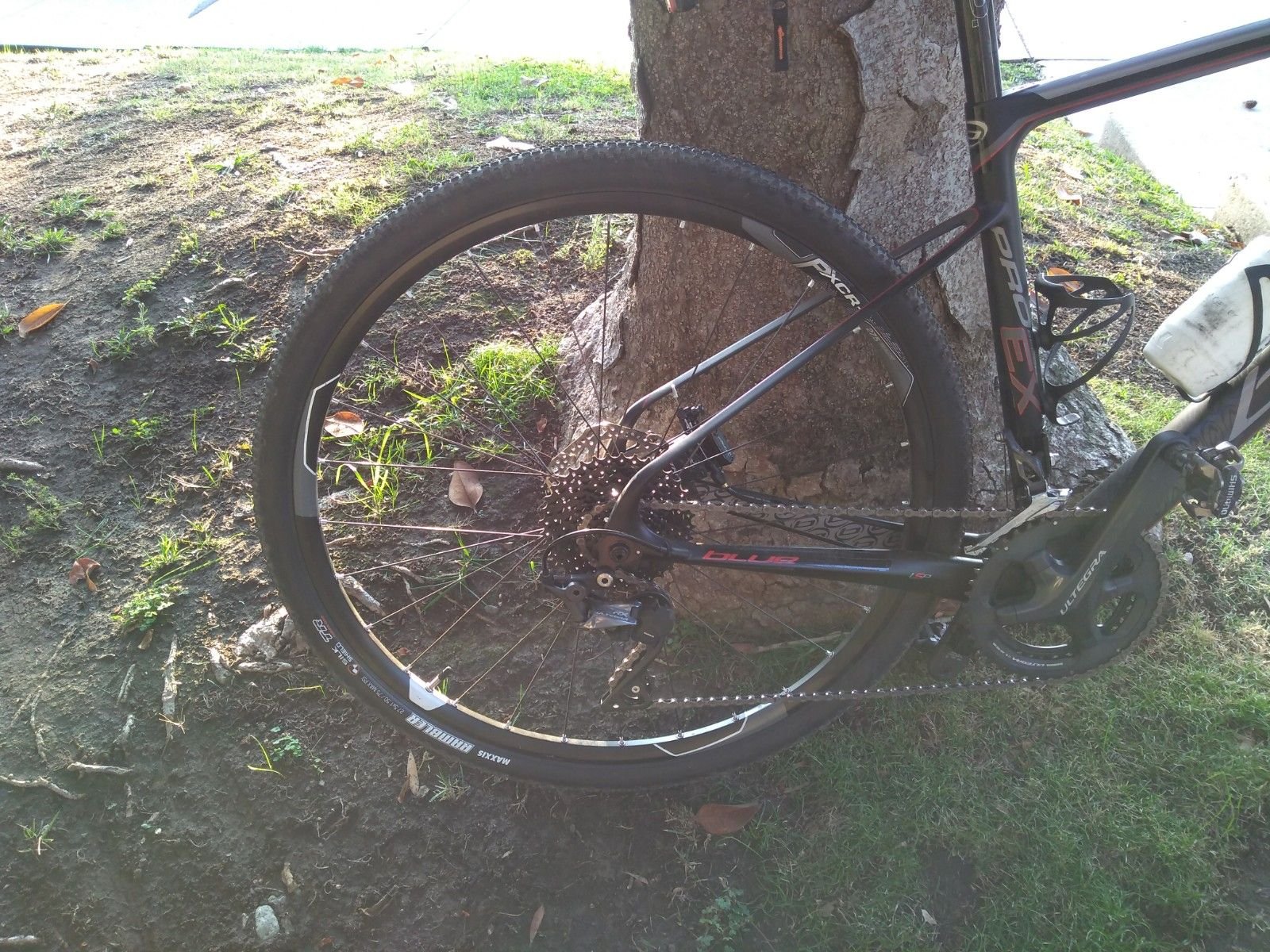

Finally went on my first gravel and also first tubeless ride. I got some Giant PCXR-1 27.5 wheels (19mm inner, 25mm outer) for $100 and put on a 650x48 (measures 48mm) GK SK tubeless front and Maxxis Rambler tubeless 650x38 (measures 39mm) rear. Rear barely has 2-3mm of clearance so I think 39-40mm is the limit.
They rolled very well on both road and dirt - slowed me down by 1-2 mph on the pavement.
Next and probably final upgrades are flared drops ($15 Oval 325's) and a Karoo Hammerhead ($150) to replace my old Edge 510. Also forgot to turn on the clutch on my derailer...

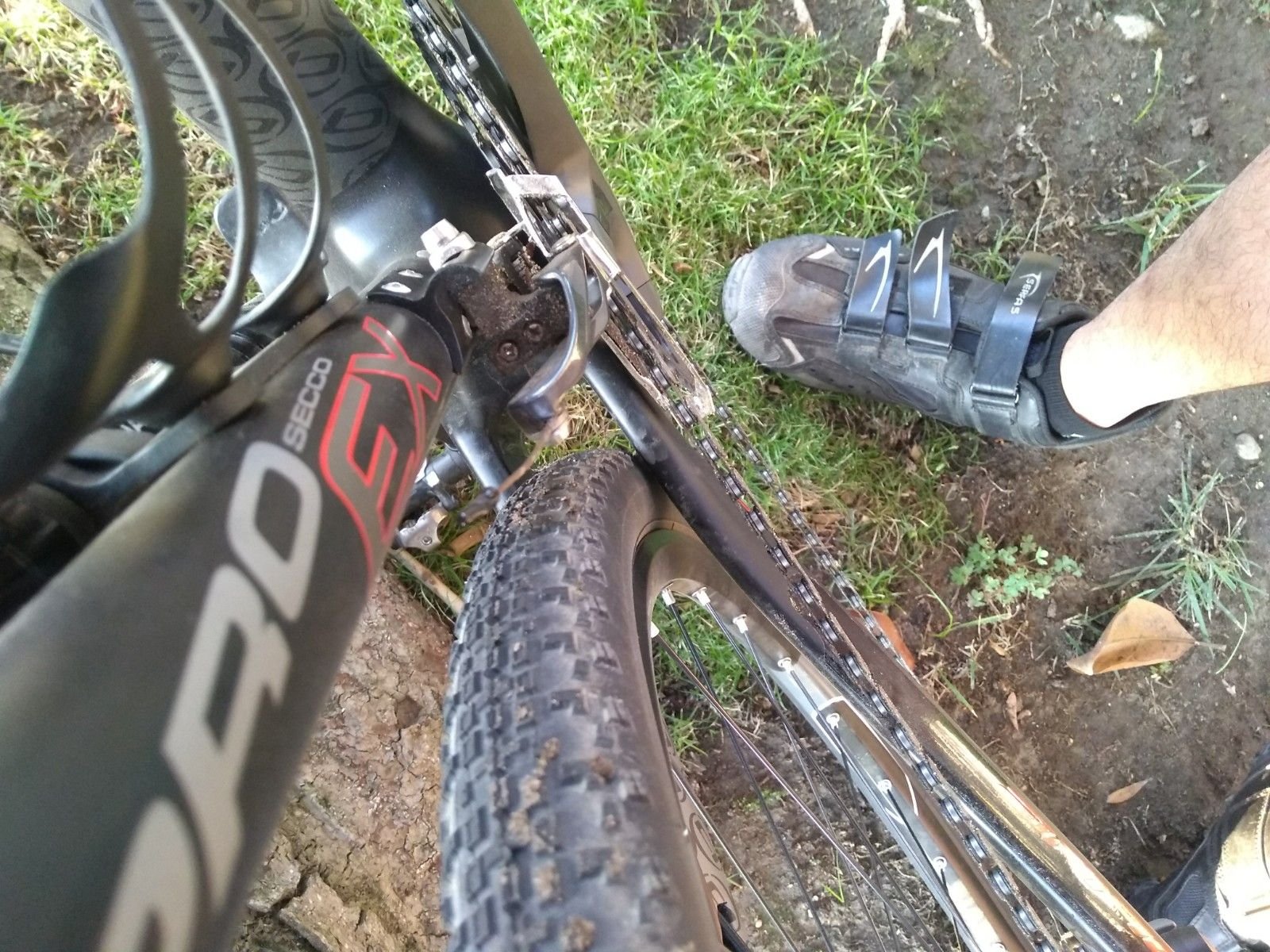

The 38's look really tight on the back, like you might be scraping any mud build up on the sides of the tires with the chainstay.
How were the cranks with the lower wheels? Did you take any steep corners and try to bottom out? I am assuming they are 170's?
Is that a carbon HED seatpost? nice...
With my upgrade to 50/34 and the 11-30 cogset, its loooking like I'll have to add a longer chain and possibly a longer cage or maybe a clutch derailleur? Does the clutch make a noticeable difference? Was it worth the spend?

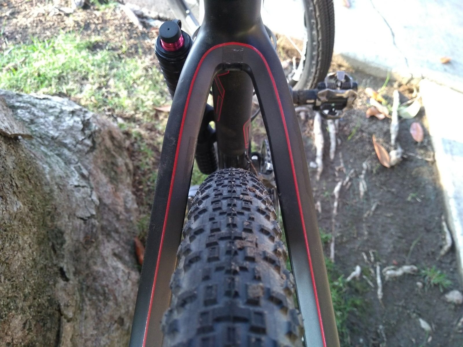

Pretty cool you got the 650's to work, maxed out tire size as well
-Sean
-Sean
I am a terrible descender off road so I am rarely pedaling on the down hills. If I recall correctly 650x48 is the same as 700x28 and 650x38 is the same as 700x23 so I guess it's the same as riding 700x25's on the bike which isn't ideal but I never got any pedal strikes going uphill.
The stock chain was pretty long so you might be fine with the 11-30 and 50T in the front. You probably can make 11-30 work with the stock short cage derailer. I went 11-36 with the RX800 derailer, no road link needed - can probably go 11-40 with more b screw.

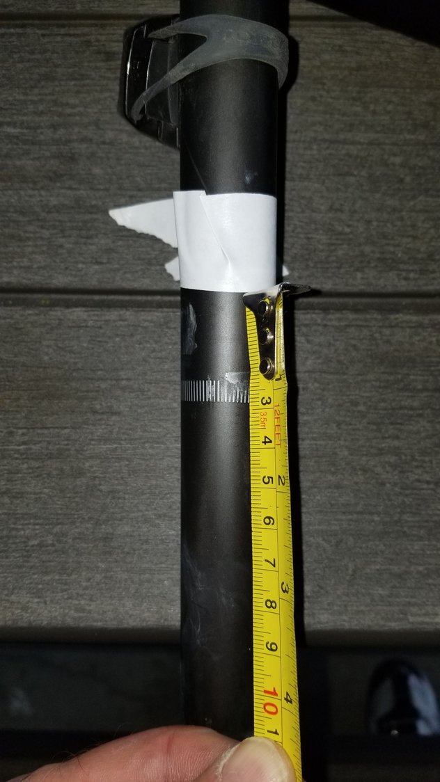

The stock seatpost+seat was like 650g, the stock 110mm stem was 140g, and the wheels were 2250g. The stock Hutchson Nitro 2's are 800g each + 120g each for the tubes. If you go tubeless and put on some mid range upgrades, you can probably save 1000 grams or more.

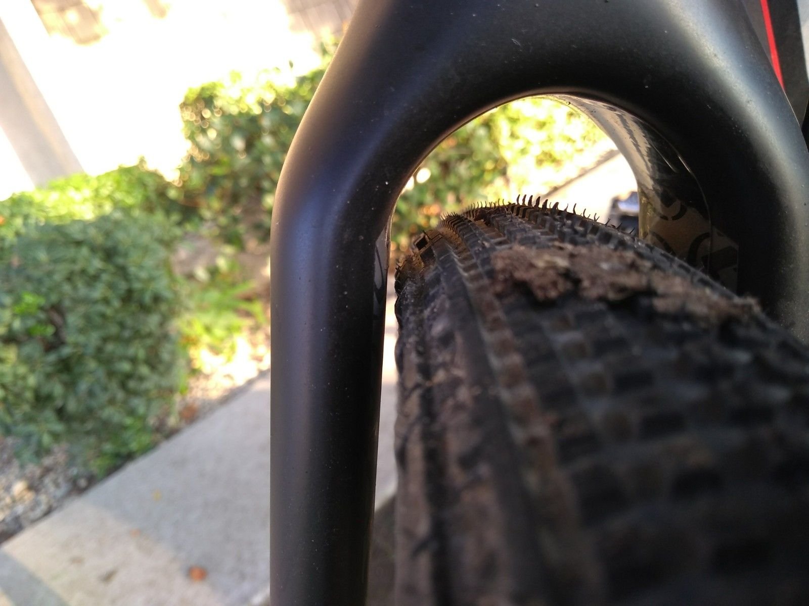

Sorry I haven't been around on my YouTube channel or on here much lately.
One observation in general is that my front foot rubs the front wheel on sharp turns when I'm riding extremely slowly. Once I get my clipless pedals fitted I think that this issue will go away. I've got flats on at the moment.
