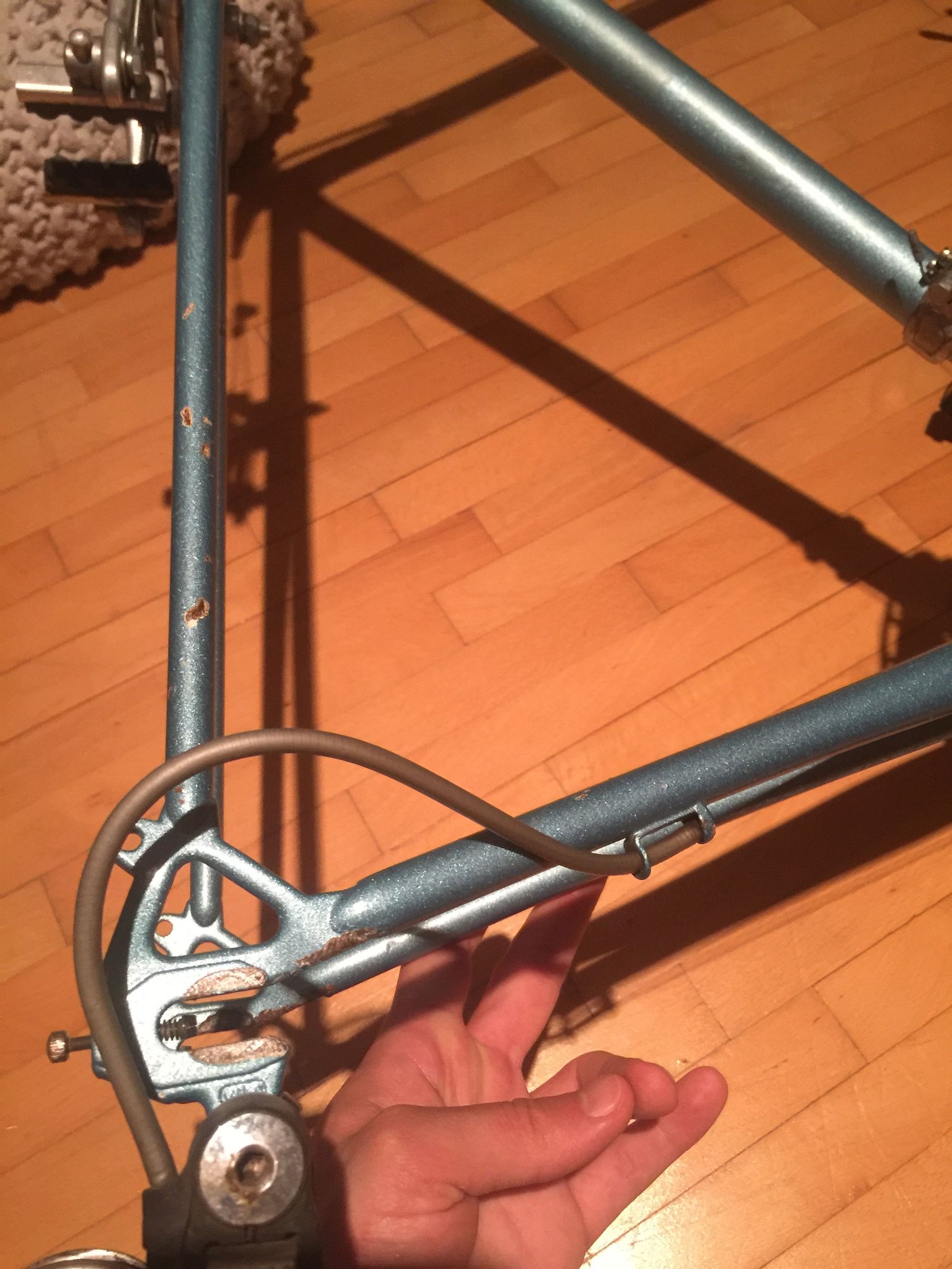

Coming back with more pics regarding the rear dropouts and the rear stay.
Do they look like they were previously chromed? Guess that the nut and washer from the rear stay are a sign that the paint is not original?
I know that the bike had some decals but they were erased. In my first photos, you can still see the uncleaned glue residuals. Maybe it wasn’t repainted afterall.

Yes that would be so-so chrome under the paint considering the lower quality thin chrome and lack of details lean towards Mecier as the maker.
Yep, French and well worth the $80 you spent but nothing that points to one of the major FR brands that most of us NorAm folks are familiar with. Looks like long point Bocama lugs, and Vitus dropouts so surely at least a mid-range model with something decent for tubing...what's the seatpost diameter? Never seen an alloy under-bracket cable guide exactly like this one: unusual little detail!

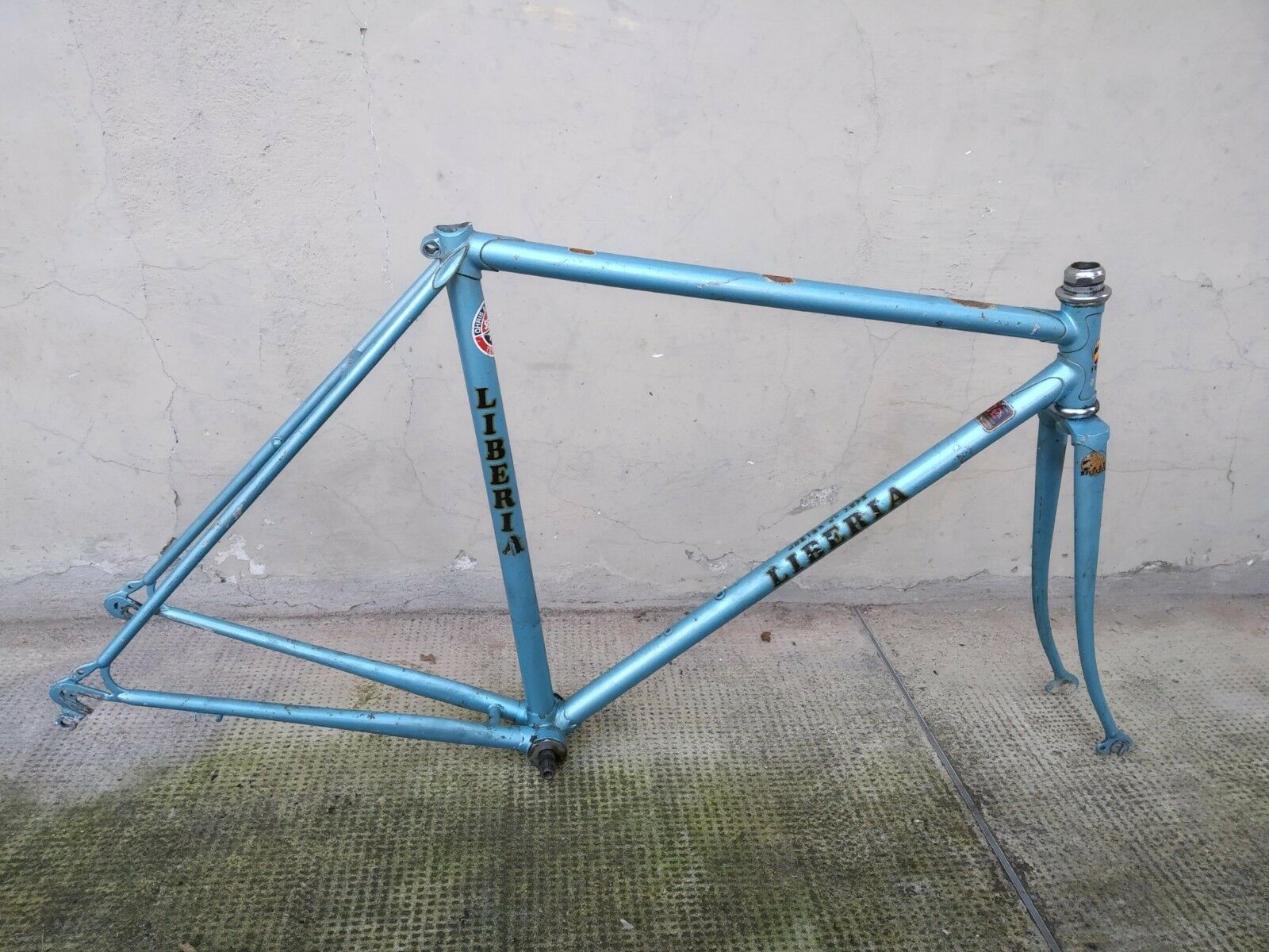

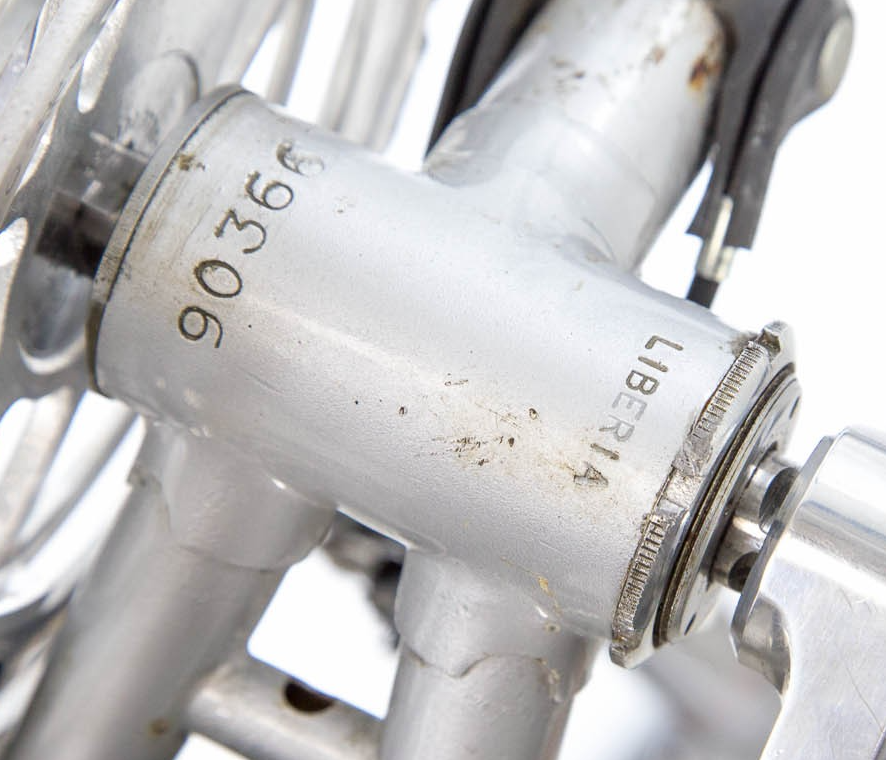

@Silvestru - there is a good chance that your frame was made by Liberia (of Grenoble).
Most of the features of your bike (as well as the serial number format and location) were, at one point or another, used by Liberia, whether on frames sold under their own brand or those of the shops that bought from them (like Michenon, Payan and others).
AFAIK Liberia didn’t have a set numbering system as you will find frames with numbers on the NDS dropouts, bottom bracket shells, or frames that have no numbers. They did a fair number of contract builds (or blank frames that were to be decaled by the shops that sold them), so maybe that explains the serial number situation. Also, I’m not sure how their numbers are decoded.
Here are some examples of Liberia frames with the serial number format/location similar to yours:

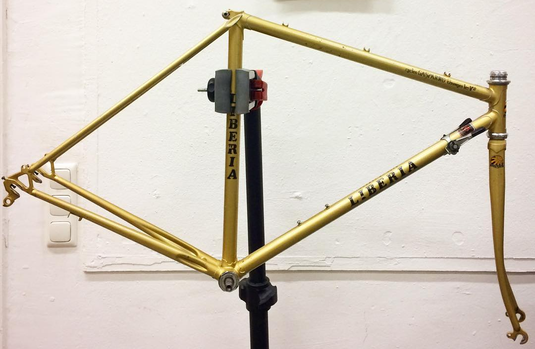

Here are some examples of full frames. Some are Liberia branded and one is labeled Michenon (who seemed to have sold mostly Liberia and Motobecane frames):
This one has different head lugs:
This one has the head lugs but different dropouts:
The brazeon inside the left seat stay is kind of interesting. Anyone know what these were used for? I've seen a few different styles but this particular style so far only on Liberia (please share any pics if this was more common on French frames).
Finally, most of the frames that I’ve seen that match yours had the “Liberia 102” tubing sticker on them. It is likely that’s what yours is made of as well. Unfortunately, I’m completely in the dark regarding the specs of that tubing. Most higher end Liberias were made with Reynolds 531 tubing.

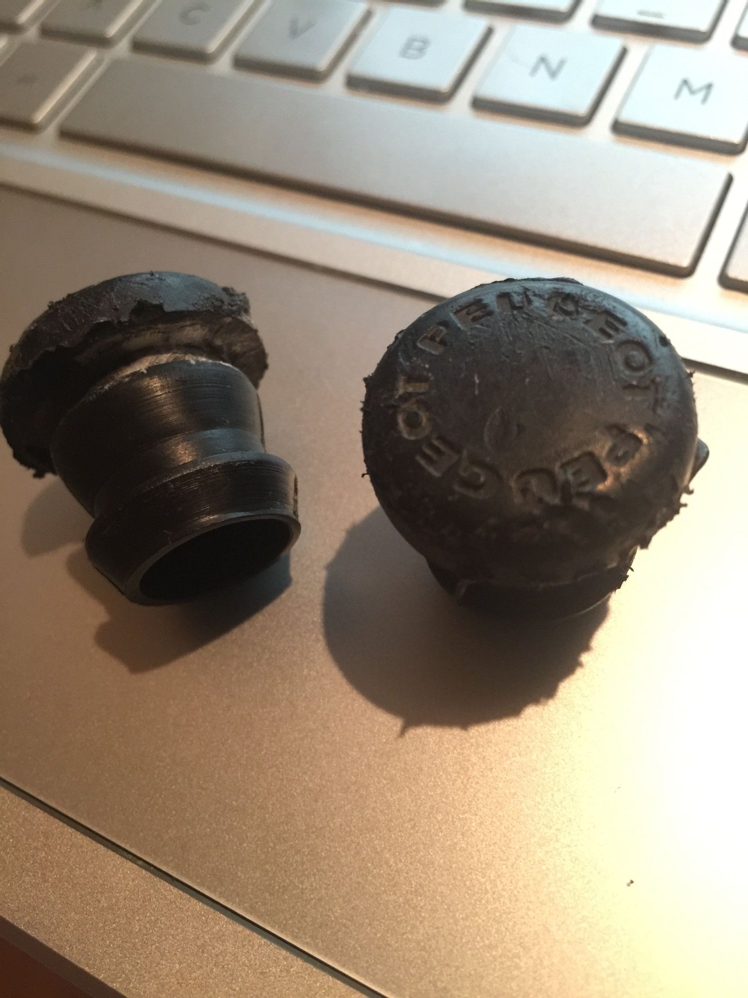

Also, the handlebar caps read Peugeot... most probably the original caps were replaced with these ones? since everybody tells me this bike does not have any Peugeot characteristics
