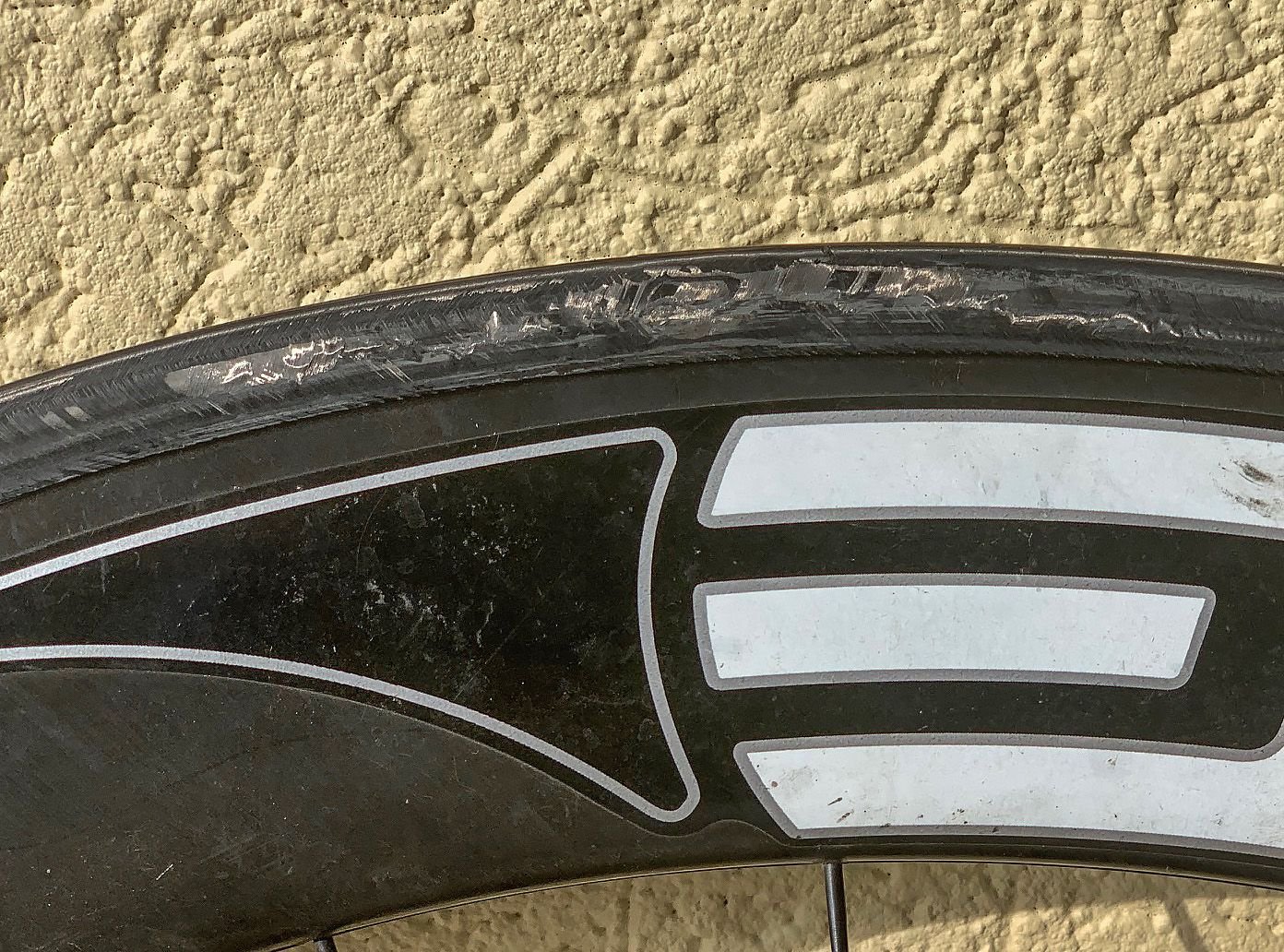

We've been running ENVE rims on our Calfee Dragonfly for the last 4 plus years. (Classic 65 28 spoke rear, Classic 45 28 spoke front) I estimate that we had 20,000 plus trouble free miles on the wheels.
That all ended this weekend in a matter of minutes on the descent of Walnut Gap in the Hot Dogget ride in Mars Hill NC.
We completely melted the front rim, causing the wheel to partially buckle and the tire bead to expand to the point the tire blew off.
Walnut Gap is a 9% grade and we had reached a max speed of 42 mph before the failure. When I put the brakes on to slow for turn, I could here and feel the front pads pulsating on the rim. Fortunately, I decided to stop and check it out, slowing to about 10 mph before everything let loose.
To keep this readable, I'm going to break this up into several separate posts.

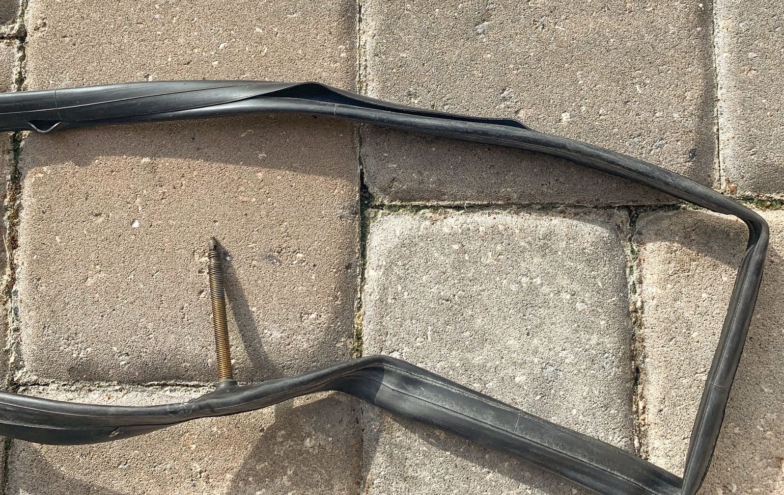

While we've had the bike for 4 plus years, this is the first time wed done any major descents on it. (we keep our Robusta in NC, and usually use it for mountainous rides)
The Calfee was originally set up with Dura Ace Caliper brakes, and has great stopping power.
In spite of the fact that we're a larger team (350lbs), I've never been too concerned with brake heating issues because our riding style is to bomb descents, not ride the brakes, and only use them for short bursts before turns. For example we've done the Haleakala descent in Hawaii with no over heating issues at all (albeit on aluminum rims).
However, using carbon clinchers on a tandem with sharp relatively long descents, I was concerned enough to put a rear disc brake on for Hot Dogget, with the theory being that I could do a lot of braking with the rear disc, and limit use of the front brake, and spread that use out. Unfortunately the rear cable actuated Bengal disc brake did not produce as much brake force as I would have hoped and I ended up using the front more than expected.
That said, I was shocked we completely destroyed the front rim in such a short time. We were 17 miles into the ride and had done two short fast descents with very little braking, and then the one steep descent of Walnut Gap.
In a matter of minutes we were able to turn the front brake track to toast in multiple spots (ironically the wheel looked much worse hot.as it cooled off some of the melted pieces settled mostly back in place) fold the rim in one spot, and bend the bead open in spot large enough for 12" blow out.

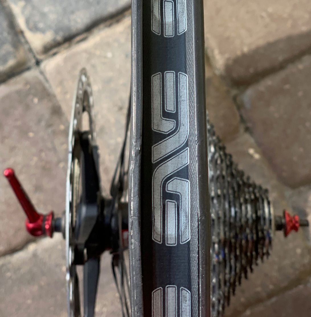

After getting home, and assessing my repair options (unfortuantely ENVE no longer makes 28 spoke rims suitable for tandems) I discovered that our rear rim is also toast. Before I put the Bengal disc on the back, we did one ride in North Carolina on the Blue Ridge Parkway using a rear caliper brake.
The BRP is not very steep (almost nothing above 8%) and the descent we did was not technical. Yet in the course of that one descent, we heated the rear rim enough to warp the bead to the point it is also no longer safe to ride.
I put all this info out as one data point, not necessarily to bash carbon clinchers. Personally, I would not ride ENVE classics in the mountains on a tandem with a decent sized team and rim brakes in the mountains. Of course that may be of limited relevance now, given that they are no longer available.

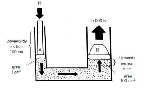

Re: how hydraulic systems work I found the image shown below.
Let's say you pull N force on your brake lever causing the lever to move. This force is transmitted to the cross-sectional area of the fluid in the hydraulic brake cable (very small x-sectional area) thereby creating a pressure. This pressure is then transmitted by the non-compressible fluid to the much larger cross-sectional area of the brake caliper. Let's say the area of the brake caliper is 30 times the area of the brake cable. Therefore, 30N of effort is exerted on the caliper - a substantial increase. However, the distance the caliper moves as a result of this effort is much smaller than the distance you moved the brake lever.

Your drawing and explanation confuses force with power. Power (rate of dissipation of kinetic energy of bike + riders into heat) is what determines how fast the bike will stop, regardless of how much force or distance you have to pull on the brake lever. I don't want to hijack this thread and won't say any more about this. Hydraulic brakes are not on the OP's menu and we should leave it at that.
You're correct on the semantics but in this case it appears the lack of braking power was due to insufficient mechanical advantage provided by the cable disc brake. Using a hydraulic setup allows one to exert maximum force and dissipate maximum power with one finger.
Cable brakes can also be designed with sufficient mechanical advantage but then they will have more lever travel and require more frequent adjustment.
If you're running discs I hope they're bigger than 160mm. Discs will likely get smoking hot going down a 9% hill.
