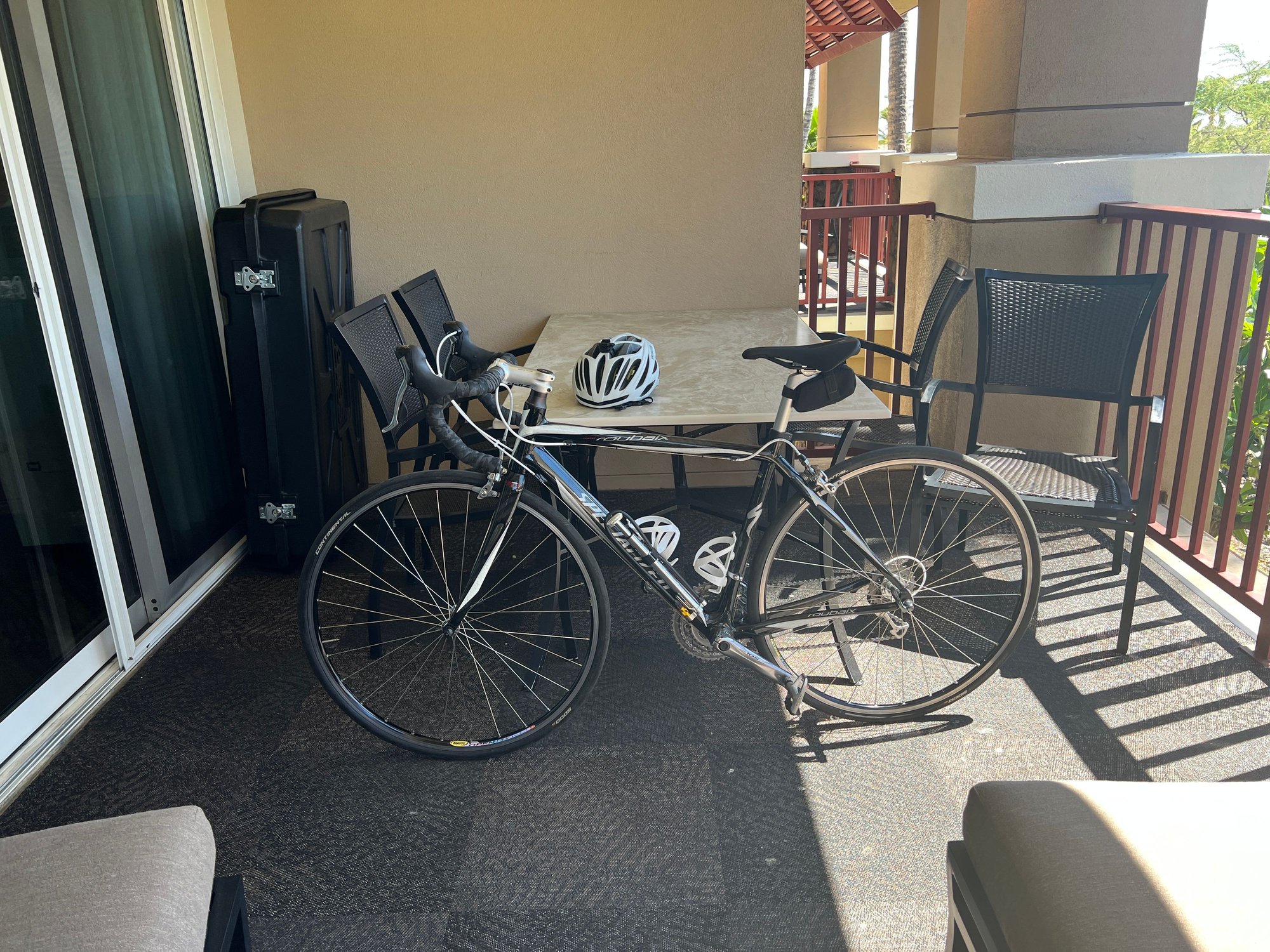

I got a used Serfas hardshell case off of Craigslist for a good deal. I practiced packing it for an upcoming trip from California to Hawaii on Southwest airlines. It seems sturdy enough for the application.
I'm looking for tips to make the transport of the bike as stress free as possible. I will be letting out the air in the tires, removing the pedals, seatpost and wheels and bringing a mini hand pump. I have a few questions
1) Should I lock the case to protect it during airline transport? Seems like a no no
2) Can I put all the necessary tools in the case? They will be protected of course
3) Can I bring a tube of grease and carbon seat stay paste and put it in the case?
4) Is Southwest generally good about taking care to not sit on the case or should I get additional insurance?
5) Should I remove the rear derailleur and/or hanger? I'm leaning towards removing the derailleur
Thanks for the help. I'm very excited to bring the bike for the first time on a flying vacation

1) See above.
2) Might as well, you probably won't be allowed to carry them on.
3)Sure, I don't see why not.
4)I wouldn't trust any airline's baggage handlers at all.
5)I'd definitely remove the derailleur.

1 - yes, with a TSA approved lock, 2 - yes, 3 - yes, 4 - no, 5 - depends on the box
Assume the baggage handlers will run over it with a truck.
For anything other than a true hard "shipping crate" style case (like a Buxumbox Tourmalet) I'd remove the RD.

4) When you fly with a bike, light damage is common, and they do lose bikes. Sometimes they find them, sometimes they do not.
5) Absolutely
I lock mine, but really it's up to you. Security may want to open your bike case. They always seem to want to "spot drug test" the inside of mine...
Yes. Just make sure they are secure and don't tip you over the weight limit. You don't want them coming loose and rattling around during transit, possibly damaging your bike! Don't be tempted to take your tools as carry-on either as some airlines may not let you take them on board.
Yes. I pack a bottle of chain lube and some grease inside my case.
I recommend this, but it depends on the design of your bike case and how well your bike fits in it. I always remove mine, bubble wrap it, then secure it so it can't move around.
Have a great trip! 😀

try to pack and secure stuff as though a couple of inquisitive gorillas are going to root through it. I’ve heard nightmare tales of TSA either unable or couldn’t be arsed to close up a hard case, so they just wrap tape around the whole thing and hope it stays together. If small items fall out through the gaps, them’s the breaks. Don’t lock it - they’ll break the lock. Remove the RD and tape it to the inside of the chain stay. Leave your CO2 cartridges at home

To start I HATE hardshell cases and would never use one. TSA is going to open it for inspection (which means you'll need a TSA approved lock that they can open) and they'll move stuff around. They do not care in the least about putting things back the way they were. In my opinion semi soft cases like Evoc and SciCon are the ONLY way to go.

Good advice above!
Add an Apple AirTag to the inside of your bike box so that you can track it throughout your journey. I recently went from Canada to Mallorca and felt relief to see the bike traversing the terminals between connections and keeping step with me along the stops in Montreal and Geneva.
Good luck!

Best piece of advice I can offer someone flying with a hardshell case for the first time: Make sure the rental car or taxi/Uber you'll be using at your destination can accomodate it! Ask me how I know...
Yeah, I've certainly told one of those tales, probably here or on other cycling forums, but in short, ^^^that's exactly what happened.
The Good News: Nothing fell out of the case despite it barely being held shut by this tape, so everything arrived at my destination.
The Bad News: Because this not-fully-closed/held-together-by-tape case was now no longer a flat, symmetrical rectangle, it got caught in some mechanism on the way down the conveyor belt from the plane to the baggage claim area, and was crushed. Destroyed the case completely, and ******d up my bike enough to require extensive repair by the framebuilder. American Airlines, you suck!

Successful arrival
I’m happy to announce the trip had no drama. I just assembled the bike…

Went for a short ride
It was glorious to have my bike in a new vacation location. This is going to be fun!
