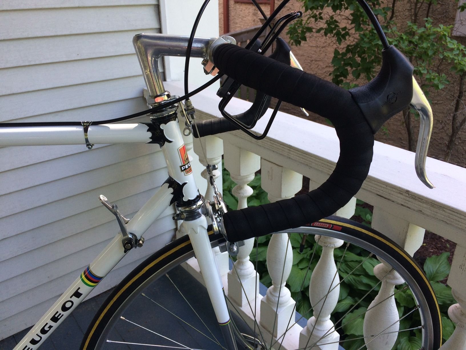

I use Velo Orange down tube clamps and their stainless, old school cages. I currently have two bikes setup like this, but have had others. Only one day did one come loose on a ride, which was fortunately resolved at a hardware store on the road. I also really like the look of cages fixed to handlebars at the stem.
