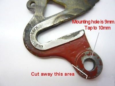

The pulley cage on the dérailleur on the right looks like the longer cage that came on 2nd generation Super Record 4001 dérailleurs. They had titanium pivot bolts with an advertised capacity of a 28T FW vs. 26T for the NRs.
I've heard tales of Campy employees assembling bootleg derailleurs out of parts that they "acquired" from the factory. If true, that would explain some of the weird mismatched Campy RDs that show up from time to time.
@Road Fan "Was it necessary to fit the French frame?"
The unrealistic fear many cyclists have about any French bikes or components drives me (more) nuts as in simplexnut!!! Please do some research before breaking out the tar brush!
In the late 70's Simplex introduced their new style dropouts that worked with most derailleurs on the market including the de facto standard Campagnolo design.
These were used on a lot of better quality French bikes up into the early 90's. I have them on 7 of my top end French bikes: Gitane, Motobecane & Peugeot.
Before these came out, 10-15 minutes of work could modify the old proprietary Simplex dropouts that so many cyclists fear and/or loathe. This allowed most brands of dérailleurs to fit on them.
@1simplexnut your bike is made of Reynolds 531 Professionnel which had the same wall thickness as Reynolds 753R. It should be a supper smooth riding bike. The handling will be great too
