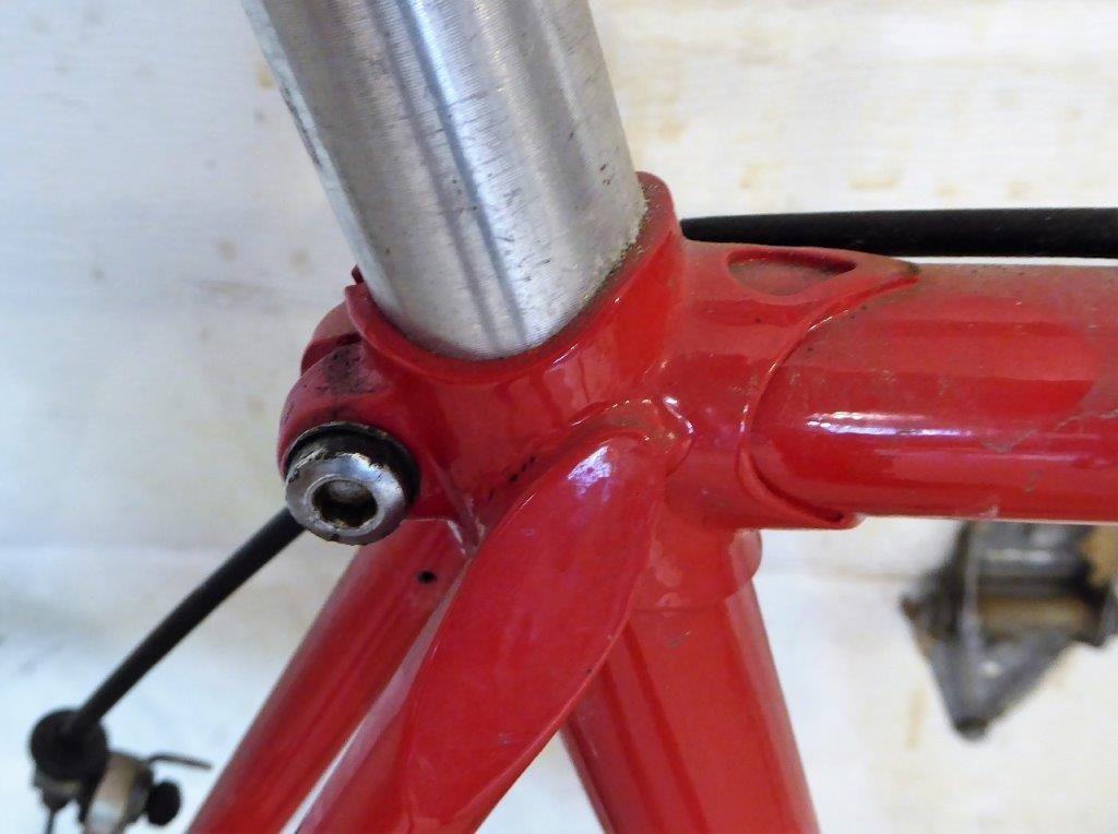

I pulled this bike out of my stock pile for my next project. The frame has been repainted by a previous owner and I can't identify it. It is a lugged steel frame with forged Brev. Campagnolo drop outs. There are three small holes in the head tube which I assume where used to secure a now missing head badge. The following numbers are stamped in the bottom bracket in two rows:

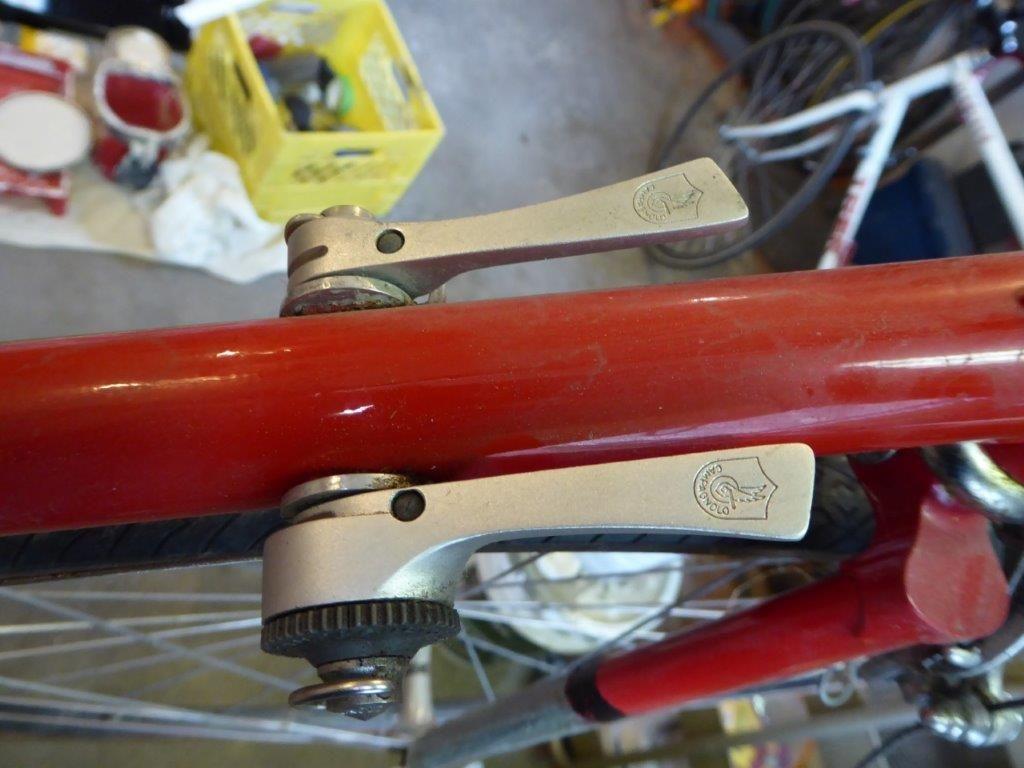

Camagnolo crank, shifters, derailleurs, headset, seat post

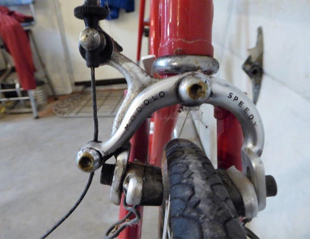

Madolo Speedy brakes and levers

Those are the deepest lug cutouts I have ever seen. Nervex lugs...?

The lug pattern is BOCAMA Professionelle Luxe with cutout pattern B4.
The domed stay ends are somewhat suggestive of a UK origin.
Possible that one of the numbers on the shell is from a licensing agency. Note that the "W" number is very evenly spaced and well struck while the second number less so.
You do not mention threading. Would expect Italian not to be a possibility.
No good images of crown are provided. All we can tell is that it is semi-sloping (perhaps it belongs in the forum's recent thread on semi-sloping crowns ).
Since we have a respray we cannot place too much weight on the presence/absence of specific braze-ons.

WRT the model: something doesn't jibe here. Raleighs of that era - at least the European models - typically didn't have top tube cable guides or shifter bosses. Shifters were clamped, and rear bake cables used either cable clips or a couple of housing stops, like this:
They may have been added later.

+1, my initial thought, even before I started reading through the responses, was a Worksop built 1977 Raleigh. It's obviously a repaint and looks to originally have been black. This and Campagnolo dropouts with eyelets, would be indicative of a Competition GS. Given the repaint, the cable tunnels are likely an addition, as would be the shift lever bosses and bottle bosses.

Components are another matter. The Campagnolo seat post, front derailleur, and head set, Brooks saddle, and possibly the bottom bracket match the 77 Competition. I don't think the 3ttt stem and unbranded handlebar, or Modolo brakes do. The wheels and remainder of the drive train appear to be of newer vintage.
