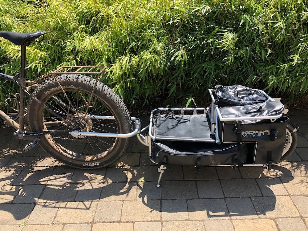

My neighbor bought a Koga-Miyata “chela” trailer from a junkyard for $5. We are trying to figure out how it attaches to the bike. It has the swiveling U shaped frame part with its twisting quick release collars, but the parts that attach to the dropout areas at the rear wheel of the bike are missing. I have no idea what they even look like. Anyone have pictures or ideas? I would weld something together out of steel if needed, but getting an idea of the original design would help.

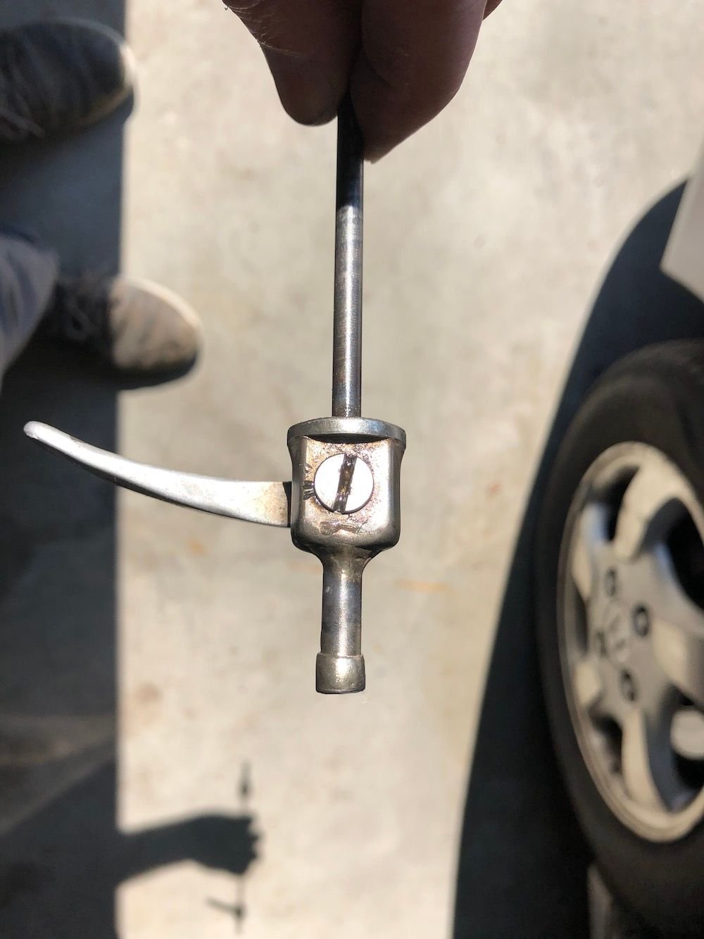

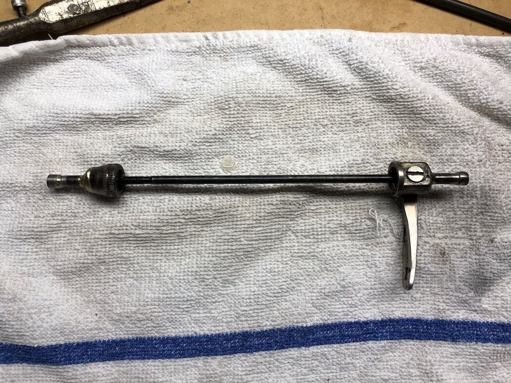

But I decided to try making one anyways. I brazed some cro-moly tube on the ends of an old skewer I had.
I had another problem with the trailer pivot (where it is behind the rear wheel). The headset-like arrangement was loose. When I tried to turn it (all aluminum parts) I found it had seized. I could turn it with lube but it was shearing the threads off. I just packed as much grease in there as i could and snugged it down and adjusted it best I could. Who knows how long it will last. The pivot appears to be plastic bushings only; no bearings. A real design flaw in a trailer that has a lot of good things going for it.
I like how the trailer double kickstand holds up the trailer, and the bike too.
