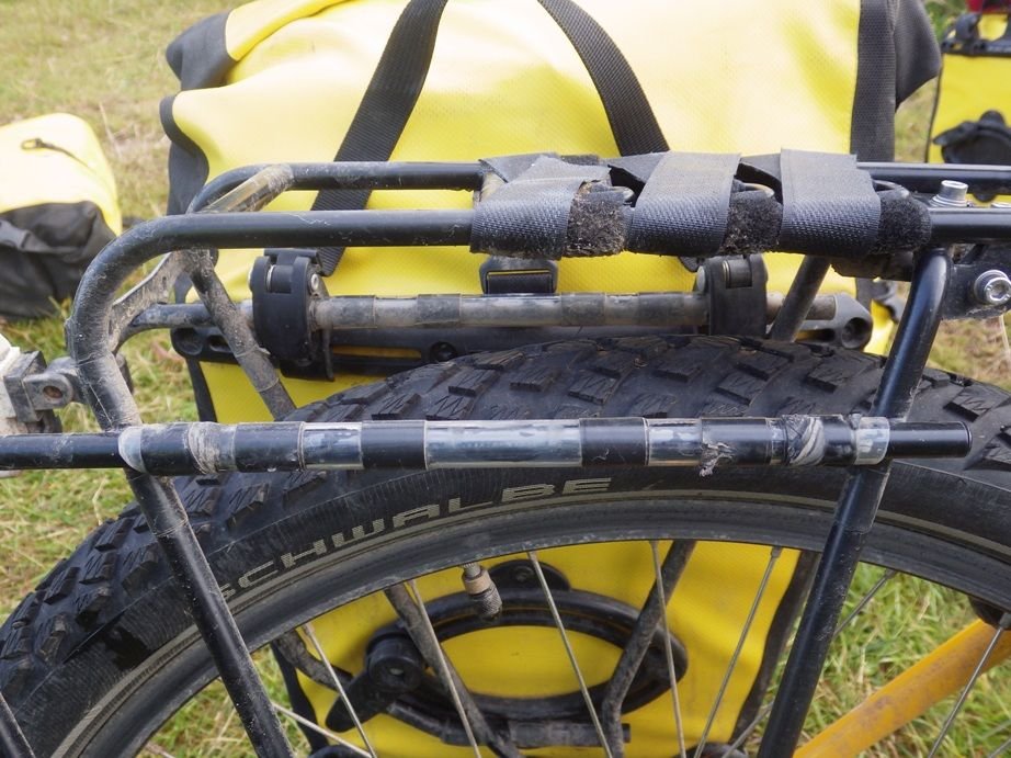

Ortlieb parts are quite robust, rarely break. I think the lower hooks are the most likely to break off if you have a crash. And the little inserts for different size rack tubes in the upper hooks fall out and are often lost. But otherwise you probably will not break anything. The shoulder pad on one of my Roller panniers broke off but that did not bother me.
European suppliers sell those little parts BUT usually the European sellers will not ship Ortlieb parts to USA. The USA distribution network gets quite angry when European sellers undercut them in price so in USA finding the parts can be much harder.
I stopped using the little inserts in my upper hooks, instead I put some PVC clear plastic tubing from the hardware store over my rack tubing. I think that tubing was 1/2 inch OD, 3/16 ID. Slit it lengthwise and tape it on with electrical tape. That tubing with a bit of electrical tape is just the right size for the hooks on my Tubus Logo. That also works well to prevent paint chaffing on the rack.
