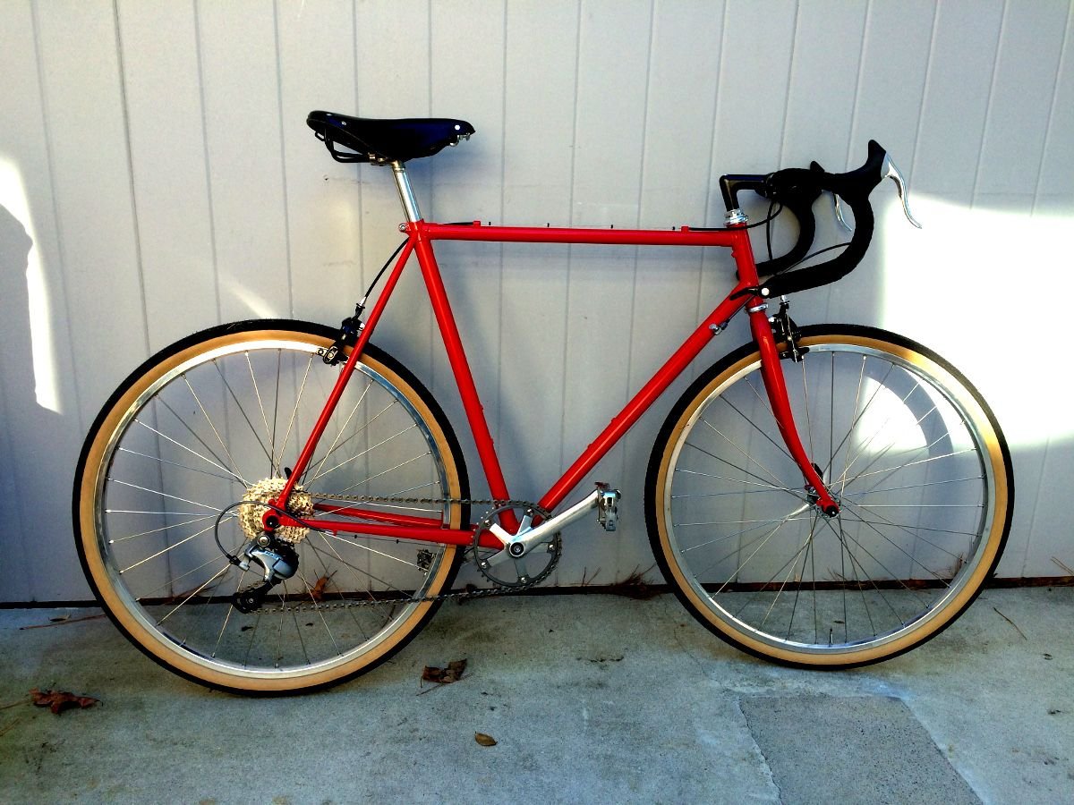

I converted an early 90s Bianchi road bike to something like you described. To mount larger tires, I build up a set of 650B wheels which have a bead seat diameter of 584mm instead of 622mm. This allowed me to mount 42 mm tires. I used Shimano 105 components and decided that a single chainring in the front, coupled to an 11 speed cog in the back was perfect. To minimize chaindrop, I opted for a Wolf Tooth Drop-Stop narrow-wide chainring. I used a bar-end shifter because I could not find an indexed 11 speed downtube shifter. I understand that DiaCompe makes a friction lever for DT mounting, though. Fitting fenders for these larger tires is in the plan for the future, but I know that it will be difficult in the front with the Bianchi unicrown fork. Still thinking about my options on this, but am not in a hurry. This bike is not my commuting bike so I avoid riding in bad weather. Here's a picture:
Very cool! I'm still pretty new to this and I wasn't sure how that would work out - if you put tires with a smaller diameter on, doesn't it mess up where the brakes interact with the Tire? For some reason, I thought I was stuck with the 700c tires because the braze-ons for the brakes were in a specific spot - am I off base?

Yes, brakes can be an issue with smaller wheels. I was able to mount long reach calipers on the Bianchi frame. My intent was to show you an option for your older road bike, which I assume has caliper brakes. You coule easily take some measurements of your old frame to see if the 650B conversion would work for you. With cantilever or v-brake studs, you are probably stuck with 700c, although there are some options. If you are definitely going with the Cross Check you won't have to worry about tire clearance. I'd almost bought a CrossCheck frame a few years ago, but now I think I would opt for the Straggler instead because of disk brakes.
