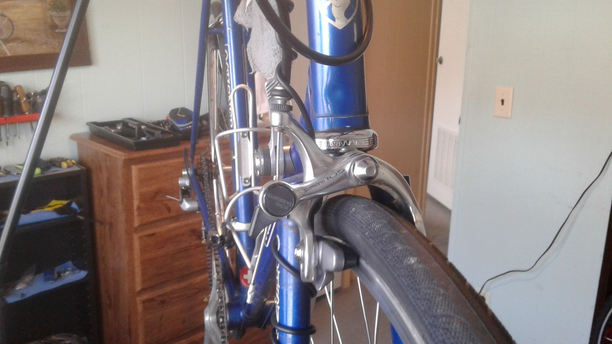

Dent is sort of visible below decal just above the fork.
Dent really shows up in this photo
this is the finished bike.
Without seeing the gouge/dent, everything is just a guess. I recently had a steel frame/fork powder coated. The fork had a nickel sized dent in it, and it had been there since I bought the bike new in 1992. The dent had not changed in any way after 27 years. No paint chipping, cracking or any other sign of worsening damage. When the powder coating was done. the powder and the baking process filled in the dent, and now you have to really look closely to see any sign of it. If you did not know it had been there, you probably would not notice any sign of it.
Dent not vivible
Other minor scratching and chipping are now gone.
