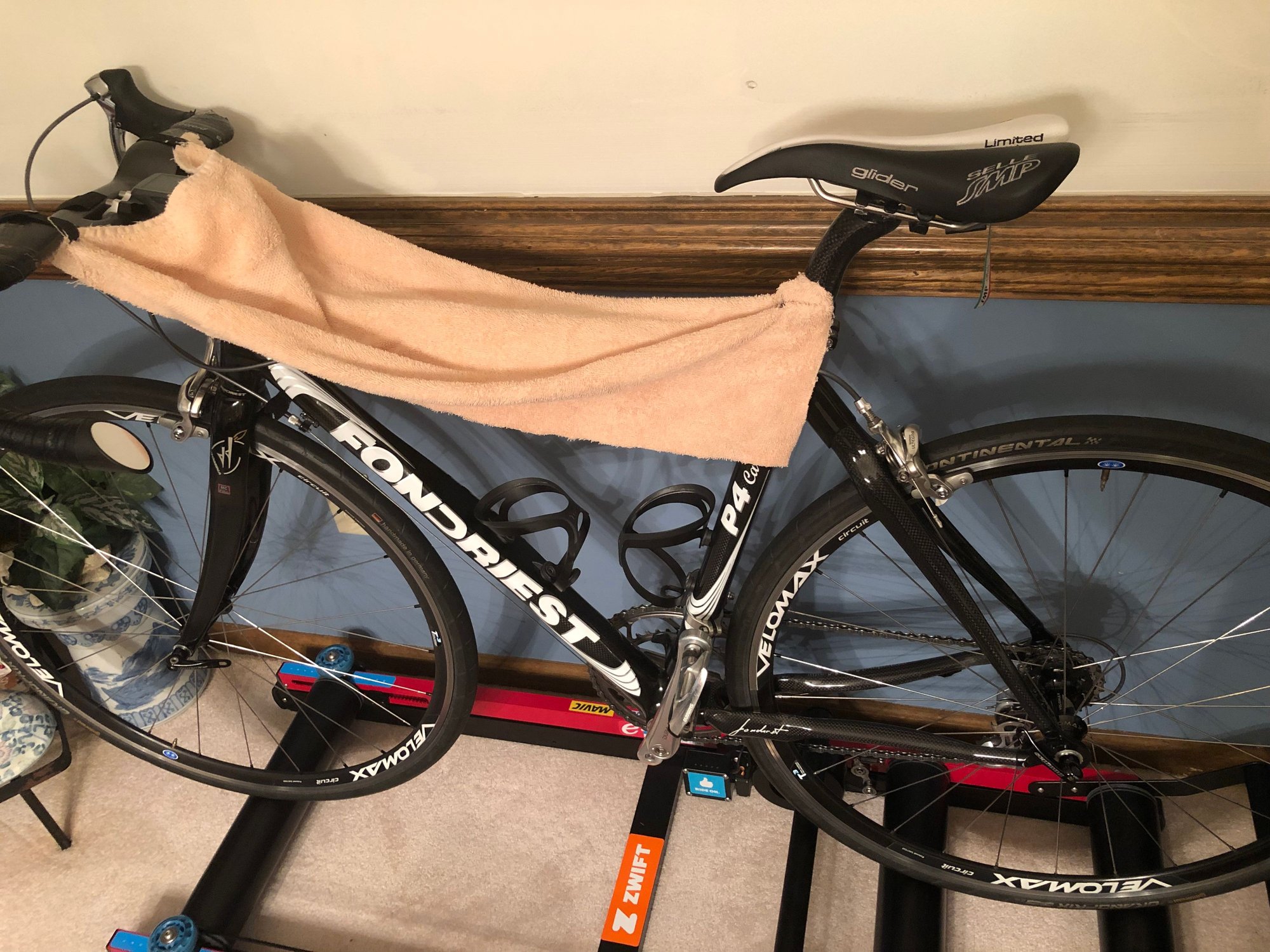

I recommend a sweat band for your head and a sweat shield for your bike. You can make one out of an old towel.
