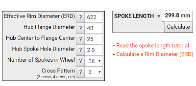

Still working on this coaster brake wheel build. I'm leaning toward the Velocity Fusion and Shimano CB-E110. Trying to make sure I get the spoke length correct using info from the web.
Not sure how accurate this is but I will be ordering one in a bit to have it in hand for more accurate numbers. Shimano make them in different spoke holes (from my research) 80g or 105g (I want the 80g because it's suppose to use 14 gauge spoke). Did I fill this out correctly? Would extending the axles to 120 for track dropouts change the spoke length?

Your ERD is NOT 622mm.
622mm is the BSD, Bead Seat Diameter, an entirely different beast.
Don't think you have 48mm hub flange either. That sounds like derailer gear/front rim brake hub dimensions.
And while not impossible, IMO it's unlikely that your hub will be that symmetrical. All IGHs and coaster brake hubs I've dealt with have had SOME offset, resulting in a 8-10% difference in spoke tension balance for a properly dished/centered wheel.
The difference won't be big, but might be big enough to influence decisions about rounding up/down spoke lengths.
Hub spoke hole is unlikely to be 2.0 mm too. Most spokes are 2.0 mm at the bend. It'd be a struggle to force a 2.0 bent spoke through a 2.0 hole. Most spoke holes are bigger with 2.3mm the measurement I recall.
There are spokes that are 1.8mm throughout. I suppose those might be a snug fit for a 2.0 mm hole
