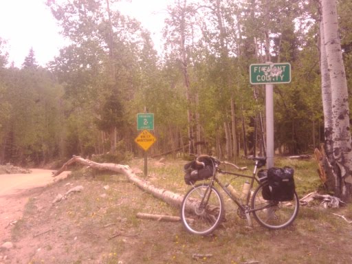

I don't know that any of these would be suitable for what you want to do. For off-road touring, a conventional hardtail or a Moots YBB would be a better choice. Get them with a fork that can be locked out and you'll have a machine that can handle pavement and everything else you want to throw at it. If you go to Revelate Designs, you can even get bags that make off-road touring easier than dragging around a trailer or trying to loft a bike loaded with panniers. I'm planning on purchasing these bags for exploring old mountain railbeds here in Colorado (not smooth railtrails but rockier flatish roads)
I've done off-road touring like you are planning on a conventional rigid mountain bike with front and rear bags, as well as on a hardtail pulling a trailer and the Moots pulling a trailer. The rigid bike will beat you to pieces. The hardtail with shock is much more comfortable and the Moots takes enough edge off the rear hits (remember you won't be able to lift the bike over the bumps like you would an unloaded bike) to make it a worthwhile investment...especially if you can find a used one.
