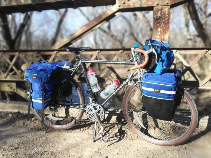

You'll be fine. This summer I did 1,100 miles fully loaded on my '85 Raleigh Portage from NE Oklahoma to Devil's Tower, Wyoming. I had no mechanical problems. I think the only limitation of 1980s touring bikes is that they predate today's off-road touring (bikepacking) trend and thus can't accommodate the wider tires that make such touring easier. The frames are up to it, but the experience is a bit less seamless on 38 or 42 mm tires than on 2.5" tires.

I'd take either of my two vintage triple-crank steel bikes on a cross-country tour without hesitation ('75 Fuji S-10S or the Univega). Both ride on 27" wheels, too! The ubiquitous Pasela PT works quite well in 27x1-1/4 (or 32mm if you prefer its width in Metric conversion) on these bikes with adequate room for fenders, too! The 27x1-1/4 Marathon HS420 are very heavy at 660 grams each. The Paselas in the same size are 410g for wire bead, and 350g for folding. That 250-300 gram difference is over 8-10 ounces per tire! All that is rotating weight! A folding Pasela would be a good choice to carry as a spare for peace-of-mind out in no-bike-shop Rural America...
