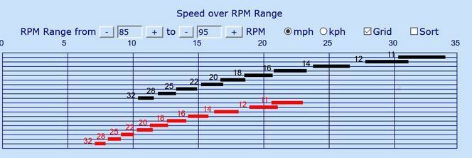

Gearing choices
Cadence
The tradeoff with wide range cassettes is larger gaps between shifts. Some riders don't care or notice that they can't get the "just right" cadence. Other riders, like me, will be annoyed and keep shifting up and down one click, either pedaling a little too fast or a little too slow.
With my 32 rear, compared to my old 28 low gear, I can slow down, use moderate pedal pressure and stay seated on a steeper hill. And the really steep grades are easier to do standing up, too.
Percentages
One rear cog shift is anywhere from about 6% up to 15% or so, depending on the tooth counts between the cogs. Around 10% could be considered "one shift" in effort.
So going from 28 to 32 as the largest cog is 32/28 = 1.14 = 14% easier
A 30 chainring instead of a 34 is 34/30 = 13% easier.
Charts from Mike Sherman's Gear Calculator.
10 speed gearing at typical flat road cadences:
11-28 and 34-50, the stock setup.
Reasonably close shifts in the big chainring, and close shifts in the small chainring all the way to 20 mph.
Great for everything except steep hills.
34-50 and 11-32 (The gear calculator link for this setup: Calc )
A lower low gear for hills, the tradeoff is bigger gaps from 15-20 mph in the small chainring. The big ring is quite similar to the 11-28 setup from 15-22 mph.
(Compare to the 30-46 and 11-28 chart farther below.)

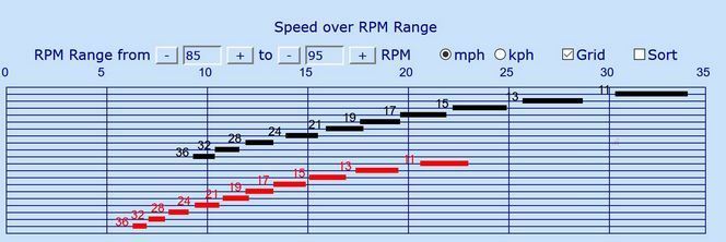

11-36 and 34-50, will need a Wolf Tooth.
Lots of low gearing!
The small chainring has large gaps between shifts above 15 mph.
The big chainring is okay down to around 12 mph.

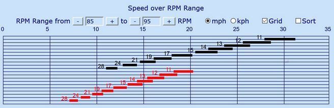

30-46 new crankset
11-28 and 30-46 crankset
This just moves the good gearing of the current bike down about one more rear shift.
It has a similar lowest gear as the 50-34 & 11-32 above. But there's much closer shifts in the 12-17 mph range. The small chainring doesn't reach 20 mph, though.
11-32 and 30-46 crankset
Really low gears!
But you'd want to shift out of the small chainring before 15-16 mph, which might be a little annoying on fairly flat rides.
It depends on the rider's typical cadences and usual road speeds if this makes sense.

Originally Posted by woodcraft View Post
I don't see many folks who ascend steep hills at 85 minimum cadence- not me for sure,
& sounds like not you either.
Well of course. The charts are for normal riding on flat to small rolling hills. That's where you use the higher cadences.
Riders spend way more time at these cadences than the really low cadences on steep climbs. You don't get "free" lower gears without other tradeoffs, which may or may not be significant to the rider.
The charts do show how many more gear shifts are available below the previous lowest gear. Even one or two more shifts is significant.
Swapping in a lower low gear doesn't make steep climb cadences all that much lower, but it really helps on reducing the amount of pedal pressure to climb. That mashing, all-out climbing effort is what makes steep climbs difficult.
I can stay seated on 10% grades now, and my speed is less than 4 mph, with a cadence in the 40s. But I'm not pushing hard on the pedals. With my old 25 or 27 low gearing, I'd need to stand up.
Down to 3 mph
The gear calculator also shows speeds at a cadence.
Here's my 34front - 32rear low gear (in 11 speed)
When comparing gearing, I like to keep reducing the cadence number until the lowest gear shows 3.0 mph, that's about as slow as I can comfortably climb in a straight line.
That's 36 rpm at 3 mph.
My previous 28 low gear would be 32 rpm. That's about 1 pedal stroke a second. It doesn't sound like much difference, both are very low cadences. But the 32 cog needs less pedal pressure, a big advantage.
I often climb steeper hills at 3.5 mph, around 40-44 rpm. Less taxing with a 32 cog compared to a 28 at the same climbing speed.
Climbing at 80 rpm!
Here's ex-pro Phil Gaimon, climbing Pikes Peak for almost an hour, from the 10000 foot level up to 14000 feet at the finish. Lots of 11% grades at 8 mph.
You can see the cadence from his shadow. 9 mph with a 50-28 is 94 rpm, but he appears to be doing about 80 rpm or so. He might have a 53-39 and 12-28.
That's amazing.
https://www.youtube.com/watch?v=KMBI9ZSUHHA#t=13m43s
