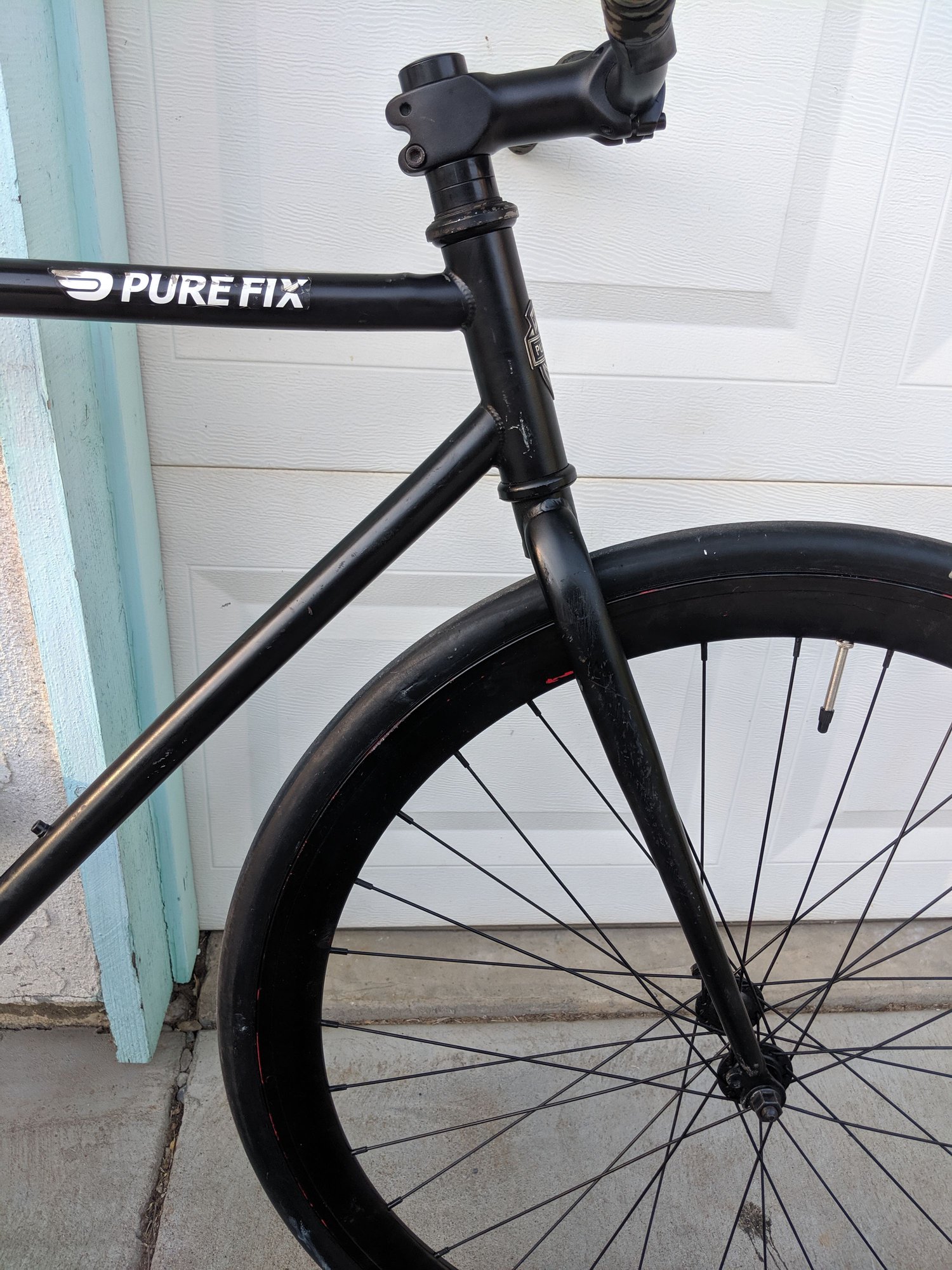

Originally Posted by mikefule View Post
that bike has run into something that wasn't moving.
+1
dabac is offline
Old 07-27-19, 05:59 AM
dabac
Join Date: Mar 2008
Posts: 7,957
Mentioned: 39 Post(s)
Quoted: 829 Post(s)
Liked 9 Times in 8 Posts
Originally Posted by seamuis View Post
That bike has absolutely been in a front end collision.
+1
...or possibly jumped off something high.
Thatíd be a very unusual damage to a jumped bike.
Bikes jumped beyond capacity tend to splay out, not compress. Only way I can see such a damage occurring from jumping is if someone would misjudge speed/distance and nosedive straight into the landing ramp. Or failing to clear a double.

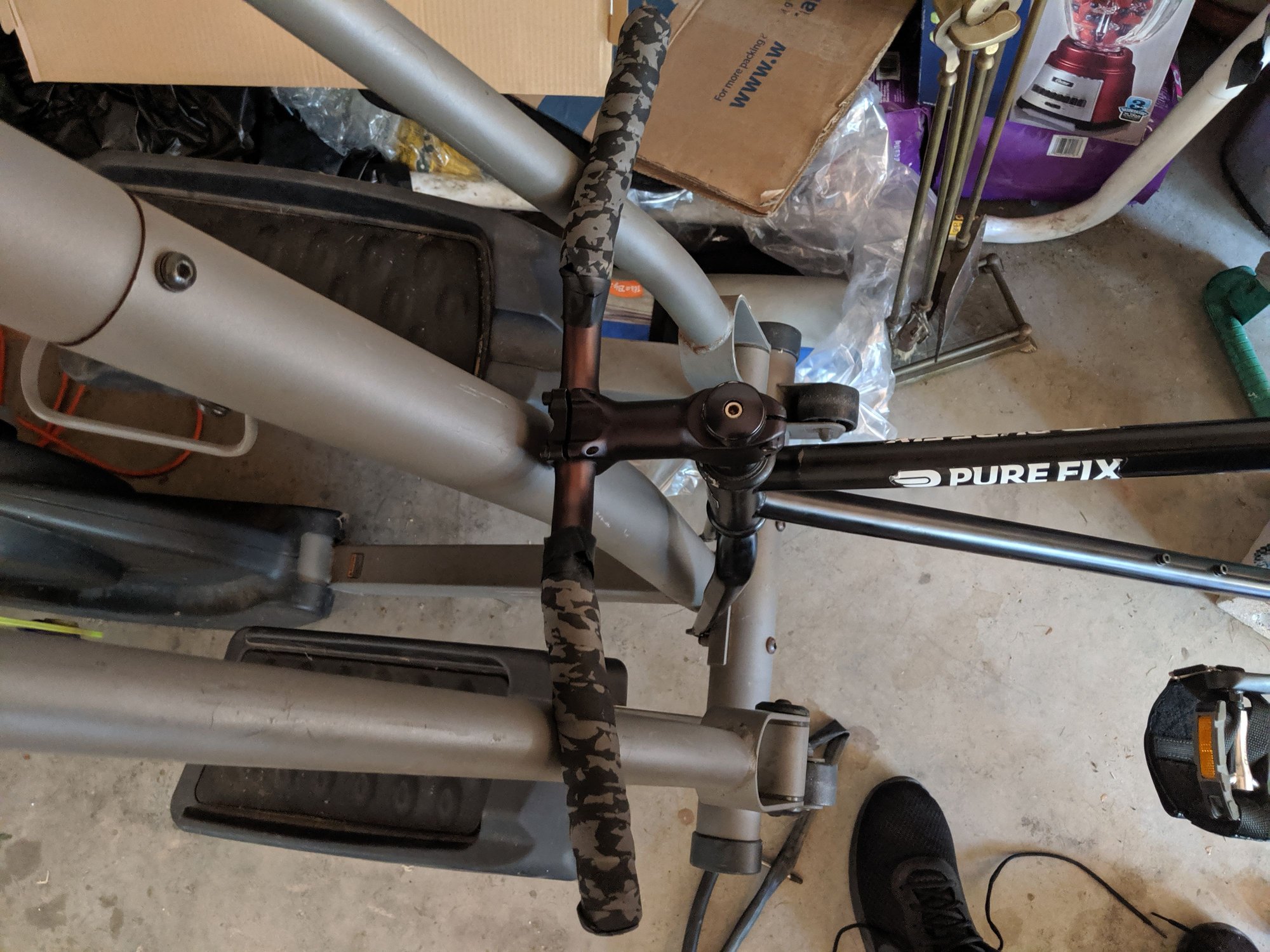

So being the way I am, this was bugging me to no end, so I had to do something. I read the epic 5 page thread from Kurt showing the results of the HTS-1, and I didn't like the results. I decided to not bother with straightening the frame and figured I'd focus on the forks, because my 'bike bro' gave me some really nice ($$$) pedal straps (for free) and I wanted to use them but didn't want to kill myself with the insane toe/pedal overlap I had going on originally.
I really wasn't planning on attempting this today, but as I sat in the garage after putting the straps on and realizing I wasn't going to be able to use the straps with the fork bent so aggressively, I started looking around the garage to see how I could engineer a fork straightener. That's when I noticed the elliptical. The fork ends fit perfectly in the little nook at the bottom. I made the upside-down V with the bike and elliptical, and then put all my weight on the top tube and started bouncing the bike downwards with my 220lbs of body weight. I wasn't making too much progress so I got a bit more aggressive with my down-stroke. On the last one, I knew I had probably given it a little too much mustard.
It's amazing how steel works. The bulges on the underside of both the top and bottom tubes are gone, however, there is now a rather large lump on the top tube and the frame is now bent upwards instead of downwards. I inspected for cracks and aside of the chipped paint, there are no discernible cracks. I checked the welds as well. I'll be removing the fork tomorrow to check for cracks there, but I think it will hold up with light riding until I trash it in a couple of months. I'm literally going to saw it in half so no one can try to salvage it or re-sell it because it's a "Pure Fix Yo".
I wanted to share because I know some people are interested in these experiments. I was surprised to tell you the truth. I really had no intention of bending the frame back (too far back in this case) and thought I was just bending the forks. Hi-ten frame is like spaghetti. My straps are worth more than the bike.
All that said, I really miss the aggressive stance of the initial crashed version of this bike. It was more fun to ride. It feels rather pedestrian now compared to how it was before. Gave me insight into the geometry I want when I decide to purchase something serious. Enjoy.
Parc HTS-2
Steel is real.
A bit too real...
Fork is stronger than this frame.
That clearance though.
raffivegas is offline

Wow. Looks like you've tested the welds on that bike and they've passed.

Looks like the steel stretched, and when you bent it back it didn't "unstretch", thus causing a bubble.
Hope it works out. If I was riding it, I would check the tubes often for cracks.

That clearance, and the overall geometry of the bike is now much closer to how it was built when it left the factory. Don't admire for a second how it rode when it was crunched up.
